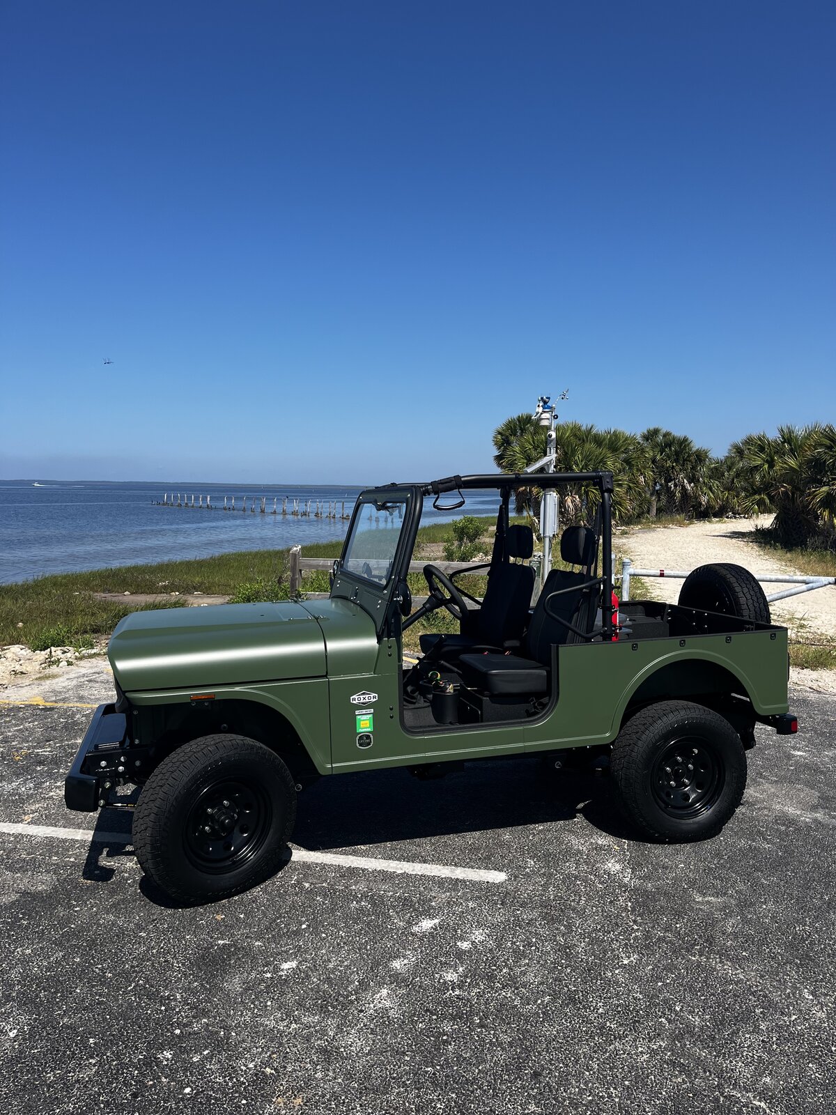

Hello Everyone! I bought my 2024 Roxor in November of last year. Since then I’ve put on the Dirt Warrior windshield, turn signals, a spare tire and a few other little things. I absolutely love it so far.
I’m planning on putting a set of 235/85/16 All terrain tires on in the near future. I’m hoping to be able to have a top speed of around 60 miles an hour with a slightly lower RPM’s than with current tires and the 5.38 gears.
Is there any update on the potential for a tune with the newer models yet? I know that the computer is more heavily encrypted than the old ones. I’m just hoping to be able to get some more power out of the engine at some point?

I run 32s on my 2023 with 5.38 gears and can get up to 55 mph at about 2500-2600 rpm. You probably wont get much more than that unless you switch to higher gears or bigger tires. As far as the tune goes, I've messaged Wade at Diesel Freak a few times over the last year and he says he's close.

Nice Roxor! What are the decals on the side under the Roxor badge?
