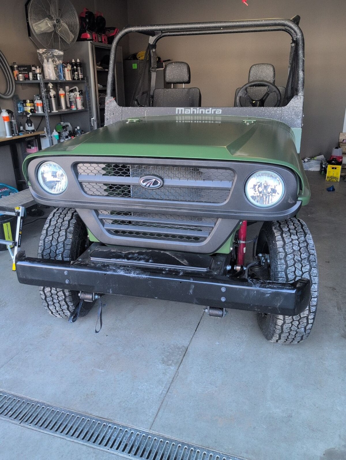

Finally got her home! This is Before she will fully washed and prepped for a Ceramic paint coating & Undercoating! My profession is polishing/ ceramic coating incase anyone asks and I'm happy to offer any help as well
I plan to drive it through lots of snow and sand so I want to make sure I get maximum protection here in Minnesota!
