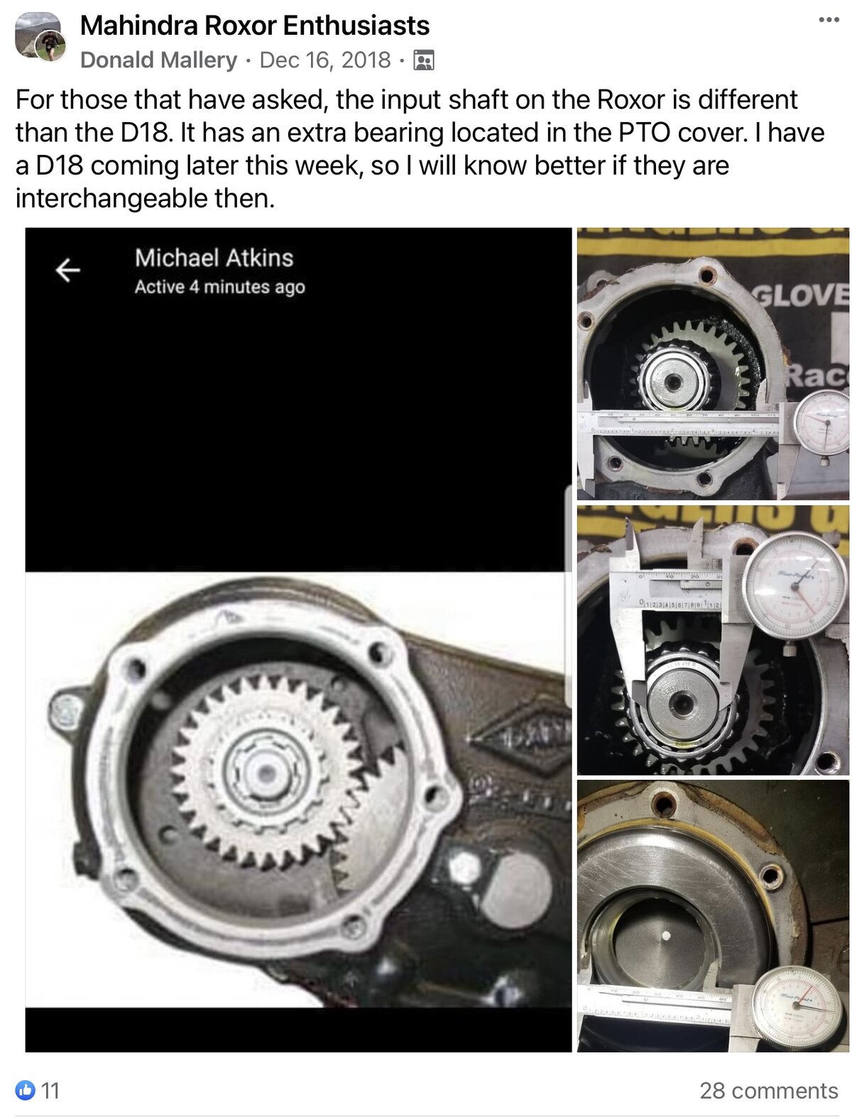

It does? That would be fabulous. Just to be sure we are talking about the same thing. Power Take-Off for implements?
1,308
Roxors do not have a pto or a way to add one. Unfortunately for those who wish to have one the cases are different in the way a bearing is retained thus making it impossible to modify with existing parts to add it.

Mahindra must not be proud of it because it is not in the Operator's or Repair manuals. I would love to be able to use an auger and a tiller off of a pto.

That sure looks like a PTO. I wonder if it is just spinning whenever the TCase is engaged? If so, maybe Mahindra has some plans for that if Stellantis gets off their backs???

1,308
There was talk from Mahindra about offering an option. But it was all talk and nothing ever came from it. Jesse at TorqueKing started working on a kit when Covid hit and I don’t think he ever revisited the possibility of making it. You will find nothing that is a bolt on to make it work. I did a search in the Facebook group to find this so I could show y’all. The t case is a close clone but it isn’t the same internally.
