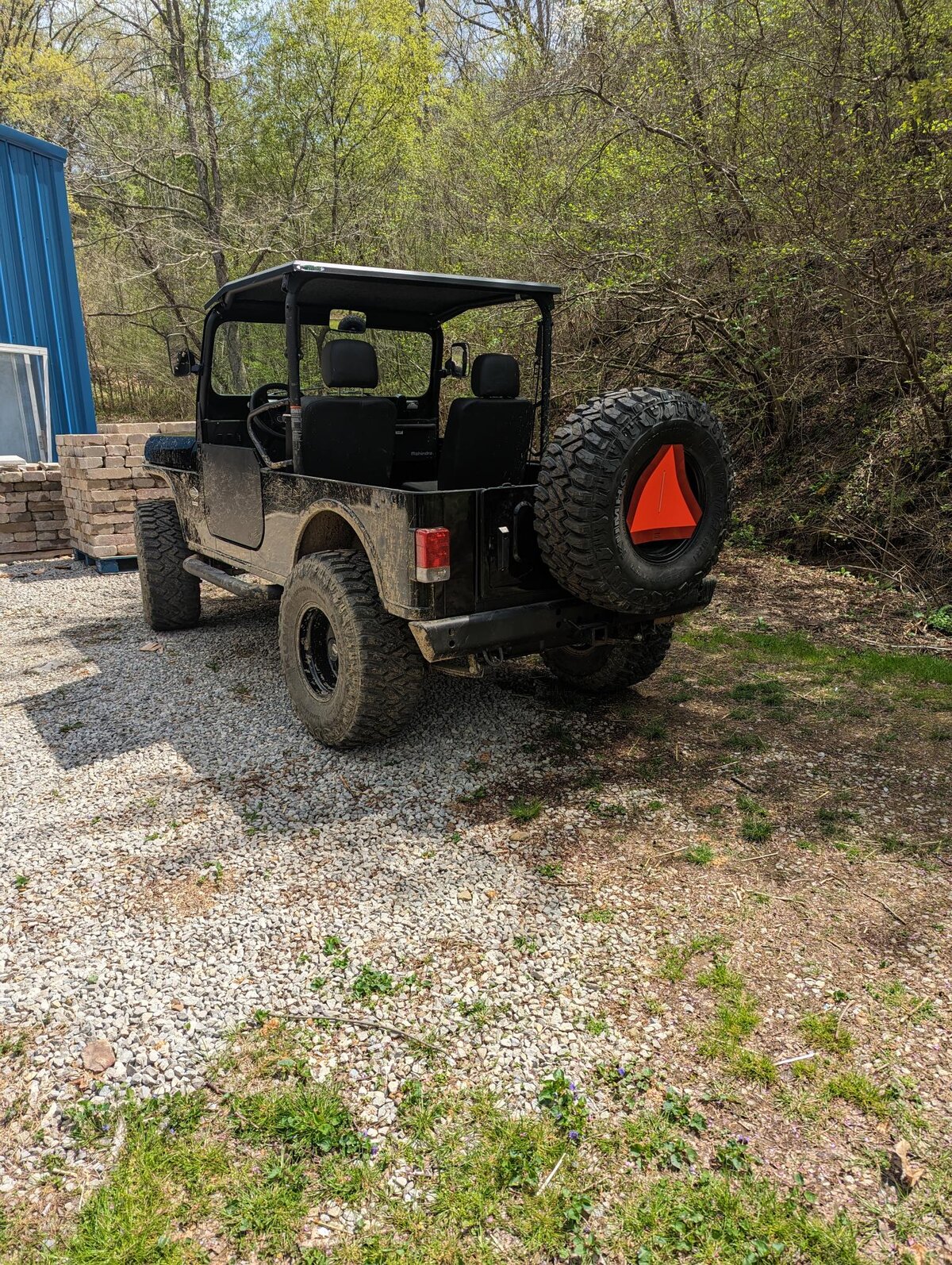

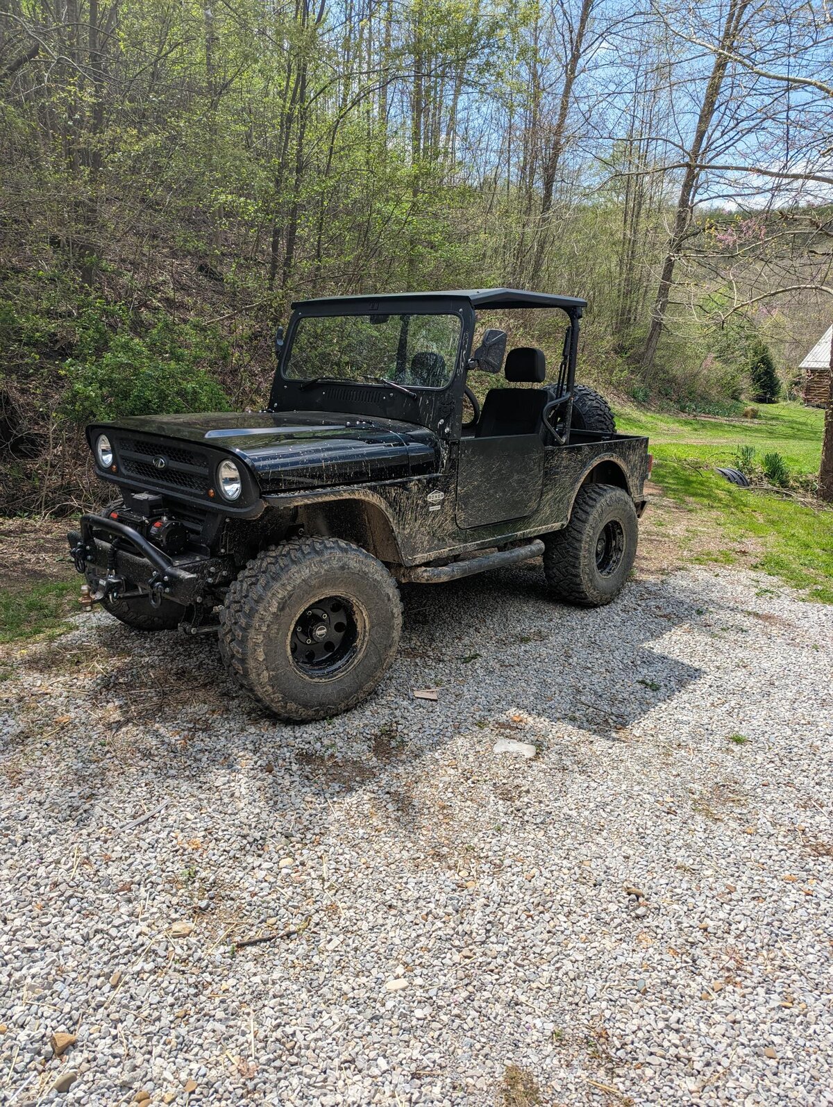

It's been a while since I've been on here. Been very busy! Anyways I thought I'd provide an update on what I've done:
  • Diesel Freak Stage 2 Tune (and waist-gate booster)
  • Intake connection kit
  • Hard Roof
  • DF windshield frame, CJ-5 glass, and wiper kit
  • XTC Turn signals
  • LED lighted license plate mount
  • Side-step bars
  • Front bumper
  • Rear bumper
  • 9500 lbs. wench
  • Spare tire mount
  • Half side doors
  • Mirror kit
  • XTC fuse panel
  • 33" Kumho Road Venture MT71 Tires
  • 15" American Racing AR172 Rims
  • 1.5" front shackle lift
  • Street legal in US
I have more stuff that I wanted to do this year, but that will probably be on hold for now as I've got other fish to fry for the time being.
Unfortunately I assumed that the break-in period for the Roxor was 500 miles like many other vehicles and I was wrong. Before I did my first oil change this weekend I was at 46 operating hours and 475 miles. The manual says the first oil change and fluid level check should be 10 operating hours or 300 miles. I hope I have not done any major damage because I have been pushing it hard a few times. the oil was very dark when I did the change. Again, this is all new to me. Frankly, it's the first time I've changed the oil in a vehicle. I do change the oil in my whole-house generator and riding lawn mower but it's not quite the same, and it's never come out as dark as it has in either of those compared to the Roxor. If anyone has advice on that I'd greatly appreciate it.
I've been reading here and there on the forums about over-heating issues and I wanted to get some guidance on that if possible. You can see what modifications I've made now. I don't intend to be pushing the Roxor very often above or close to 70 mph, but I do need to jump on high-ways now and then were I need to go at least 65 or get ran over. Without modifying my cooling any, am I at risk of overheating or causing any major issues in that regard? I can say with pedal-to-the-metal I'm topping out around 3400 - 3500 RPM in 5th gear. I can't say for certain but I think I'm hitting around 70mph or a little over. I've only done this about 3 times though. I think going about 60ish I'm in the mid 2000's RPM wise. I would like to do longer cruises in the 55-60MPH range. Can I maintain that speed for long without worrying about overheating issues with my build so far?
Lastly, I have already greased the zerks for the leafsprings (I think these are the only zerks?) because I was hearing some squeaking noises, which it didn't fix. All of the fluid levels under the hood all looked to be topped off still. Is there any other maintenance items I should consider like repacking the bearing, etc.?

There is a grease zerk on the rear axle , right beside the tire on each side. When it’s full, grease will come out a hole on top of the housing, right above where you’re putting in grease. It may take a lot, mine took almost 80 pumps per side to get grease out, I thought I was doing something wrong until I read on here several other people had the same problem. Then I was worried I ruined bearings or something; being that dry, but I’m over 25k miles and had it just under 5 years, and it’s still fine(knock on wood). I’ve found on mine, if I wrap a rag/paper towel around the leafspring fitting and grip it as I grease it, so it makes the whole thing take grease, it doesn’t squeak as much.
Thank you for that info, and the tip for the leafsprings!
