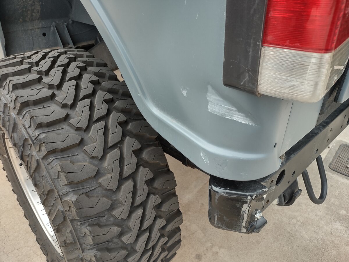

I got sideswiped while taking the Roxor to pick up my son from school on Friday. With my tires being wide and having wheel spacers the tires (and therefore suspension) took the brunt of the hit. The body damage is minor and doesn't really bother me as I expect rack up a few dings and dents along the way.

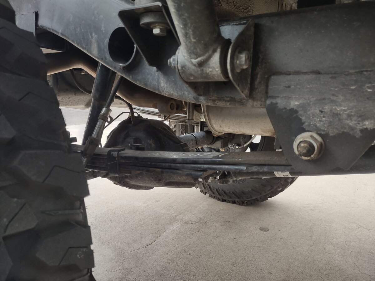

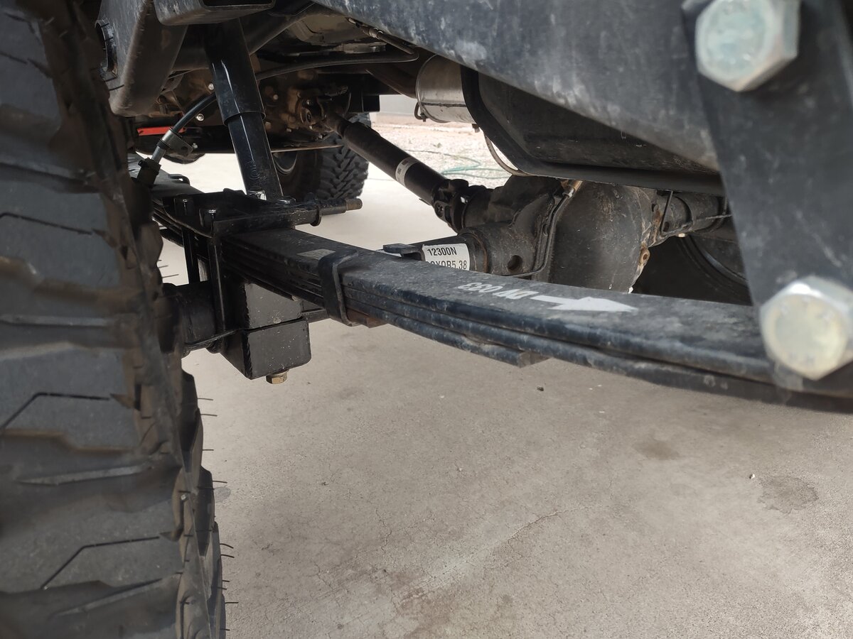

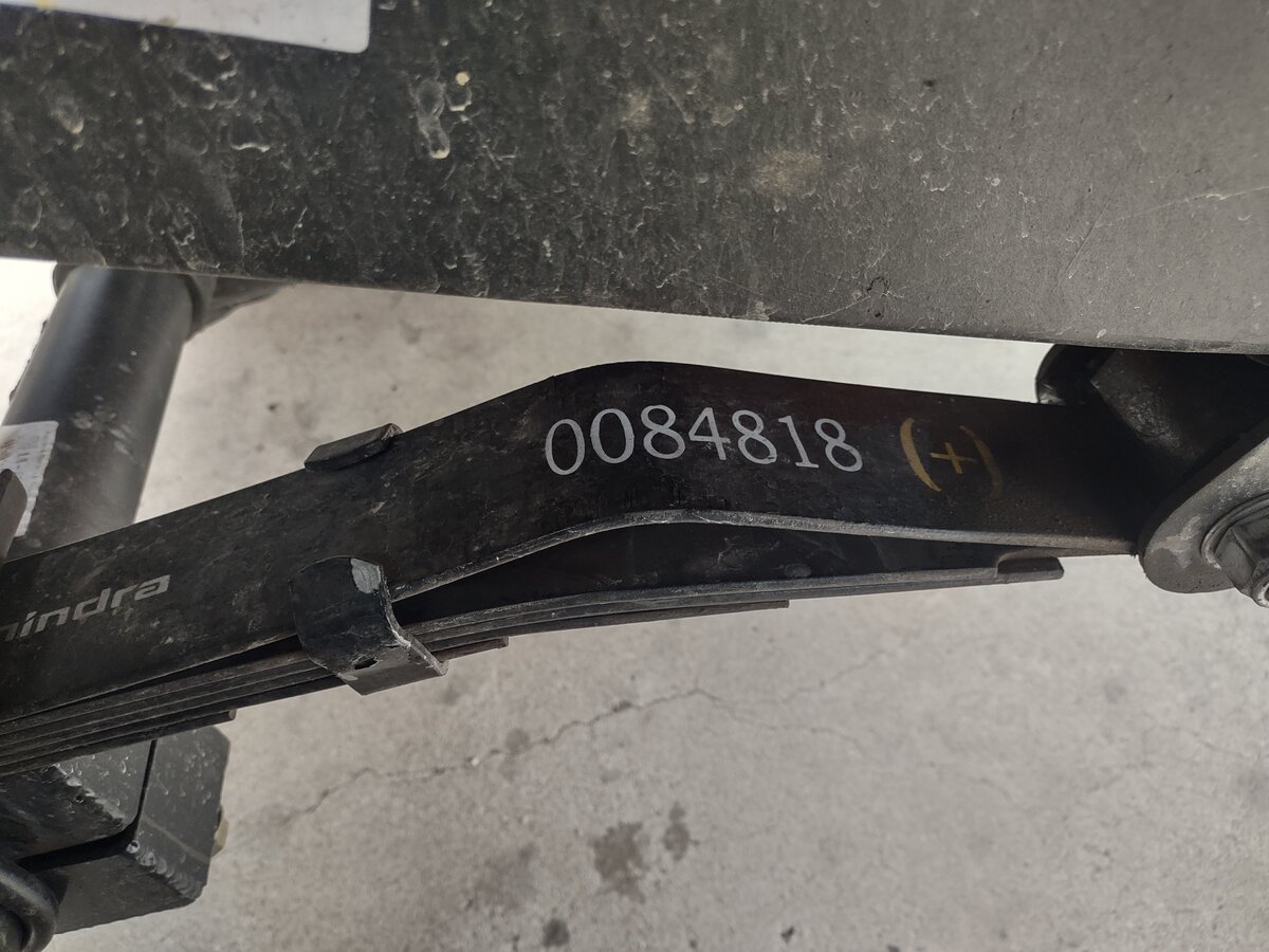

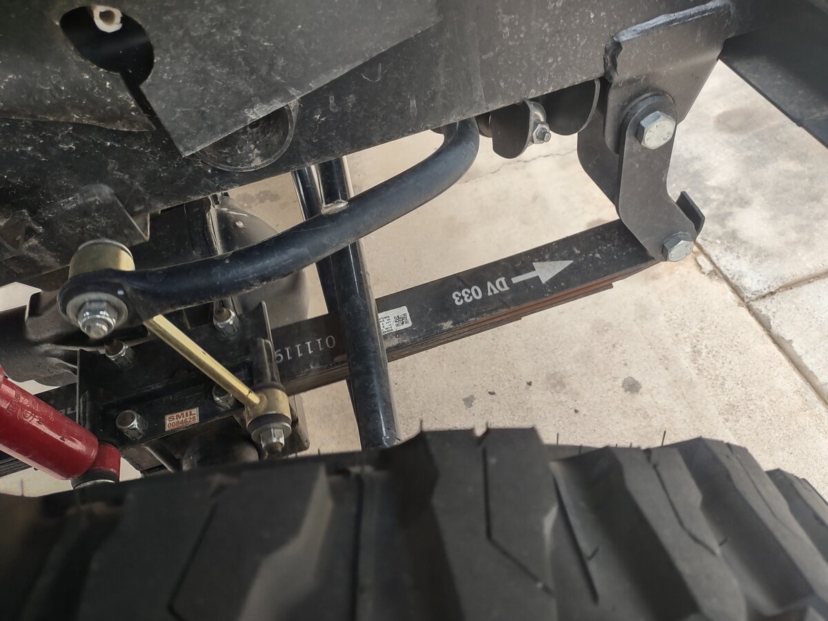

But the front leaf springs are obviously shot and the rear's look like they may have flattened a little too. Insurance inspector is supposed to be contacting me today or tomorrow, and after that I'll have a local dealer or shop look at it, but I'm kind of anxious to get parts sorted.
Anybody got OEM springs leftover from doing a lift? If not it looks like leadersrpmshop has the best price for new springs.
I'm worried about the shocks too. Anyone got any recommendations on stock size shock replacements? Bilstien? KYB? Also any other suggestions on anything else I should make sure gets inspected?
1,305
Alot of your problem was that spring over kit. They’re notorious for bending leafs Just too much leverage on them. Glad it’s a fairly easy fix for you. Good luck with the insurance getting things sorted out.

Yeah, the BMF lift was on there when I bought it. It's left a bit to be desired for sure. Long term I'd like to do the the climax off-road long travel/yj conversation kit but it's not in the cards right now. I need to bolt some things in and get it back in service.
I appreciate the insights on the leafs. For shocks I think I'll go ahead and order the KYBs. The price is good and reviews seem good too.
