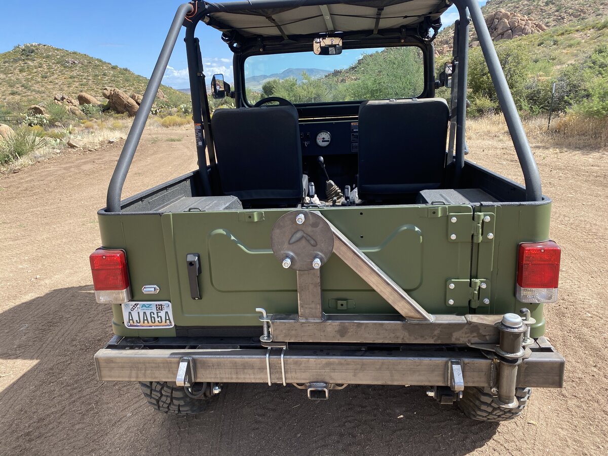

Cecco racing utility bumper. Ties into the frame. I pull my water trailer with mine.

I have the Cecco rear "farm" bumper with the tire carrier and it works well. The bumper does tie into the frame.

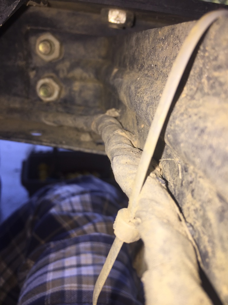

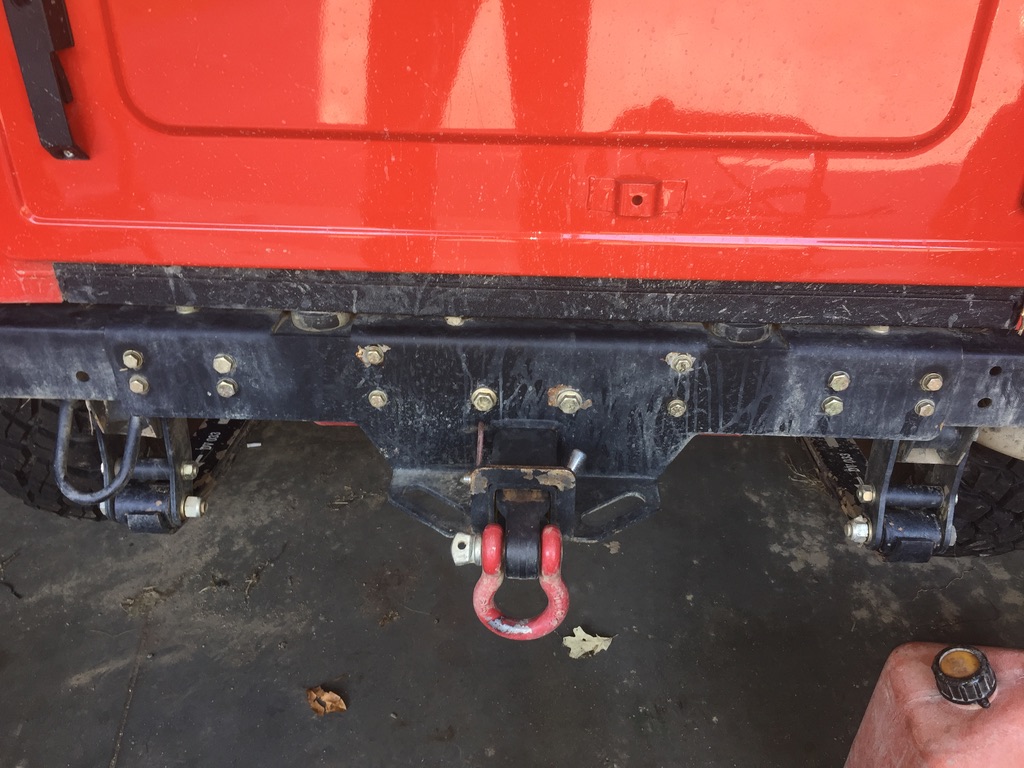

All the stuff from CECCO is well built. I have all three of his skids plates and can say they are a must off serious off road. And the fuel tank skid plate is really nice, raises the tank one inch. For a rear hitch, one that attaches to the frame will have the most strength, and yess CECCO makes two types. However money is always a factor. For a lower cost but high strength the "EMP 2 inch receiver hitch" gets the job done. I went this way until i can afford the CECCO tube hitch. With the EMP i have used it several times to tie the rear to a tree and pull other people out. One time i pulled out a full size Ford out of the mud. No bending or damage to the rear of my Roxor. However i did add four bolts, the second picture shows them from the back side of the stock bumper.
