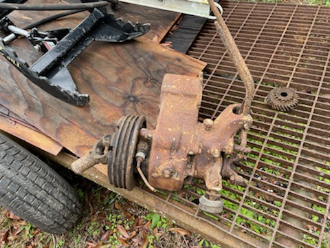

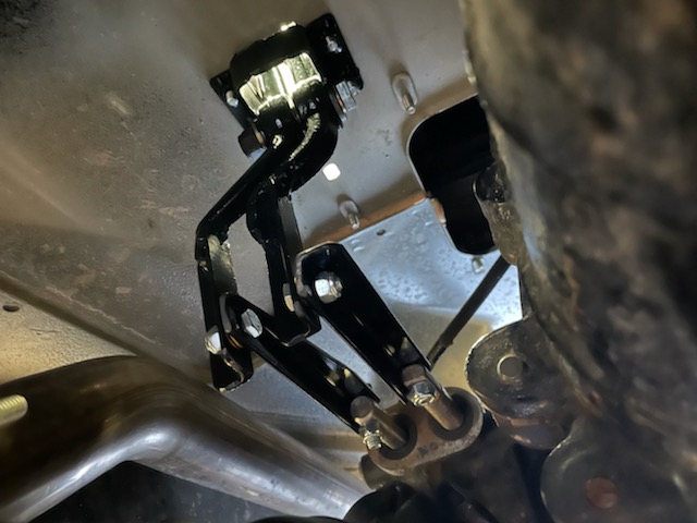

Step 1: Remove levers from old case. Had to soak the pin in Kroil and knock the crap out of it to get it out. Clean and remove rust.

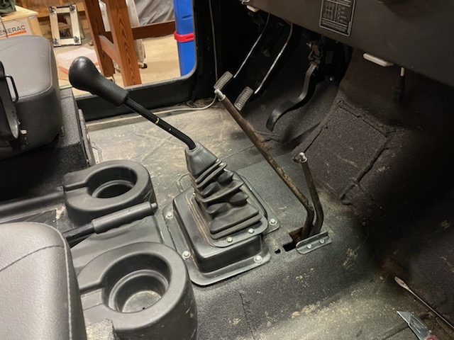

Step 2: Remove all linkages and pivot point from Roxor.

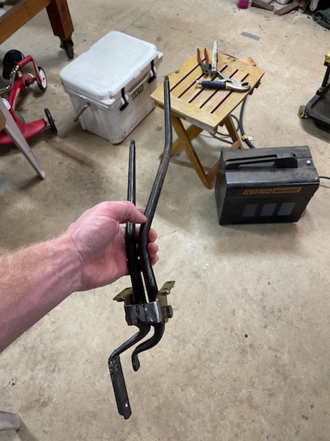

Step 3: Cut pivot point in half. Bolt levers using 2 bushings or washers. I them used screws to screw the pivot piece pieces down on a 2x4 so they would be straight. Now cut a piece of metal to fit the gap you created in the pivot piece and weld up.

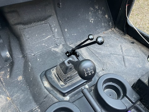

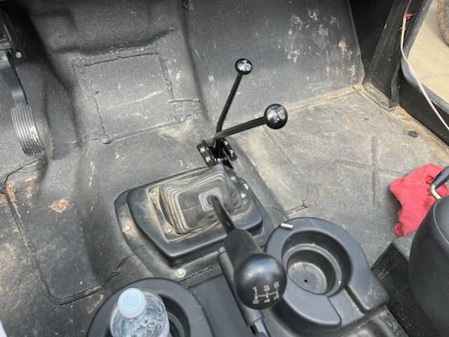

Step 4: Enlarge hole in body to allow for both levers. As you can see I cut a a couple pieces of angle to "brace" it on top. Drill new holes on drivers side of levers for left side of pivot point. Utilize factory right holes. This is the only permanent mod to the Roxor.
Step 5: Lengthening the levers. I did the Hi/Lo first. Make sure however you do it you ensure the rail is being pushed/pulled straight.
Step 6: Make linkages to rails. I used a small brass washer in between linkages and levers for the Hell of it. Just a few more pennies at TS.

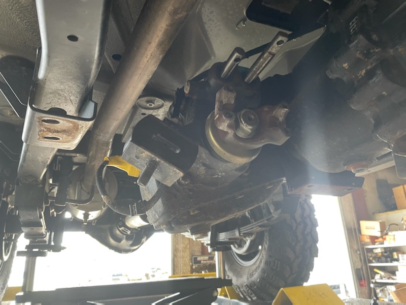

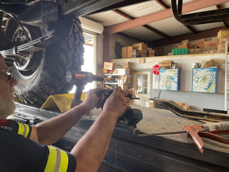

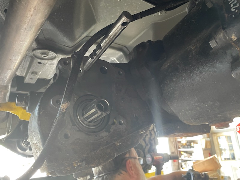

Step 7: Remove pill. Make sure the case is in 4Lo apparently. I did this a few days later. I bought a gasket kit but didn't need it. Gasket stayed on output housing. Just added some RTV to it before reinstalling. It's not necessary. You will have to put a stand under the trans. Remove oil. Remove the skid plate. The hardest part was removing the hex caps holding the shift rail springs/balls in. Had to get the passenger one started with a punch and 4lb after rounding it with a combo wrench and remove with vise grips. Tons of factory loc tite on them. Remove the bolts holding the housing and it comes right off. ENSURE THE CASE IS IN NEUTRAL! Reinstall everything except the pill and refill with gear oil.
Step 8: Enjoy! Pill is visible in last pic on beer holder.
