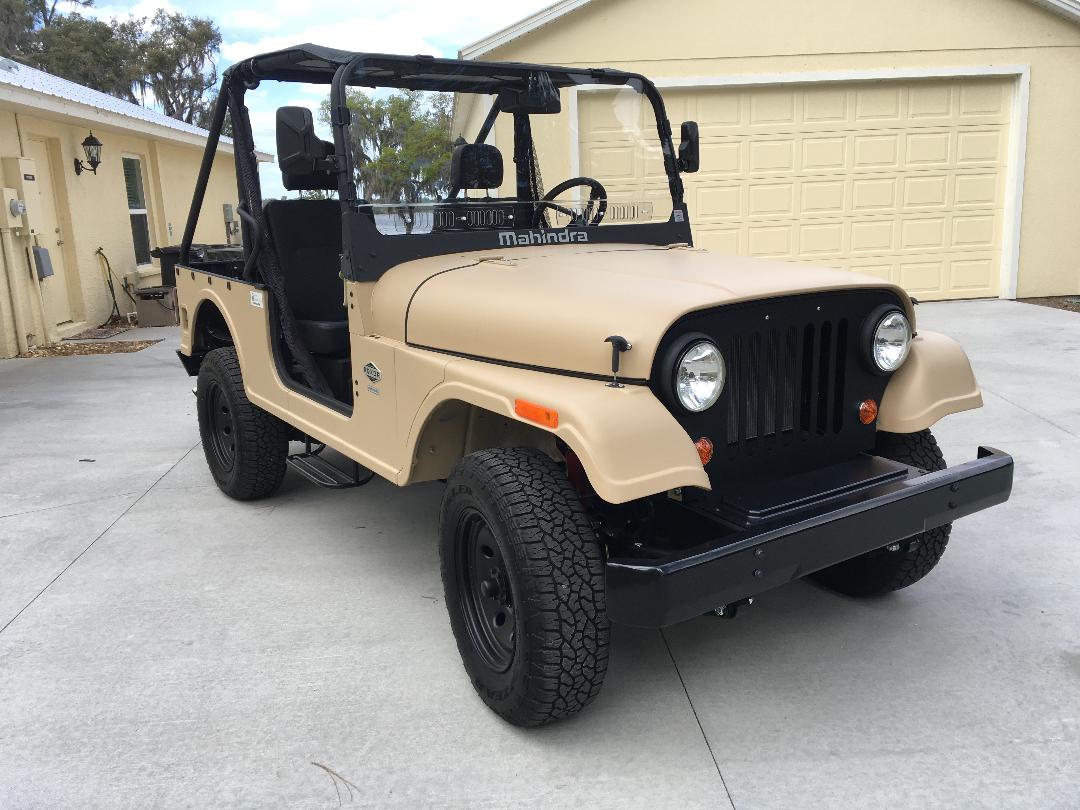

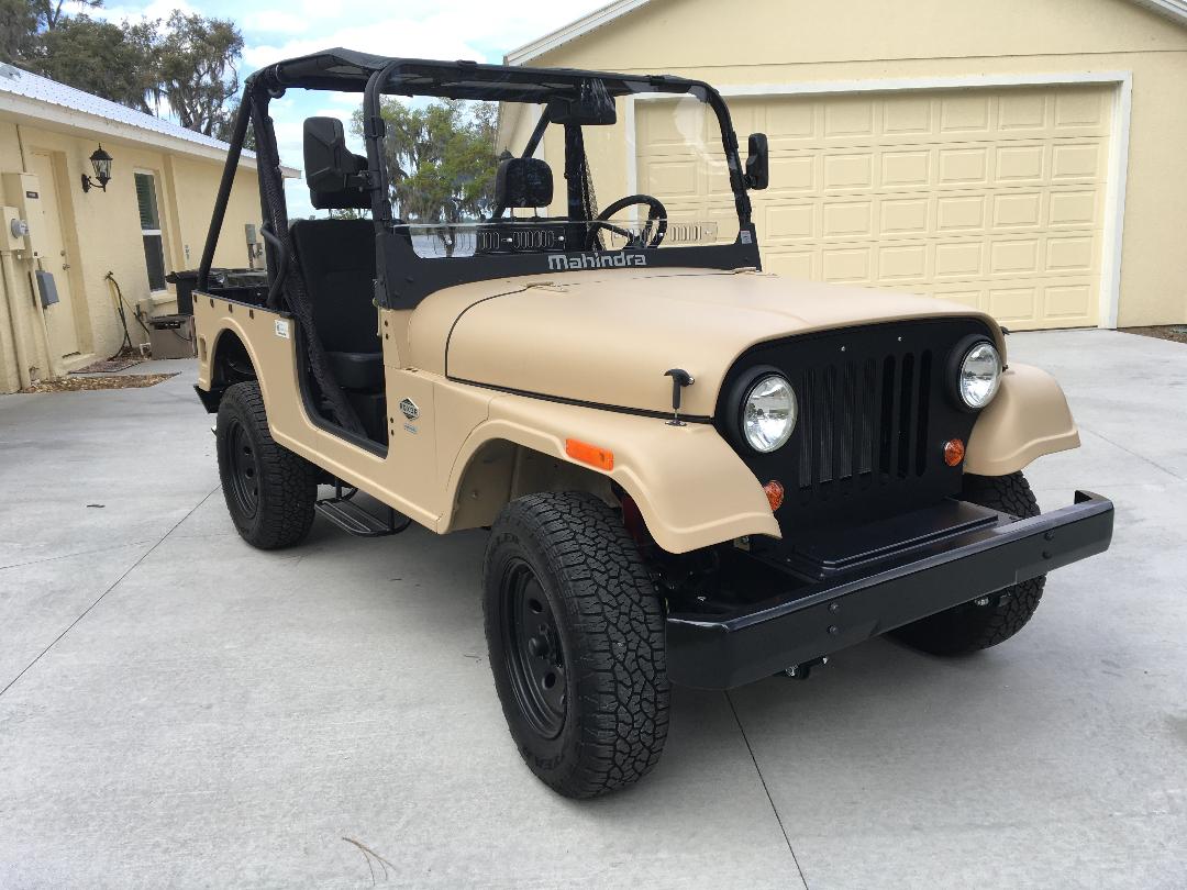

I've been through a Mule and two Rangers and they are a far cry from the all steel Roxor with boxed frame and automotive components - no comparison.
But bear in mind that my use is strictly as a utility vehicle on my property moving trailers or launching boats from my sandy lake beach, and short jaunts within a few miles of my house. For me peed is not an issue and rock climbing or mud bogs are something to avoid. Most of the time it's me and my Rottweiler and the biggest hill to climb is whatever the gophers made overnight.
I had a CJ2A completely restored that suited me just fine, but in a moment of madness I let it go. I guess it's true that everything is for sale at a price :).
Anyway, besides being a little bigger than I would prefer (the CJ2A was just right), the stock Roxor is perfect - heck luxurious. And if in time it turns out that I can make it street legal, so much the better; I've already added the required accessories signals, windshield etc.

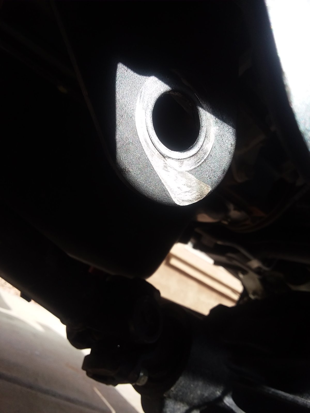

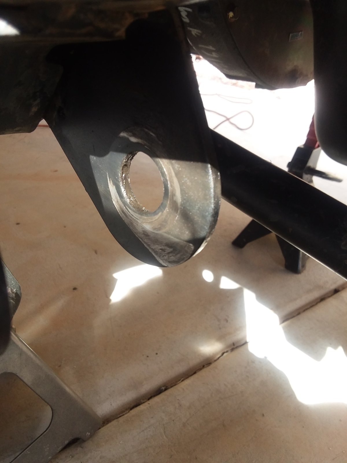

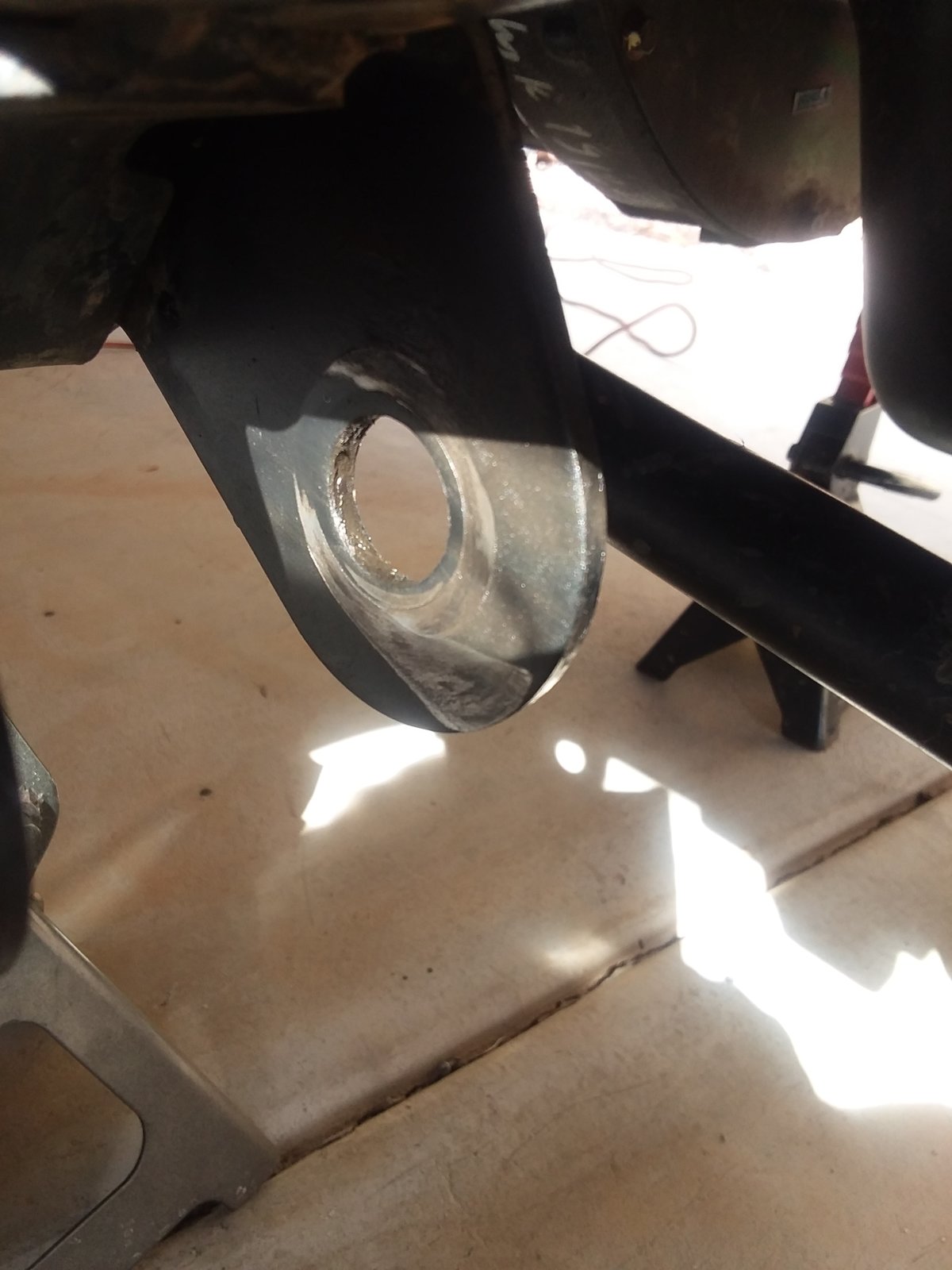

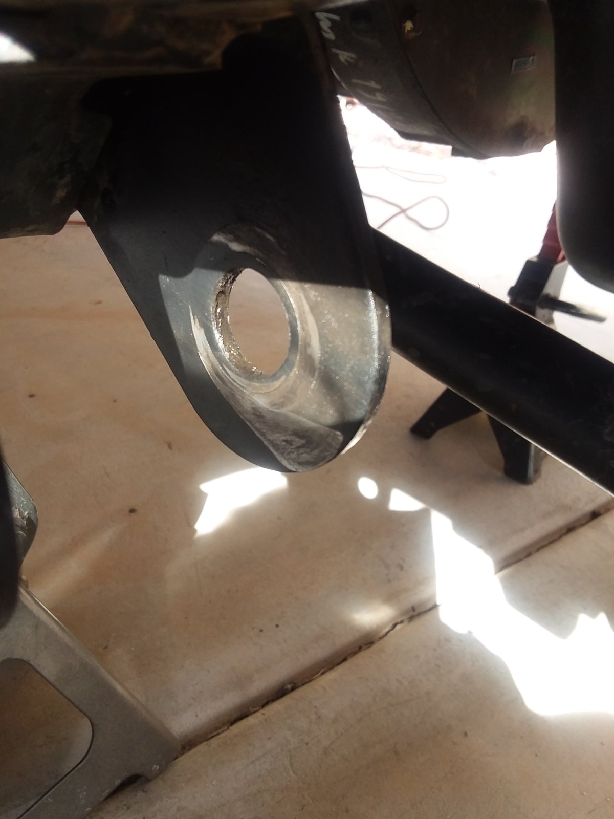

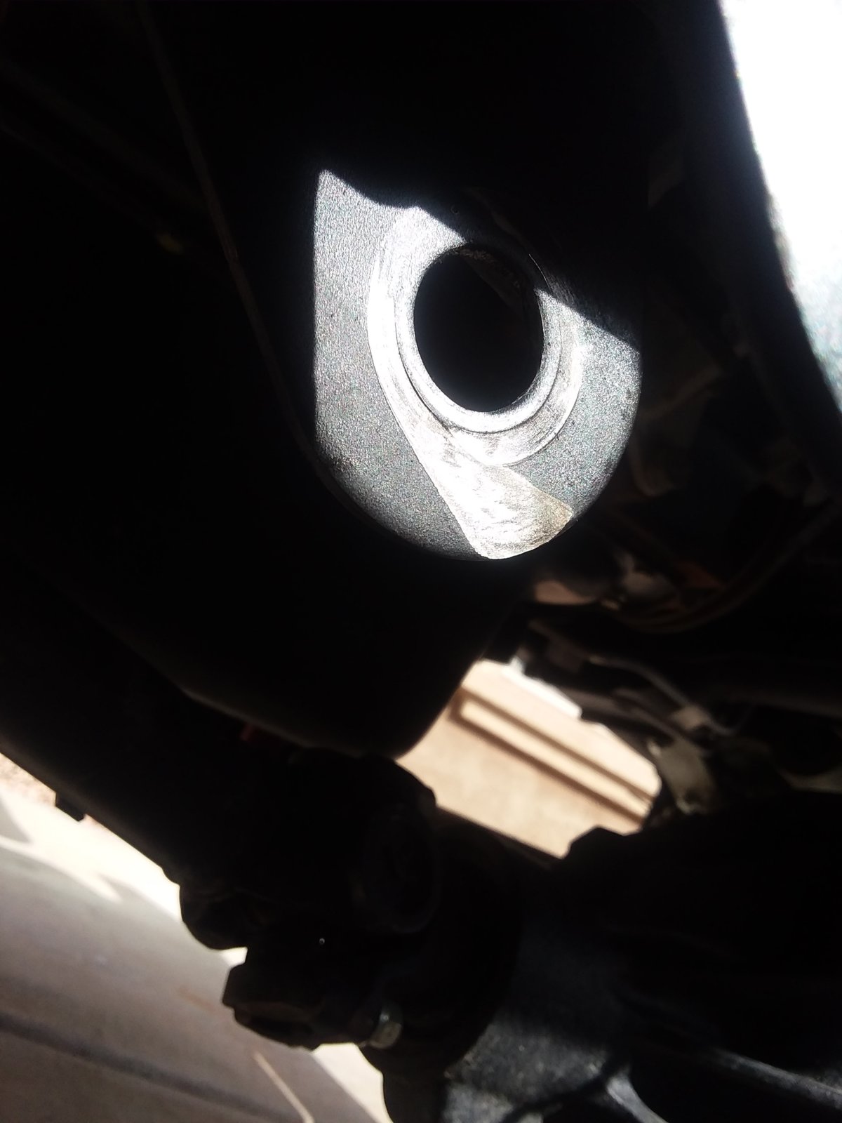

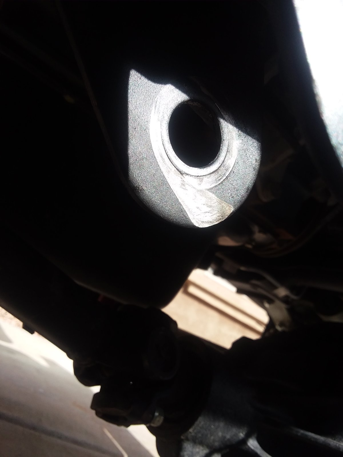

Just thought I would check back in with you guys, we are putting on a Rough Country front end lift kit on and this is what we found, The rear spring hanger bracket has major wear on one side' this is the pass side. The pictures don't show how bad it is, this is a scary thought if that bracket broke off. This is only after a few hundred miles of off roading. Not what you would expect from any UTV, I was told by the guys over at Sherwood tractor they have seen these brackets bending and I can see why now. I am sure in time it will wear on the Rough Country bracket as well. As I said these things are not up to moderate off roading, and to excuse it dose not fix it. I understand most of you will not off road to the level I do but this is B.S .I have owned several 4 wheel drive suv's, Xterra offroad package, 2001 Ford Explore Sport and drove them harder off road then I could ever drive the Roxor since it will beat the crap out of you. I question if I should sale the dam thing, without a major rework of the frontend this thing will be a problem if you enjoy moderate off roading, If I were most of guys I would check this bracket every so often. Just a note I don't jump this thing, I use it in rocky areas that work the susupension and certainly don't drive it fast since it rides so rough. I would welcome anyone to follow me around and see for yourself that I am not abusing it, for the most part I think they are built well, but?
View attachment 6063 View attachment 6064
That is disturbing...I'll have to keep an eye on mine.

Ned bacon did the norra and came out unscathed in a stock stock roxor, atleast mechanically. His shackles wore out and that's it. I believe he did another rally after that without any further issues. Wen they say keep pumping grease into leaves often, they ain't kidding. Do it.

I posted about this last week on my build thread. Leafs haven’t evolved much over the years but on thing that has is how they mount.

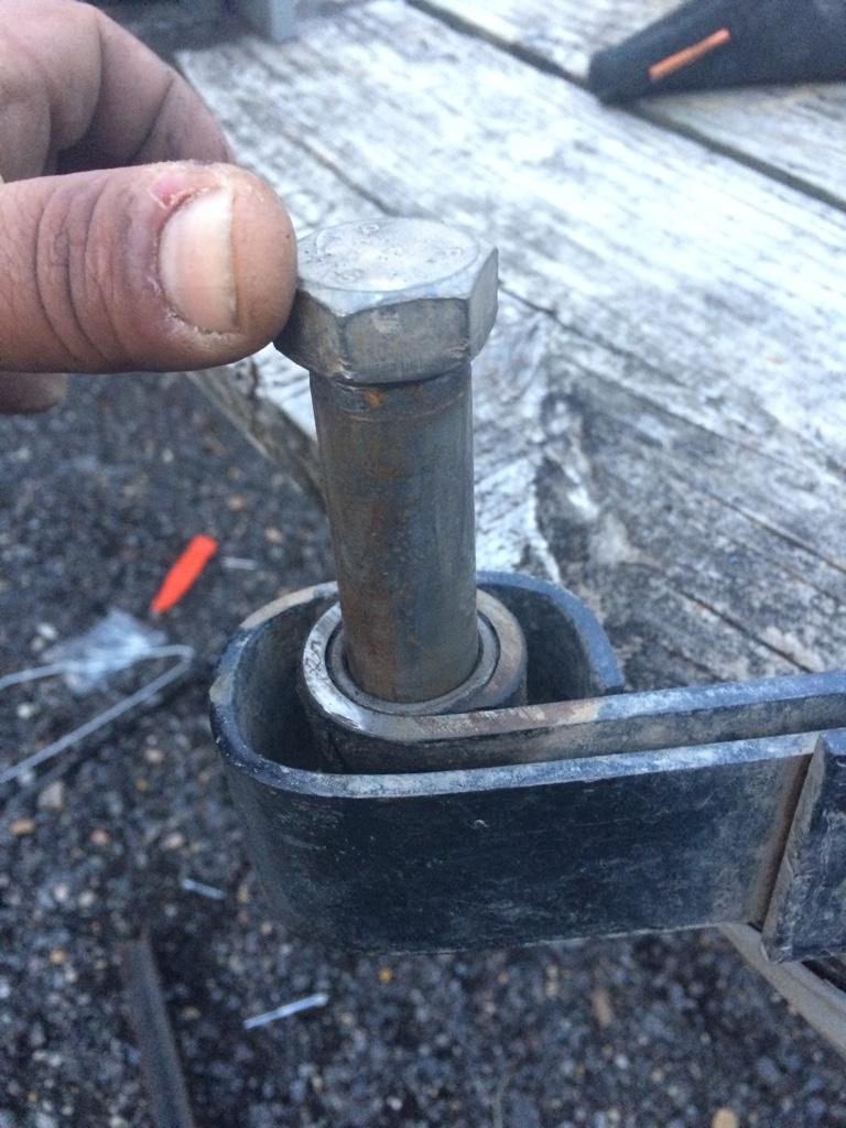

The Roxor uses the big 7/8 to 5/8 shouldered bolt. You pinching the nut up against the shoulder and hanger and creating a bar for the spring to pivot on.
Old Willys used this same method. No poly bushing just a spring width steel or bronze sleeve pressed into the spring eye.

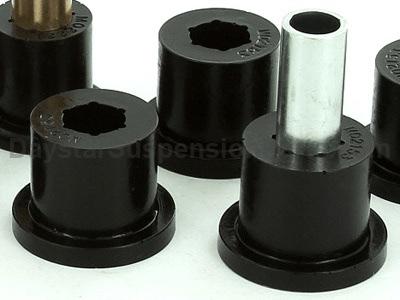

Newer leafs use a poly or rubber bushing with a shoulder and a sleeve. When you tighten the hanger bolt the sleeve is being pinched and the bushing rides on that sleeve. The bushing shoulders keeping the spring center , giving the spring a wider range of motion and a smoother ride.
There is not much you can do about this on the roxor. The hanger is not wide enough to fit a modern 2.5 spring with a bushing. I am removing the hangers and welding in a 3 inch wide hanger for the YJ springs. But my use is a bit harder then most.
___________________________________________________
The other problem is the shackle side. There is a rubber bushing to allow some flex but the sleeve is bonded to the rubber not allowing it to rotate as the suspension compresses. This will eat away at the shackle with hard use. Once again, leafs with a newer style bushing, the sleeve rotates inside the poly bushing eliminating this. It’s best to put 5/8 grade 8 washers inside the shackles so the ware item is a cheap washer not the shackle.
These are all reasons why I decided to come up with a YJ conversion kit. Better ride. More travel. And increased life of parts. It fixes all of the problems. Jeeps have evolved, the Roxor is modeled after a Jeep with suspension that is now obsolete.
Keep them greased. A lot of grease.
