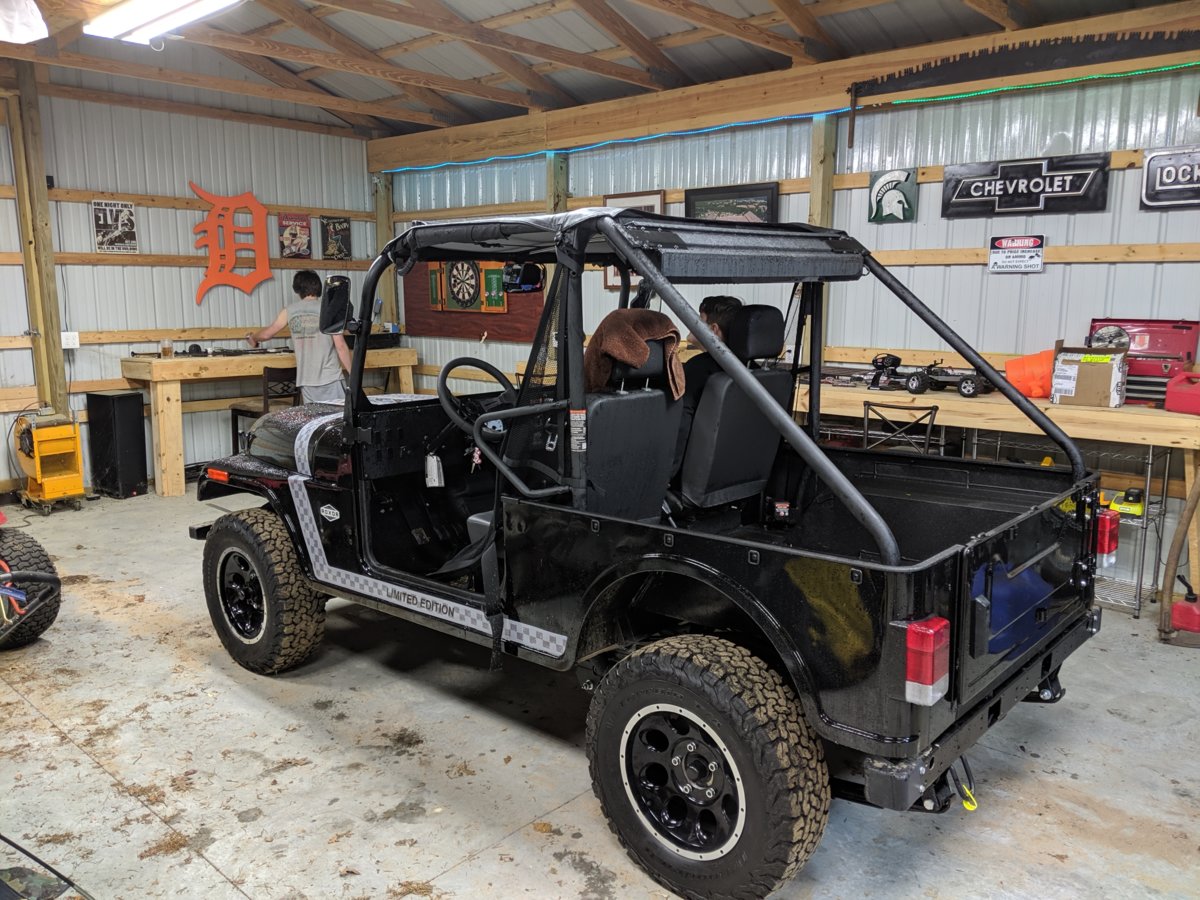

Hi everyone,
After reading this thread, I called my dealer (Before I took delivery) and I was told that "the sound bar bulletin was addressed already". My Roxor was delivered and sure enough, the sound bar is mounted on the diagonal part of the roll cage. Unless I'm misunderstanding something, this is the soundbar that was recalled, correct and there was not a fix issued, it's just being refunded?

When I got my Roxor back in January, the dealership had already took the soundbar off. They just took the price of the soundbar off the vehicle.
