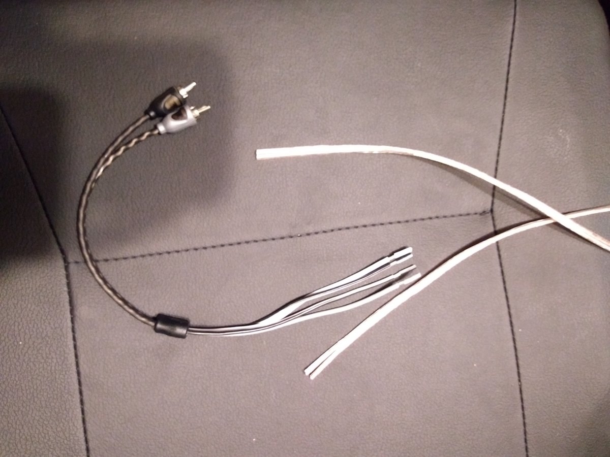

Every car subwoofer amplifier I've owned comes with both RCA as well as line-level inputs, which can accept the full voltage of those 3-inch speakers, just tap those wires to get your sub amp signal from the main speakers.
Or better yet, scrap that OEM soundbar and start over with a more reliable and better sounding system.

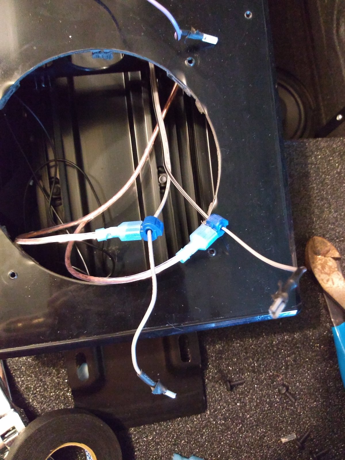

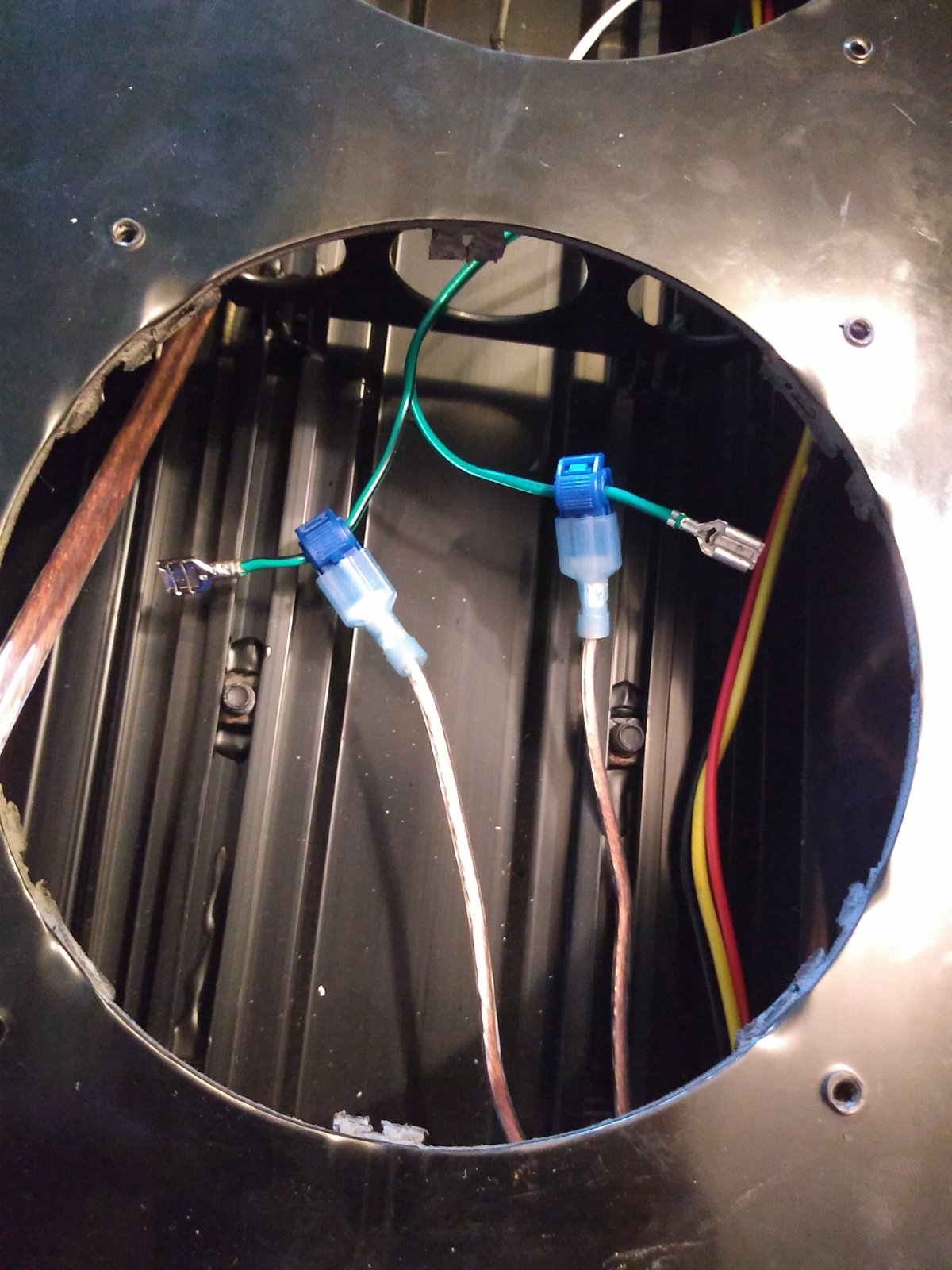

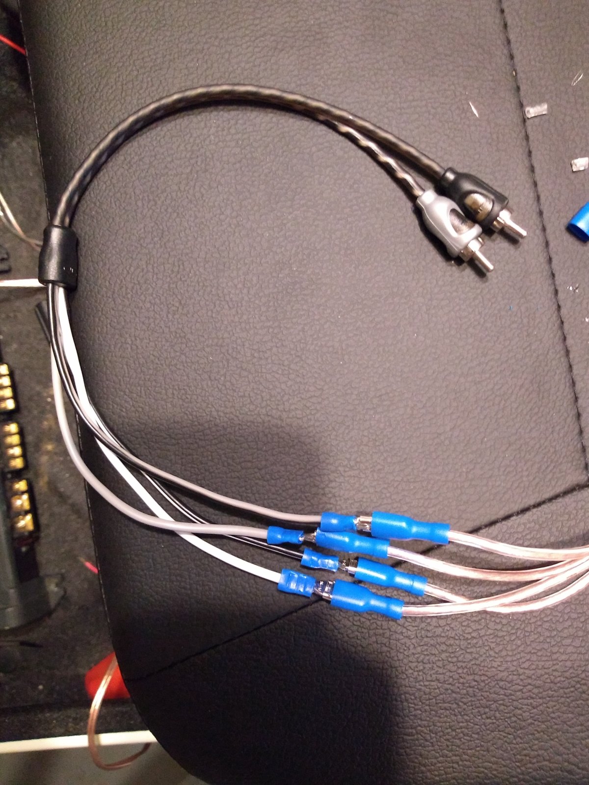

So I took your advise, my amplifier does not have wire line in, but their are these things called speaker wire to RCA adapters. I used T-taps to piggy back from the MTX speaker lines and now run a wire to RCA to my amplifier. The signal is very strong and loud to the amplifier, I had to lower my amp to the lowest possible setting. I think the signal is strong because its already amplified from the soundbar.
