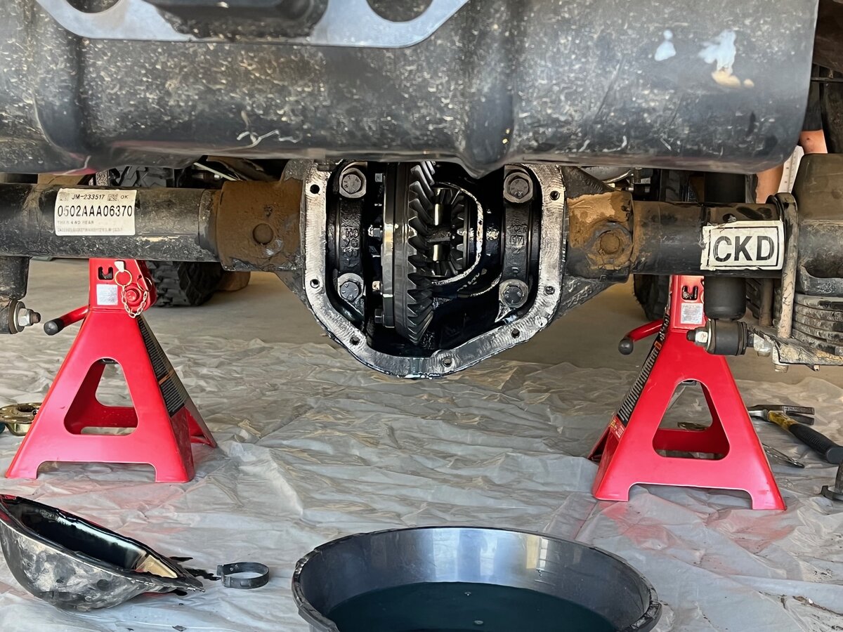

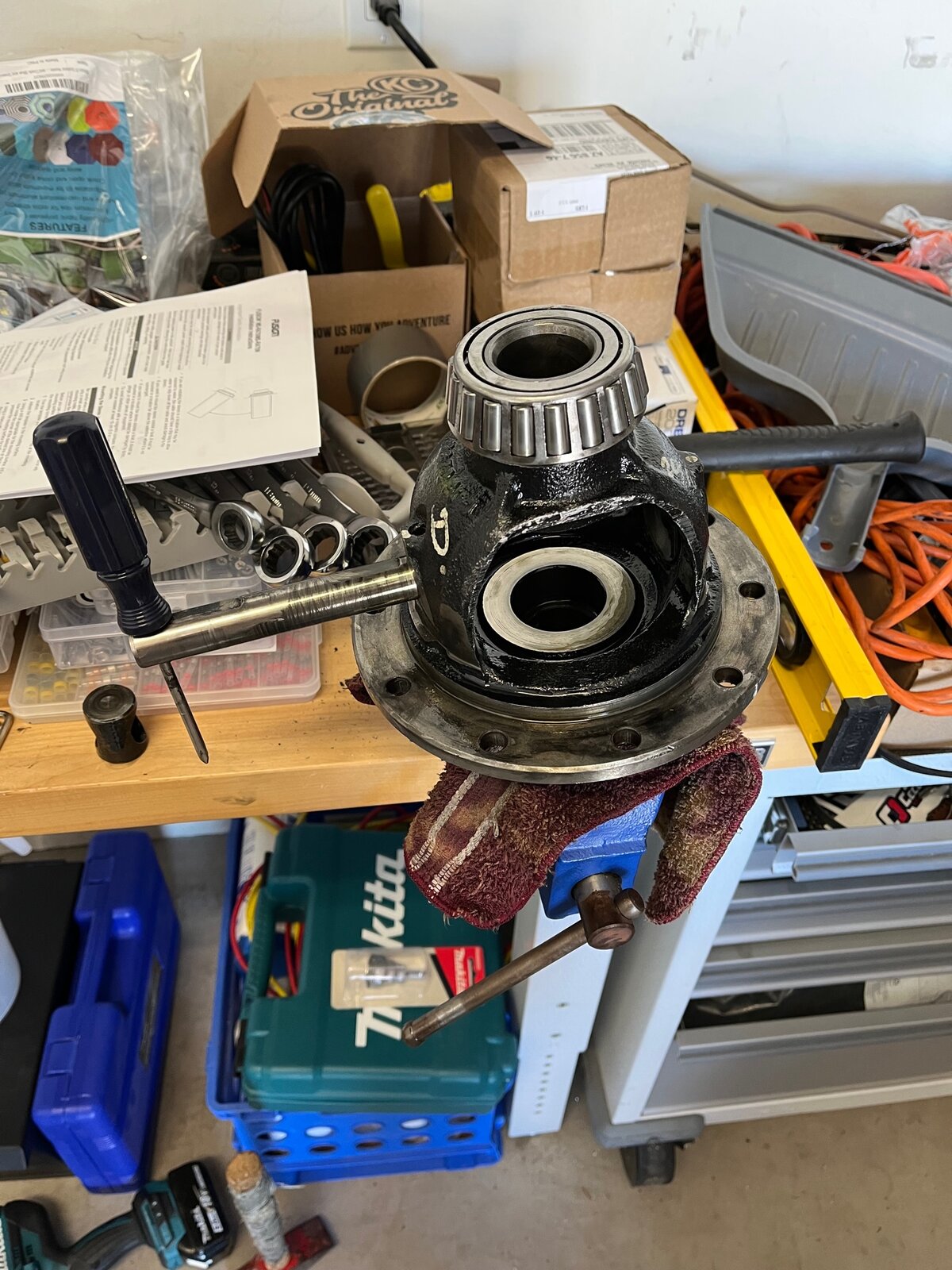

4028
Installed a TORQ locker (from Torq Masters) in the rear. Just followed the instructions and only ran into one small problem. Called the company and the women who owns it actually answered the phone and helped me through it. Fantastic customer service and I would highly recommend the product. If you research here and elsewhere you will find plenty of posts where people say they are noisy. Can’t speak to the Spartans, but i never hear anything out of mine in the rear. The product is made in the US and has a little better warranty I think than the Spartan. Hope that helps.
