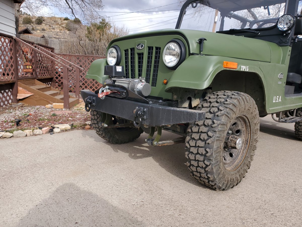

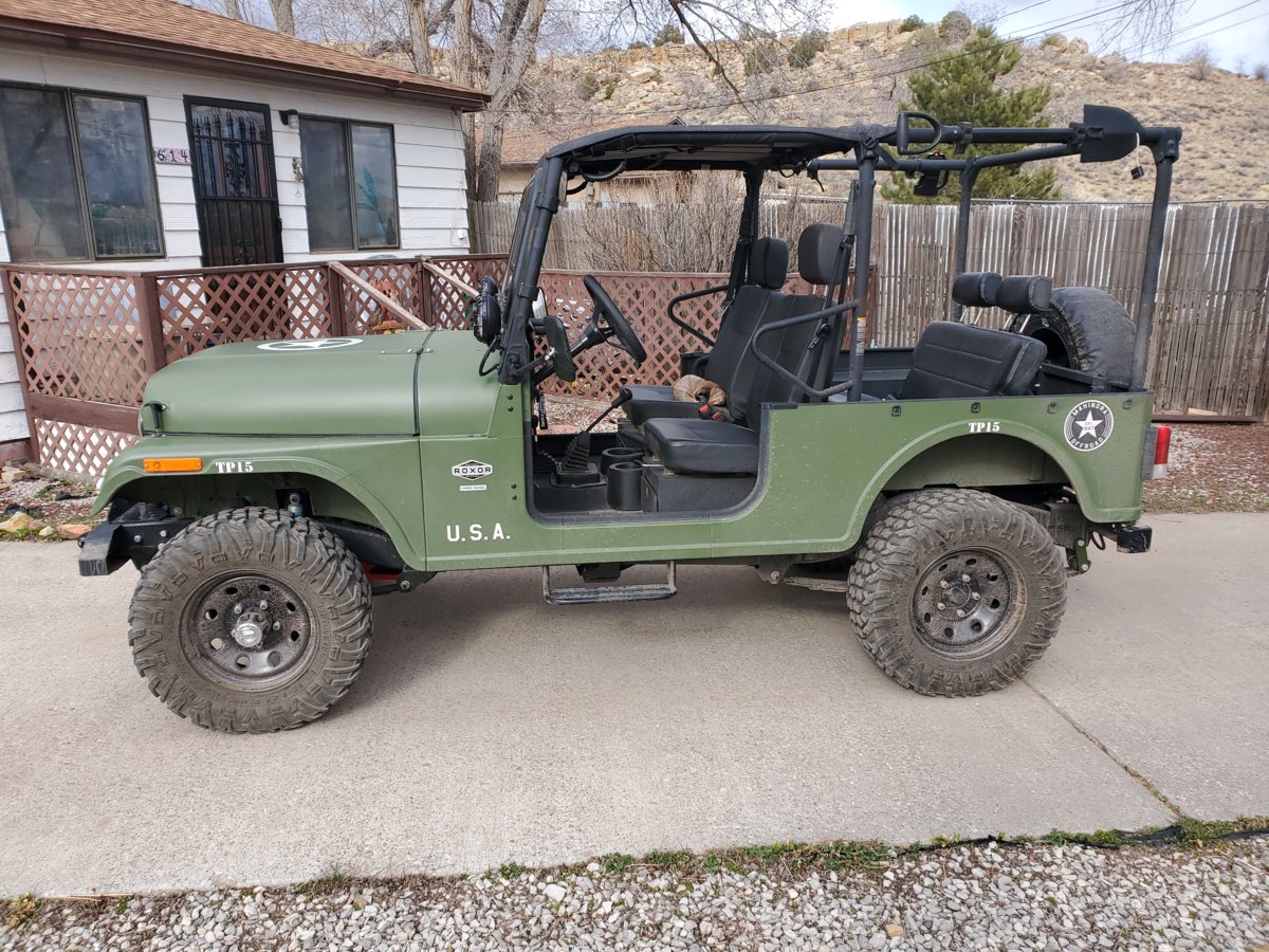

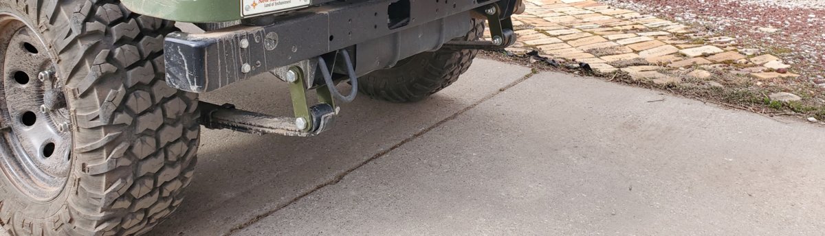

Finally got around to putting the shackles on that I ordered from you...a simple, inexpensive, awesome upgrade!

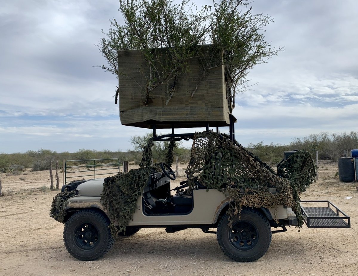

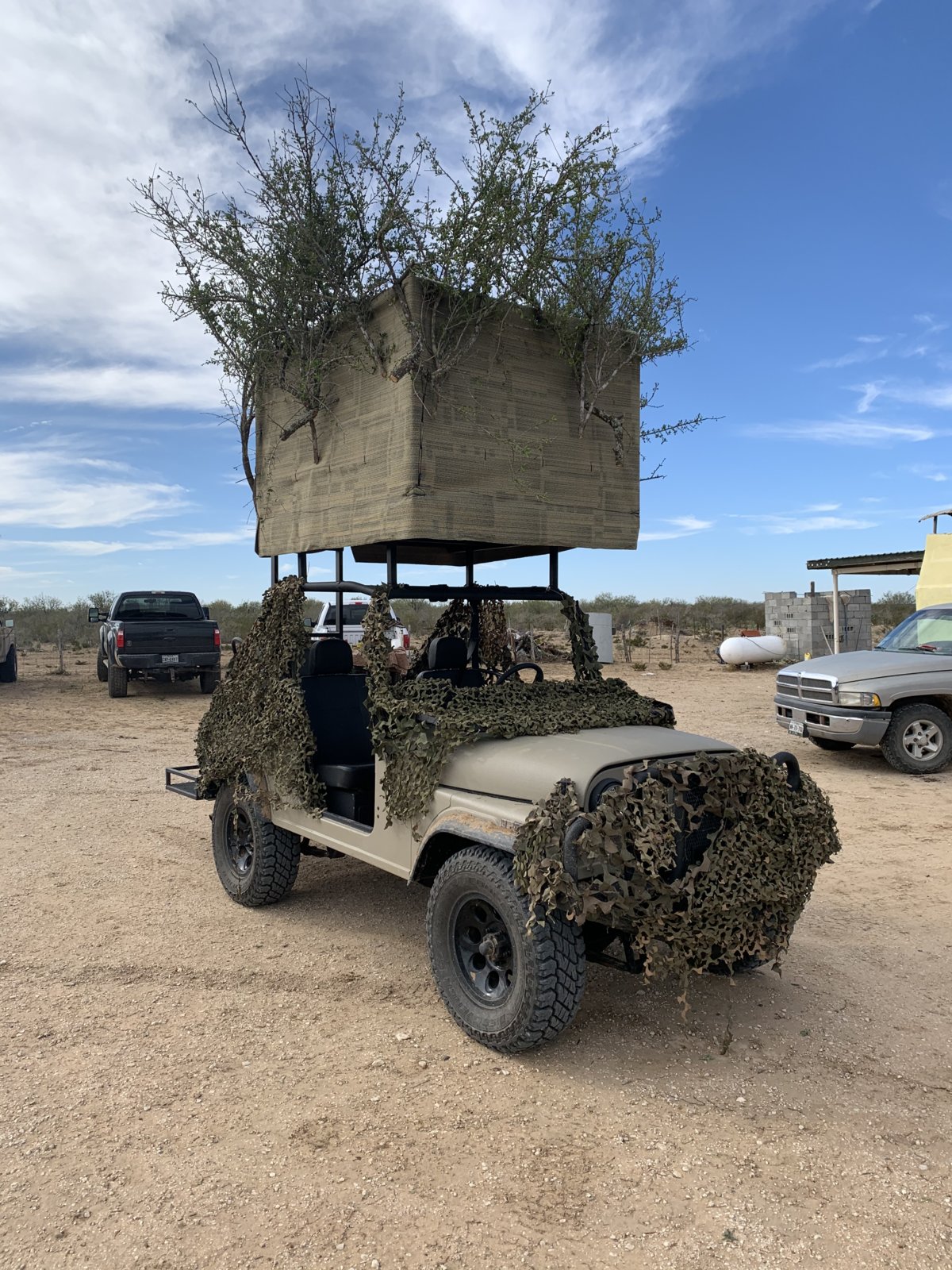

Max A. I need some help! I have 1.5 inch shackle lift on the front. You can see in the pic I have a ton of weight center to front. Front leaves are almost parallel.
Ride is smooth, but of course it doesn’t take a lot to bottom it out. What do you suggest to fix the front without raising it high and picking up a rough ride?? Back has no shackle lift and does bottom out when fully loaded.
I like your thoughts on keeping the front lower no matter what you do. I can tell you maintaining that ratio Is a huge plus in maintaining control and no roll over with my high rack.
What do you suggest?

[mention]JDM [/mention] I’d do an add a leaf up front.
