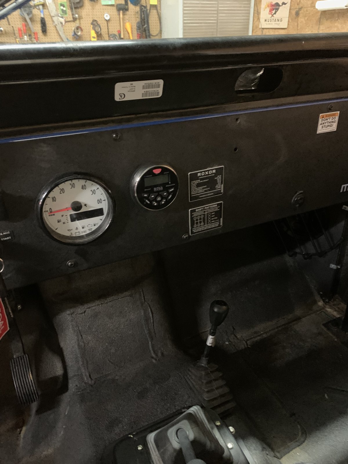

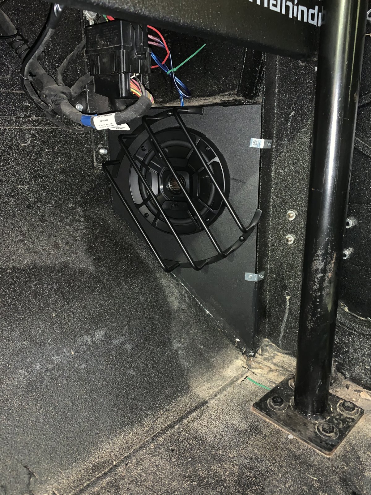

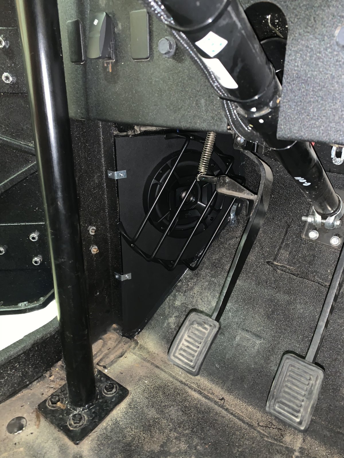

Finished up installing marine speakers in the kick panel area. Install and design were fairly straight forward just took time. The speaker panel is made out of 1/2" HDPE plastic. I created a cardboard template for both sides to get my fitment and angles just right. The only other piece of HDPE installed is on top of the "box" to close it in. On the inside of the box I installed a Dynamat knockoff to help with the sound quality. Still need to finish caulking everything but should be a fairly water resistant setup as long as they are not completely submerged.
Speakers are Polk marine DB652's 6.5" paired to a Boss MGR350B receiver. This combo works great without an amplifier. Also installed a 4 bar speaker guard to help avoid the speakers from getting kicked. Unfortunately I couldn't find a guard that fit the speakers exactly, but none the less they are protected.
