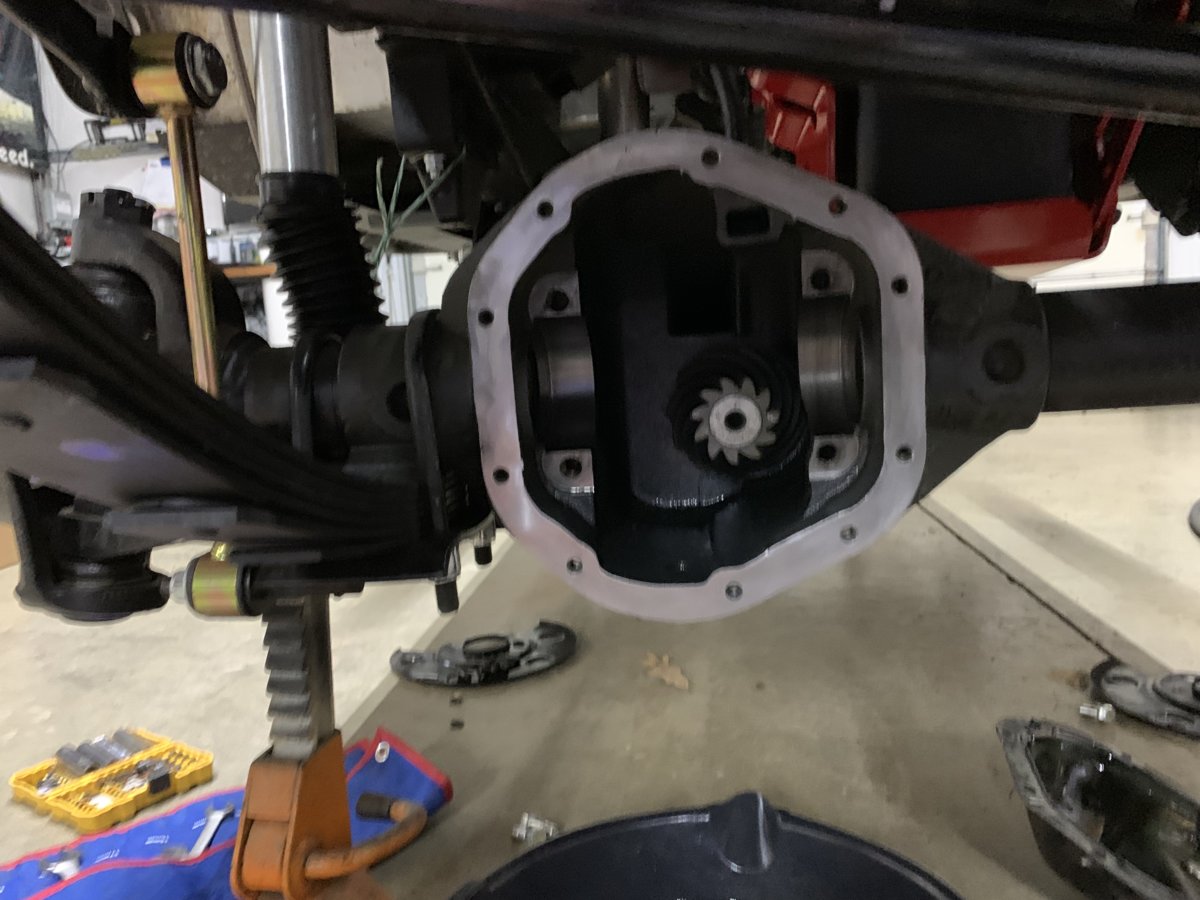

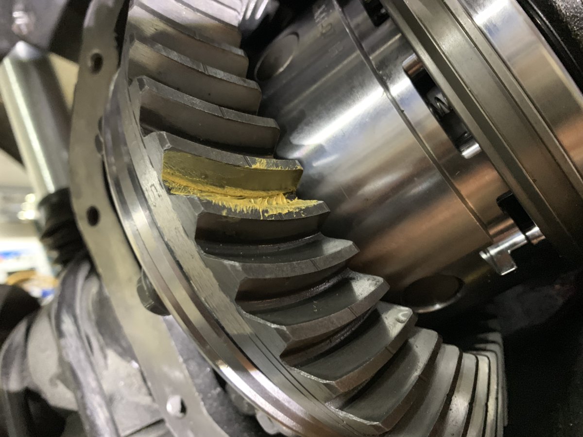

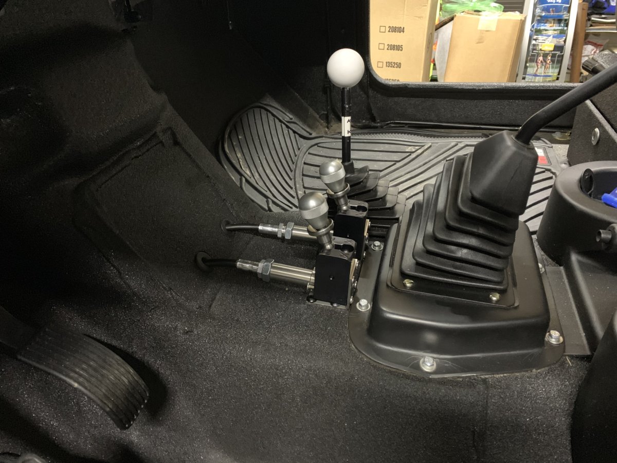

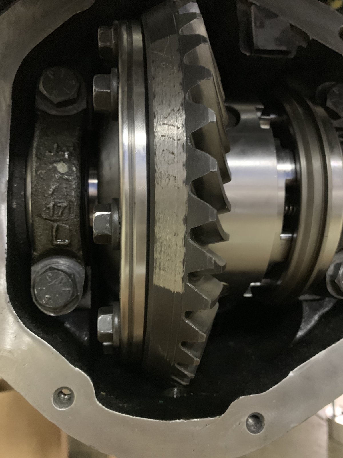

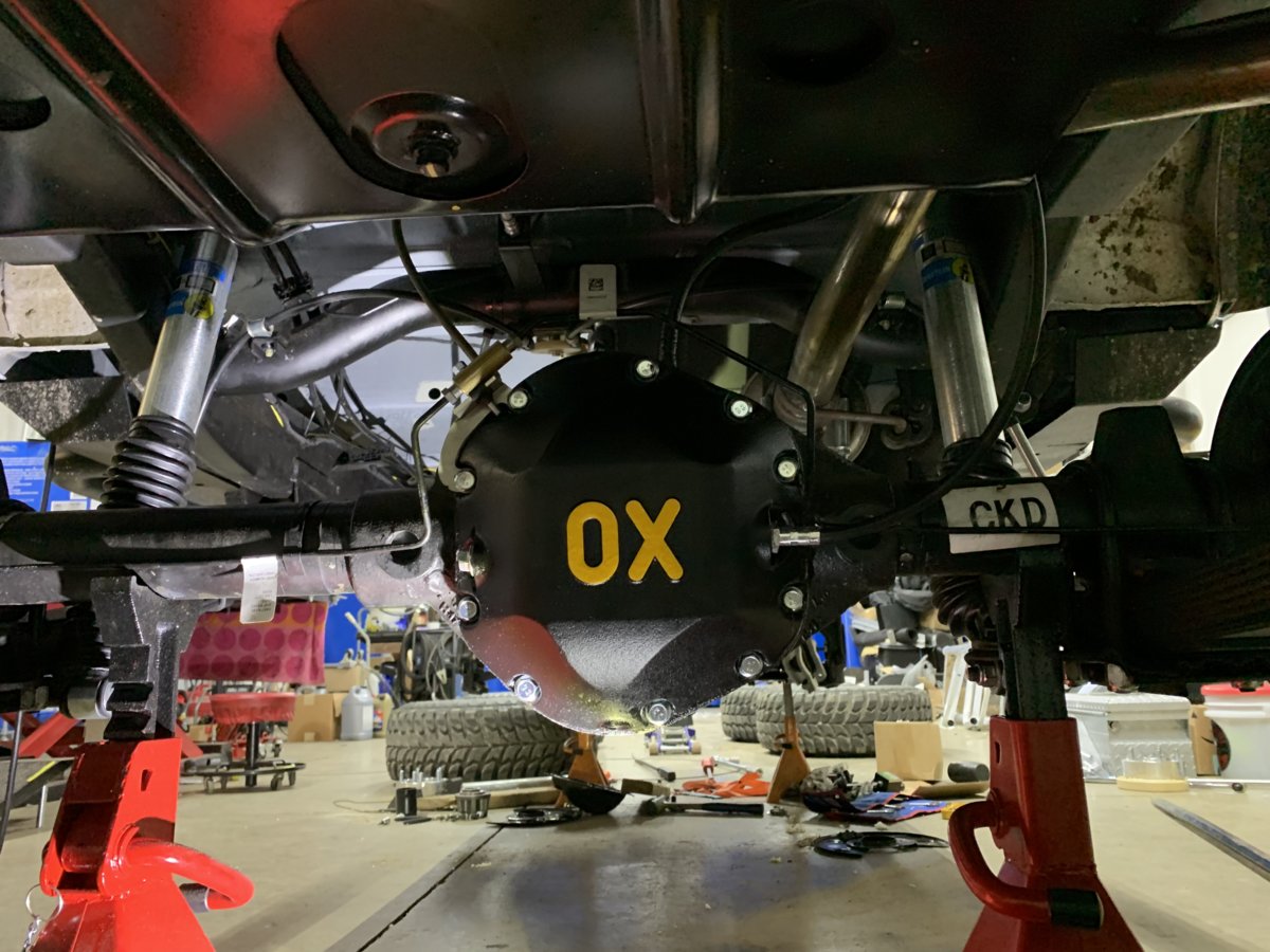

Just Got the OX Lockers Installed
one2doo
Nov 18, 2018
65
East TN
181
8B6A00BD-3BB4-4EDF-95A9-BF836E828282.jpeg 7F7E36E0-4930-48B4-BFF6-746E06D2BD25.jpeg BB8A1BE3-CA65-4422-88C9-1F441FF05636.jpeg 1D73A439-2AF7-4021-B2F0-5C652F25C4D5.jpeg 9EB6A43B-8040-4358-8D5B-40E0CADB67E8.jpeg
Fitch
Mar 18, 2019
12
Looks great man! What kind of lift do you have?

Nice! Im a huge fan of the manual OX locker and the drive away lock as a back up. For my purposes, a selectable front and rear locker works best. I hate the E-lockers mainly just because its one more thing to go wrong and I have no way around that in the dirt.

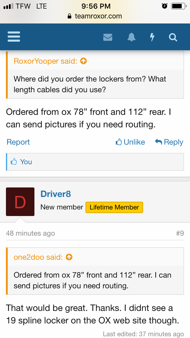

Driver8
Feb 12, 2019
49
Illinois

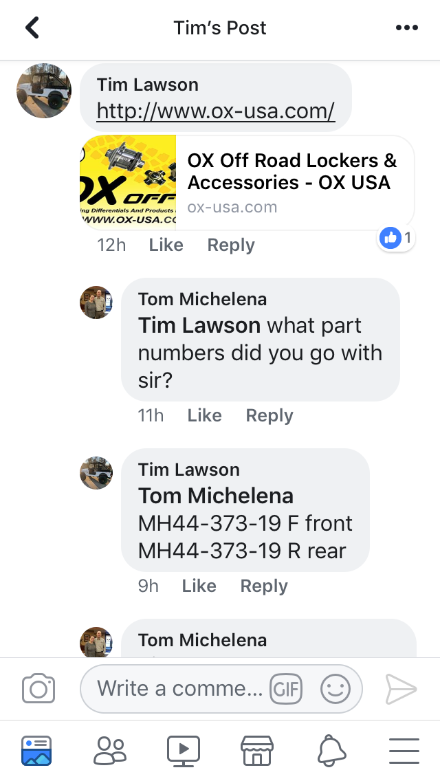

Ordered from ox 78” front and 112” rear. I can send pictures if you need routing.
That would be great. Thanks. I didnt see a 19 spline locker on the OX web site though.

So would I be looking for Dana 44 30 spline w/ 3.73 for the rear??
