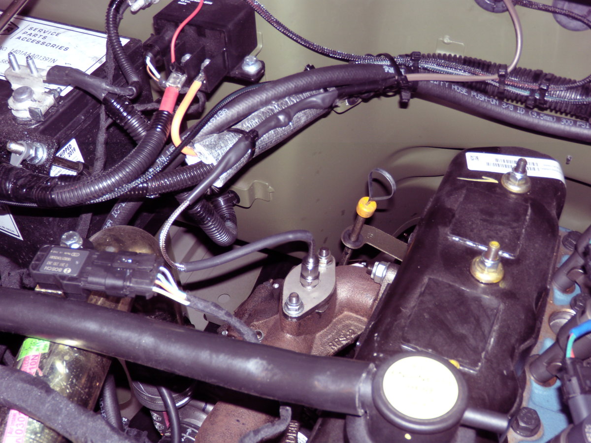

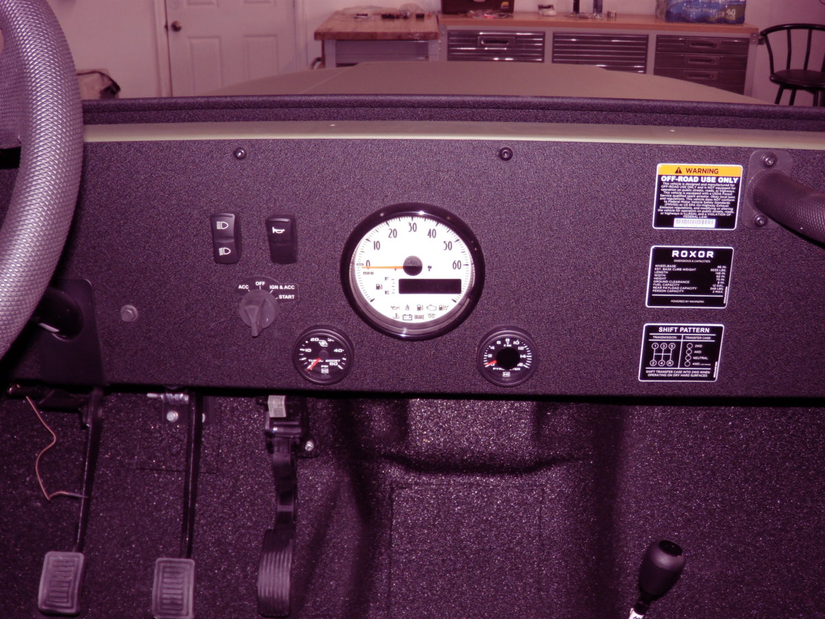

Installed a Hewitt Industries Boost/Pyrometer gauge set purchased from Amazon for $184.00. Seemed a little cheap and quality was a concern. Always used Isspro on past vehicles. After reading a few reviews customers seemed happy.
The gauges are straight up with nothing fancy. The thermocouple comes with a lifetime warranty. Overall happy with the decision.

Looks really nice!
Thank you. I scratched my wooden head for a while trying to figure where to place them?
The EGR delete plate sure made the thermocouple location a snap.

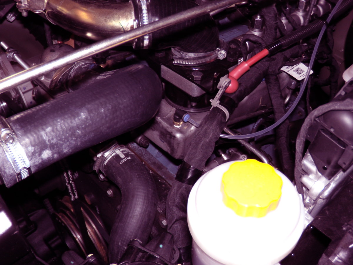

The intake was a different story for locating the fitting for the boost line. After removing the toaster it was determined in the corner would work fine. Was also able to remove the cuttings with a shop vac. There was an oil film so the cuttings the vacuum cleaner would not remove were taken care of with a shop towel and screwdriver.
The alternative was removing the intake which would require removing the fuel rail. Technically the high pressure lines require replacement anytime they are detached.

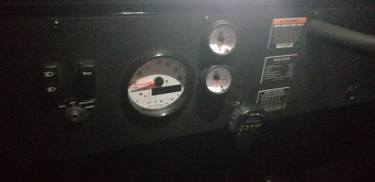

M151 that looks very good & clean work, I pondered the same thing about where to mount mine. Here's what I came up with.
2,194
My egt hasn't gone higher than 800 or so, I've heard too keep it below 11-1200. My base line off-road or rock crawling was about 5-600. On road was a little bit higher, not much. I'm fairly new to this but that's what the gauge is telling me. Do these #'s sound right?

Your numbers look normal. Cummins would test the early B-engines under full load for thousands of hours at maximum egt's, tear the engines down to inspect for wear and then sell them as used units.
