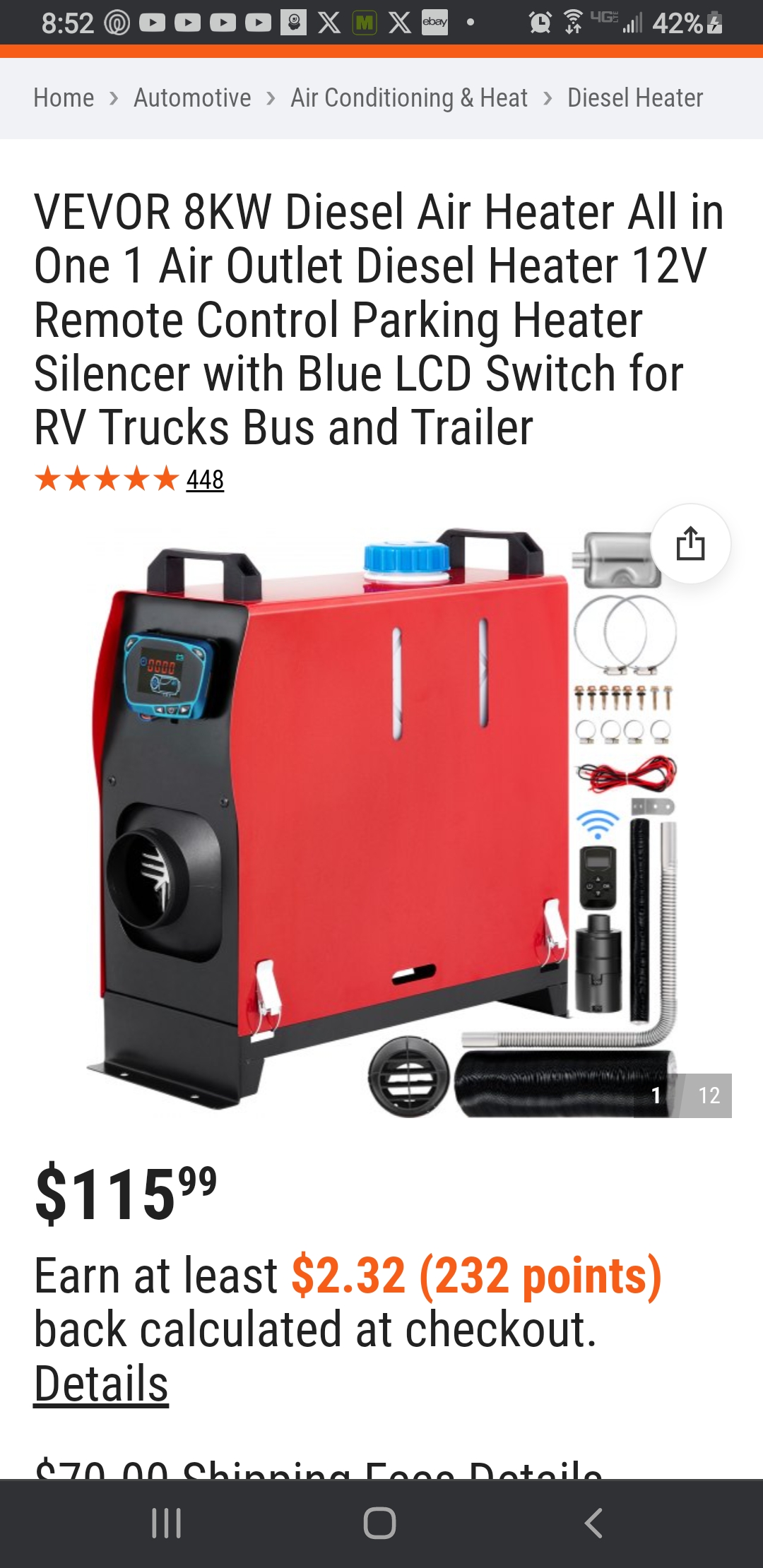

motormd
Aug 7, 2023
34
michigan
This will warm it up. I use one of these under my Mahindra tractor.
Uses the same diesel you put in the Roxor, and can be run off the rox battery. Puts out about 27,000 btus and burns less than a quart of diesel per hour. Usually 1 hour is enough to make the motor compartment nice and toasty.
