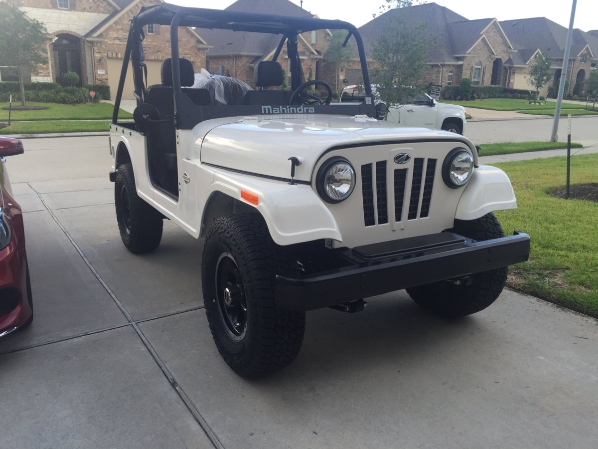

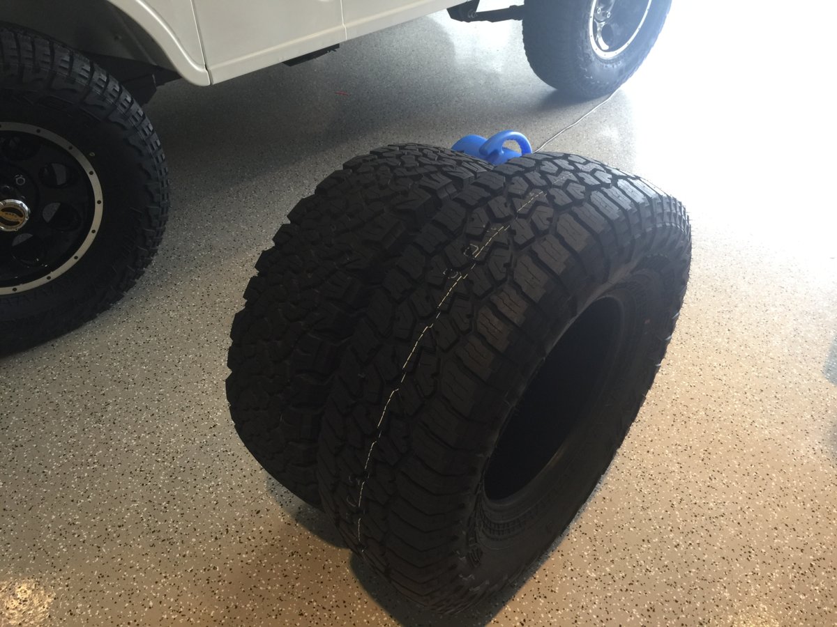

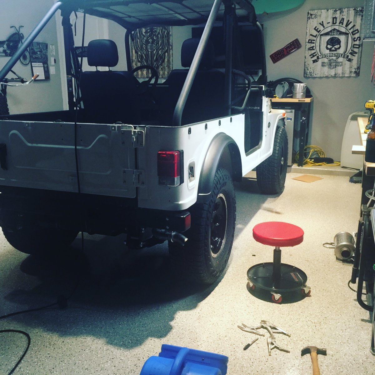

Got 265/75/16 tires installed today. Now just waiting on my lift.
Wow! They really fill in the wheel wells. Will you have to re-adjust the steering stops to prevent scrubbing?
I haven’t had the opportunity to flex it out but it didn’t rub on the way home. I might have to adjust the stops back out a little. In my driveway I turned them lock to lock and didn’t see any contact. I am waiting for my front level kit to come in. I have zero patience. Lol.

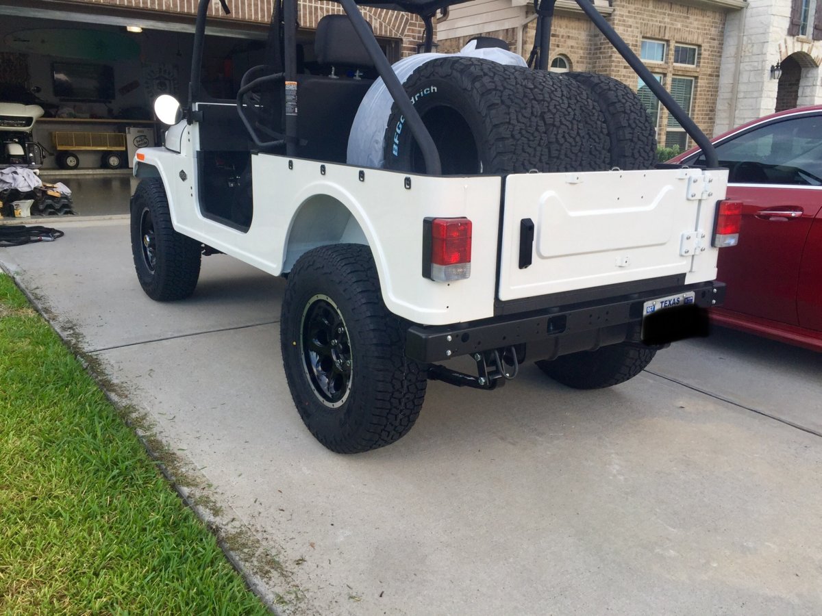

I notice you have plates on it. Was it a lot of trouble to get them?
That is a Texas dealer plate. I can move that plate to any car or truck I drive. Is it legal on the Roxor? Probably not at this point. I put it on to drive it to the tire shop. As soon as I get my windshield and turn signals I will get it inspected, once that is done I should be able to get plates here.

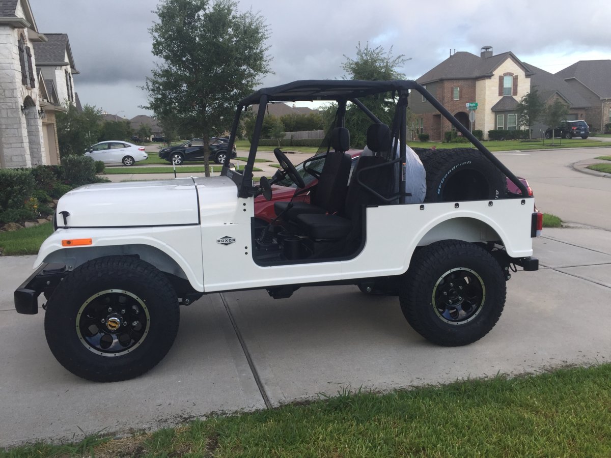

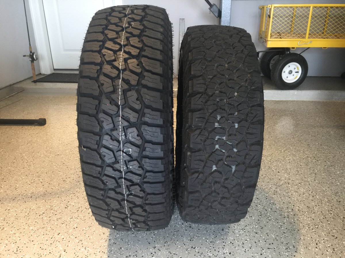

Any update on rubbing? Thinking of going with 235/85/r16, almost identical hight 31.7” vs your 31.6” 265/75/16 but without being any wider. Maintains the 9.3” width of the OEM tires. Often the width is what will cause rubbing over the height. The 235/85s and 255/85s are very popular on the toyota tacos as they get the height without lifting or rubbing. would be curios if the 255/85 would fit without a lift on the roxor. Its a 33” tall 10” wide tire?
So far I haven’t had much chance to drive it. Been working a ton and it has rained every day since I have put the tires on. I am waiting for a 2.5” level kit to come in. That will solve any rubbing issues. I drove it home from the tire shop and didn’t have any rubbing but that was just on the street. I will update once I get a chance to drive it more.

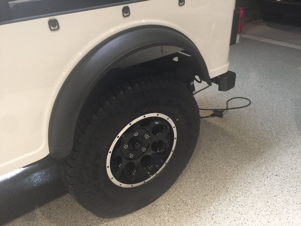

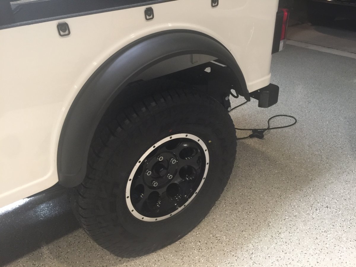

Thank you sir. They do rub at full lock, of course I adjusted the the steering knuckles in when I first got it. I have crawled all over the front suspension and cannot find any rub marks on anything. I assume the tires are hitting the leaf springs. I did order the On The Rox lift. I am going to leave it alone until I get the lift on. Once it's installed I will be able to make final adjustments and add the front fender flares that will rub if installed at the moment. I did get the rear flares installed.

Check the left-hand sway bar that’s where mine were rubbing same size tires. I’ve ordered inch and a half spacers.
I’m running 235/85r tires with sway links removed, stock suspension, steering knuckles factory setting and many miles of severe off road terrain- no rubbing
That is the tire size I want to try. You aren't using spacers and have no rubbing? If so, perfect! You get the height for trails and dont have to worry about spacers stressing things. I was thinking of that tire size and a rough cuntry lift, but sounds like a lift isn't really necessary, is that correct?
