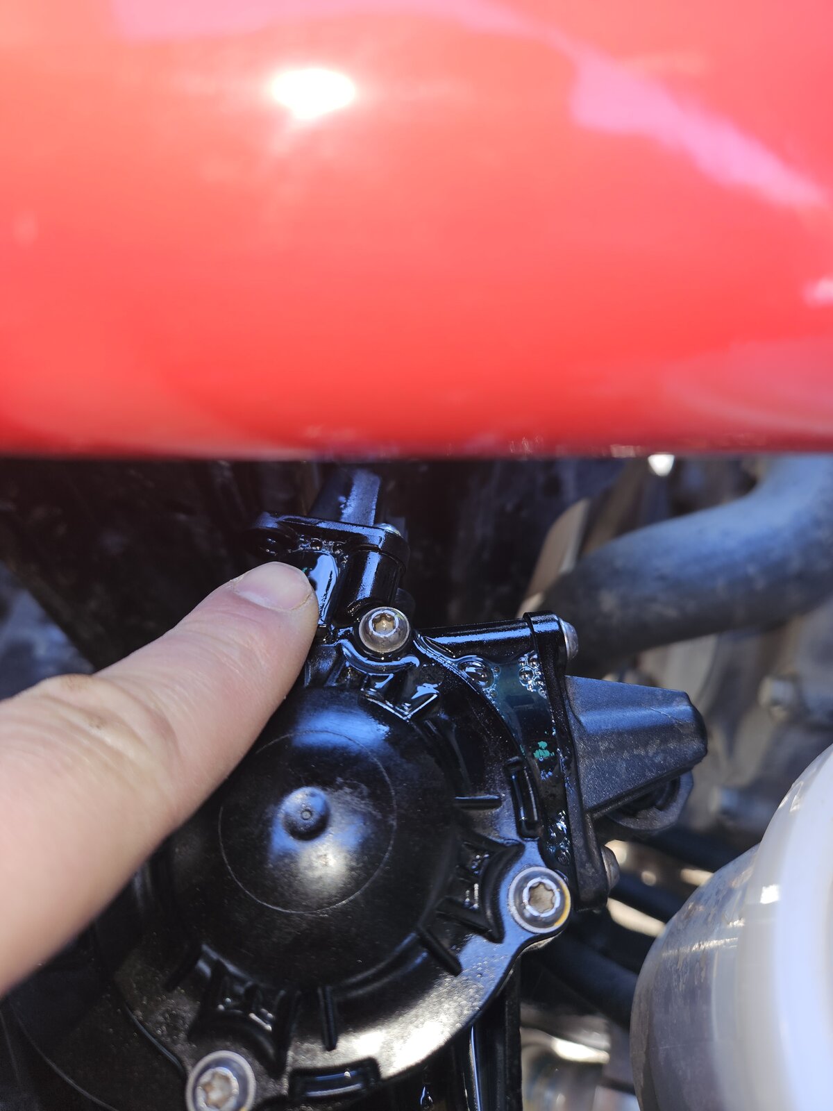

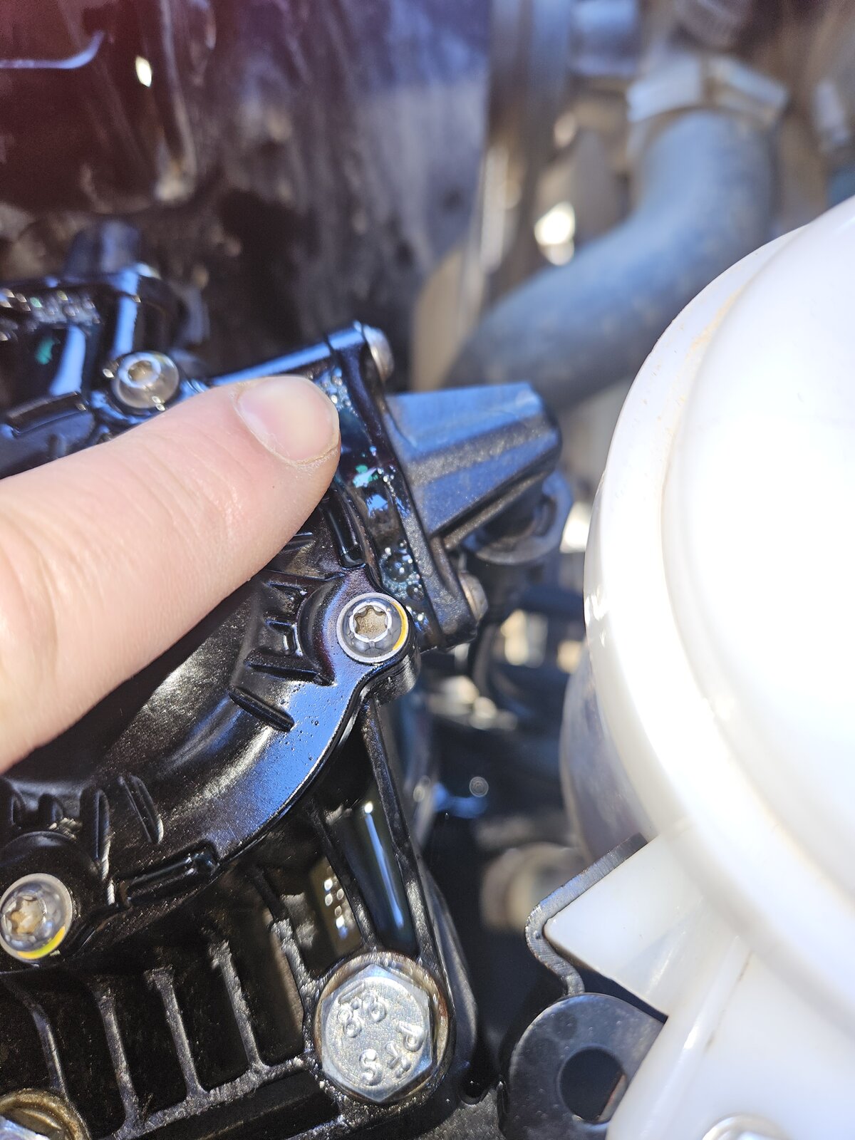

Anyone run into this issue? I went to start the Roxor today and diesel went leaking out of the fuel filter housing. Apparently, where my finger is pointing the one screw backed out a little and the other is stripped out?

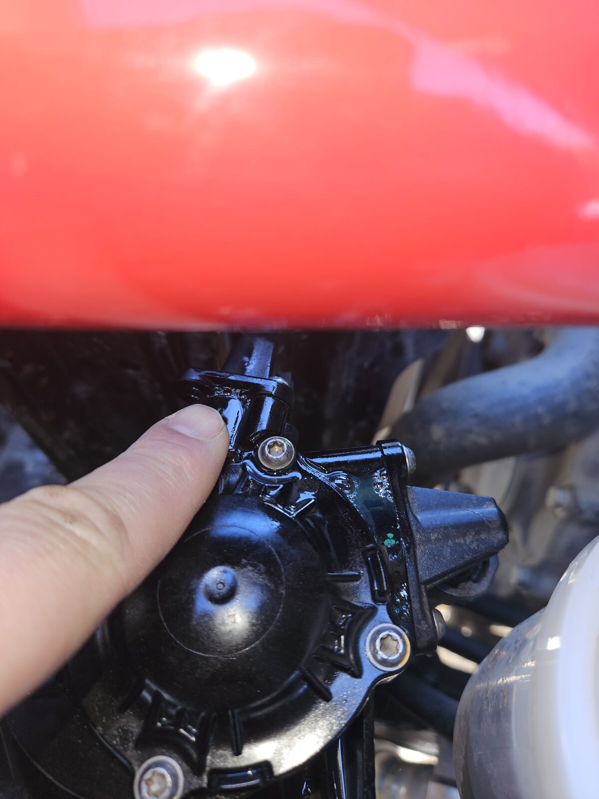

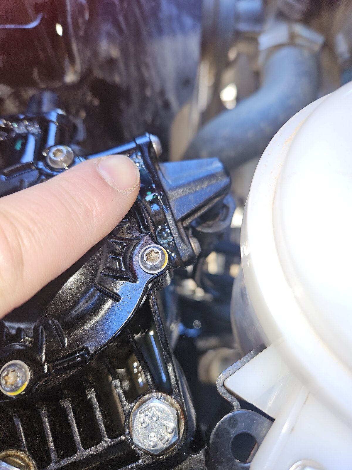

I really don't like this guy Murphy that claims to be my friend! Lol
View attachment 13196 View attachment 13197

I had one loose and two more that I tightened a l. I was afraid to really snug them up, because of the plastic and you had one stripped out. If you would, post on here how you fix it, if you do. Thanks

You could ream up the hole and re-tap the hole to accommodate the next nominal fastener size which would be a good option. However, you could also use a threaded insert (Helicoil) to allow you to use the original fastener, thus maintaining your Interchangeability. Threaded inserts are available in metric sizes and with self-locking threads. You would choose the insert with the same ID and thread as your factory fastener and then ream up and tap the hole to match the threaded insert's OD. Threaded inserts are a good solution for stripped threads. Both of these options assume that you have enough material left such that the hole does not tear out. Typically you would like at least a 1.5 diameter e/D ratio. (e/D=distance from center of hole to edge of part/diameter of hole). It would take greater edge distance to accommodate a threaded insert than going to next nominal size fastener, and based on the photos, it appears your edge distance is very minimal, so your best bet would be next nominal fastener. This whole discussion assumes the fastener is a machine thread and not just a simple screw thread. If screw thread, just screw in next size with a bit of medium thread locker and call it done.
2,194
After trying to come up with different solutions, it is apparent there is no salvaging this. The screw location is too close the edge of the canister. Thanks to all who had input with ideas (one of the many reasons I love this forum!!!) Good news is I found it on EBAY relatively inexpensive about $85.00, not dirt cheap, but not crazy either. Anyone who needs parts, there is a ton on there.

Well a battery later and a fuel filter and she is back in her glory! It is so nice to be able to work on a vehicle without needing a degree in engineering just to pop the hood. It was quicker and easier(5 minutes total to change to fuel filter housing and battery) then to try and clear an air filter code on my 21 GMC. Lol
