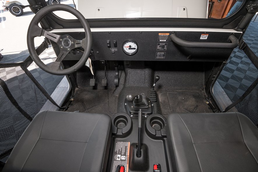

Please explain how the parking break would be unaffected? It is literary right between the bucket seats, exactly where the bench seat would cover it. Not to mention the leg room/shifter issue. Even with short kid legs I would we worried. In fact I would be more worried about kid legs, at least an adult knows not to kick the shifter or to put his legs over in the passenger seat leg area. He is a pic of an interior, note the location of the break and the shifter in relation to the front of the seats, just not practical for a bench.

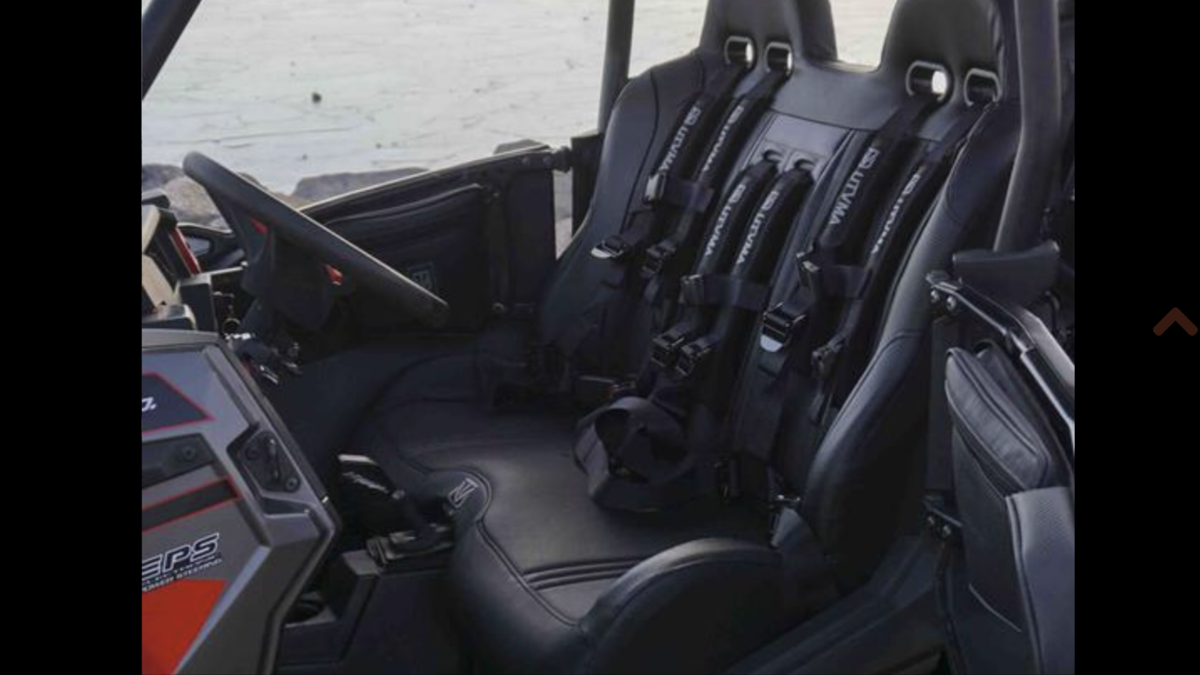

Quick search, RZR parts:

It should be possible to put a small slit up the middle of the bench to accommodate the brake lever similar to the RZR seat above. I don't think it would necessarily compromise comfort.

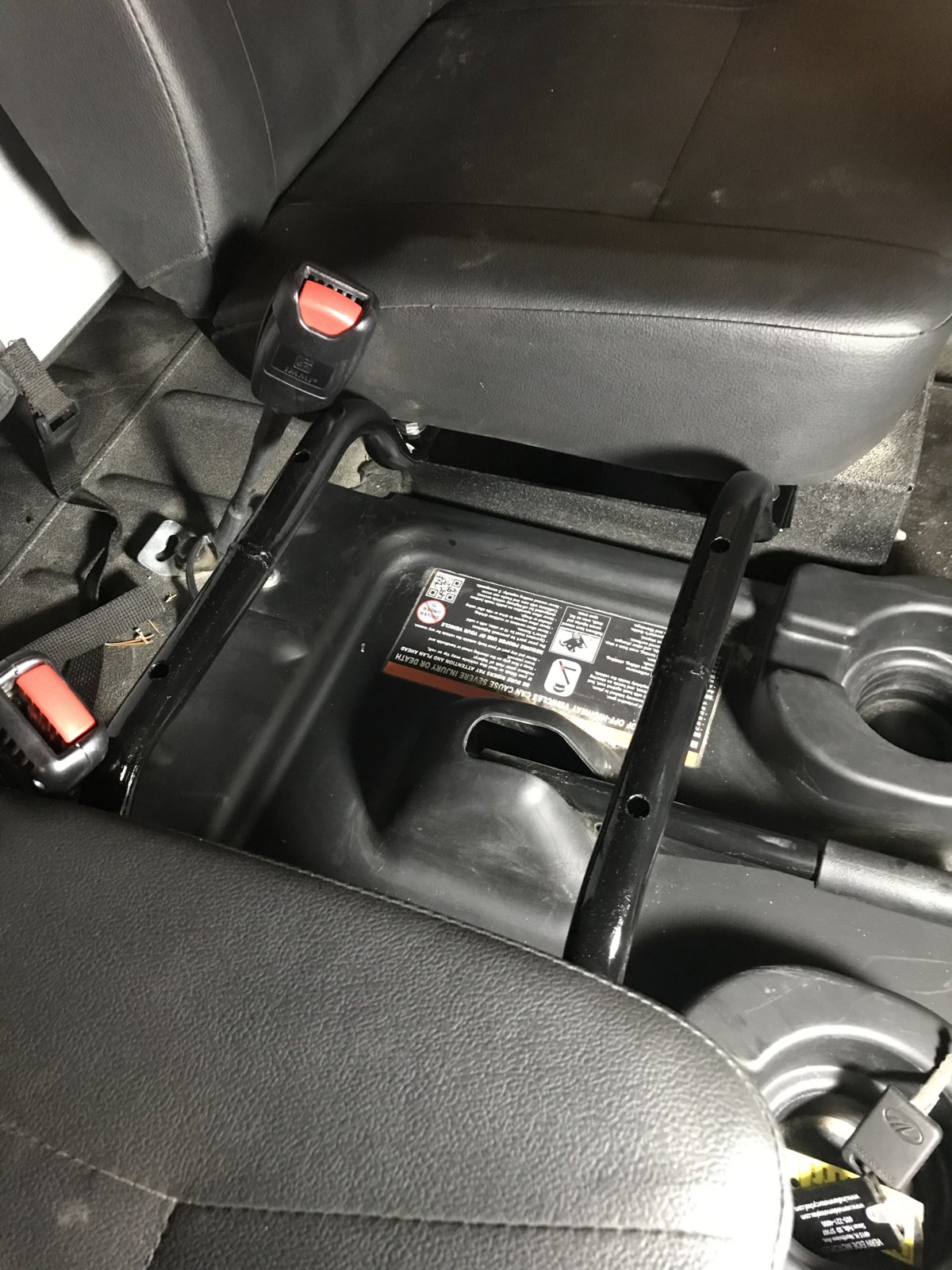

OK- I got this. Picture 2-CJ grab handles spanning from seat box to seat box supported by...
That’s all you get! I’ll show you the end result when it’s finished. Damn, I like this place! Constant source of ideas. The Pup says Thanks!

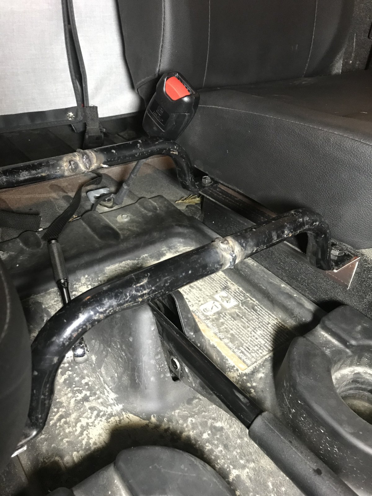

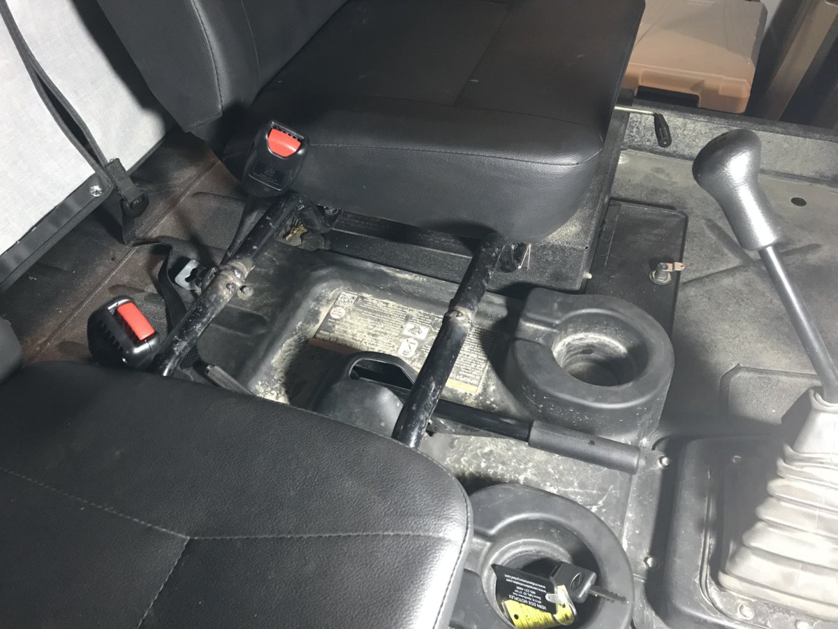

Here’s the start. Used 2 CJ grab bars but had to shorten them 1 1/4”. Next step is grinding welds and paint. Will build an upholstered seat with backrest and lap belts. Notice the ample clearance for e-brake and cup holders. Bonus will be a lot of storage under seat.

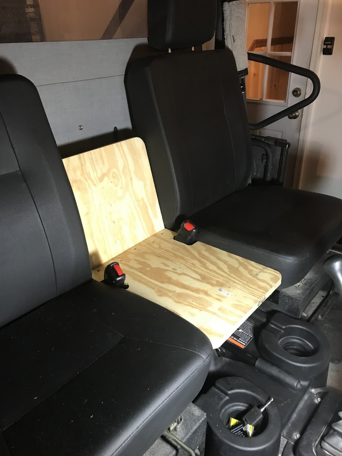

Cleaned up and ready for seat (or console??!!)

Seats will operate independently with buddy seat fixed. Very easy to add lap belt for grandkids.
