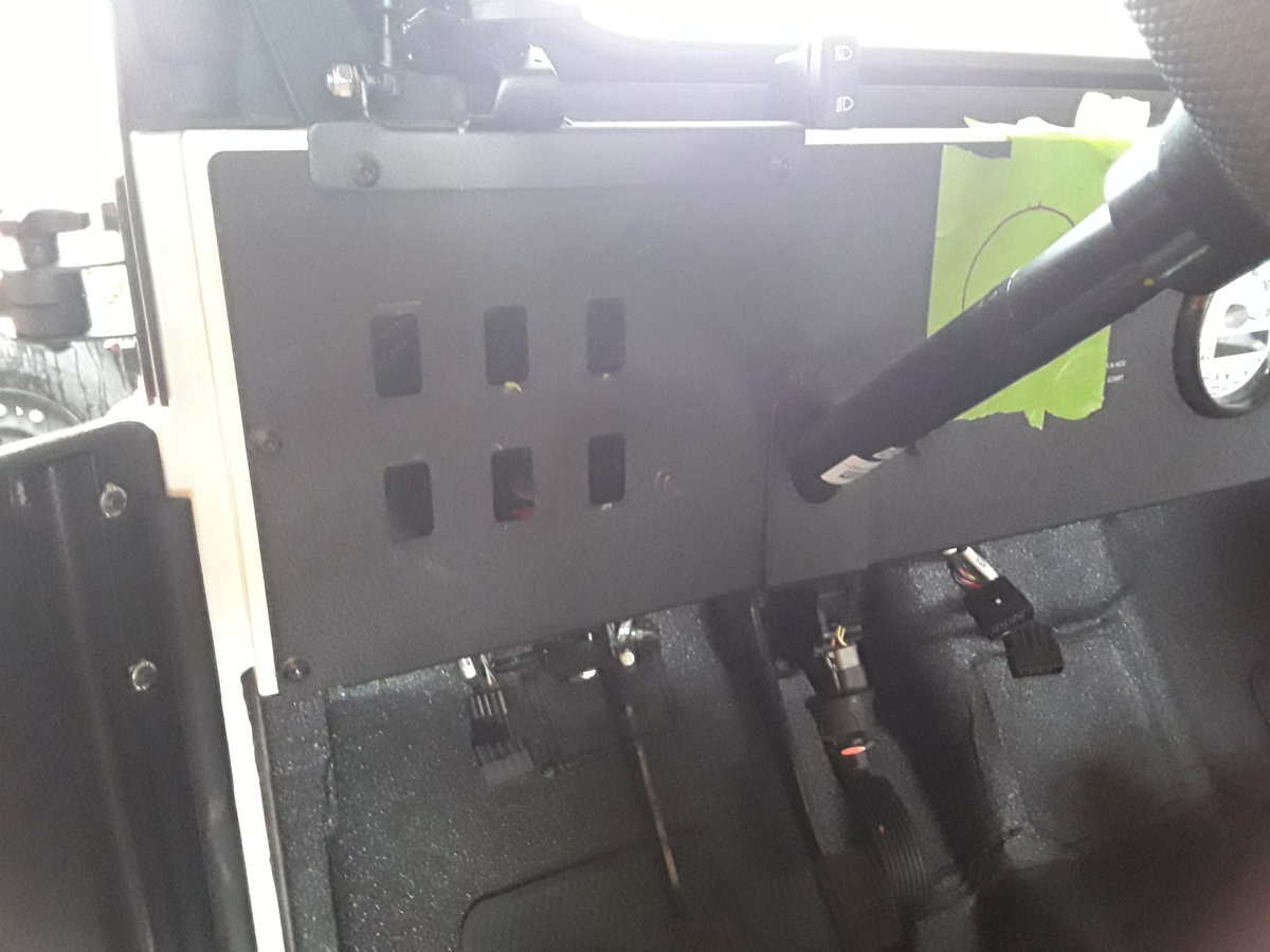

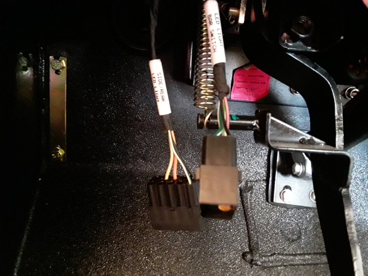

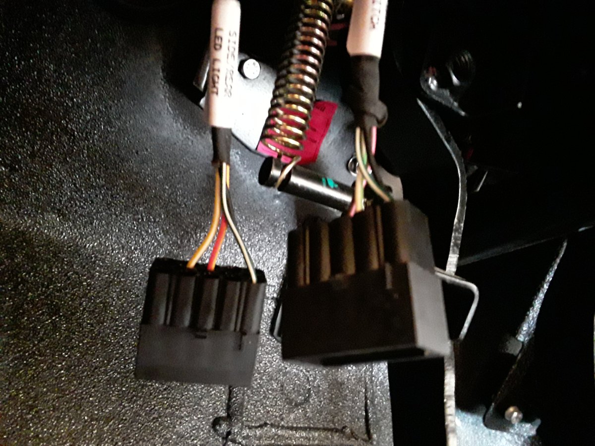

Thought I saw these listed somewhere.
Would like to use continuous power ground snd ignition power to accessories like radio GPS tracking mods or heater etc..
These are what team roxor use for factory heater and LED factory light bar swtches.
If anyone here knows what colored wires mean what or have checked w/ multi meter?
I'm outta my element and need help if ur open to help please do.
Thanks
Andy Daniel

Quite often, (but not always), black is connected to the negative ground. If you start with that assumption and connect your voltmeter negative to the black, you can check the voltage at the other wires, using the red probe. If you find a ~+12 volt reading, you can cut the accessory power off and see if it drops to 0 volts, then you know it is switched, otherwise it is continuous power. These switches should have ground running to them to power the switch light. It may not have the current capacity to run heavier devices, being is was only supposed to connect to a dinky LED.

Thanks for the direction... Now I want to but a voltage meter and do the steps to find out
The stock heater instructions use 1 of those two extra wires plugs but the wires are smaller in size so I hear ya
Using these will same me and others the pain of wiring small items when they are already done
