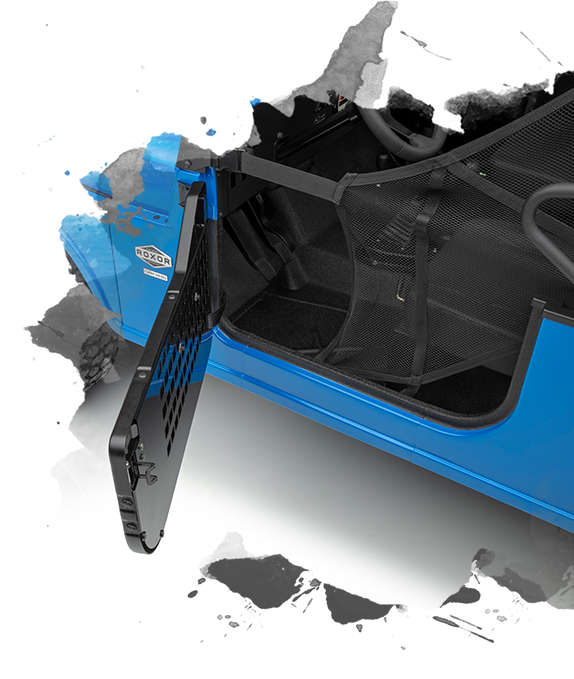

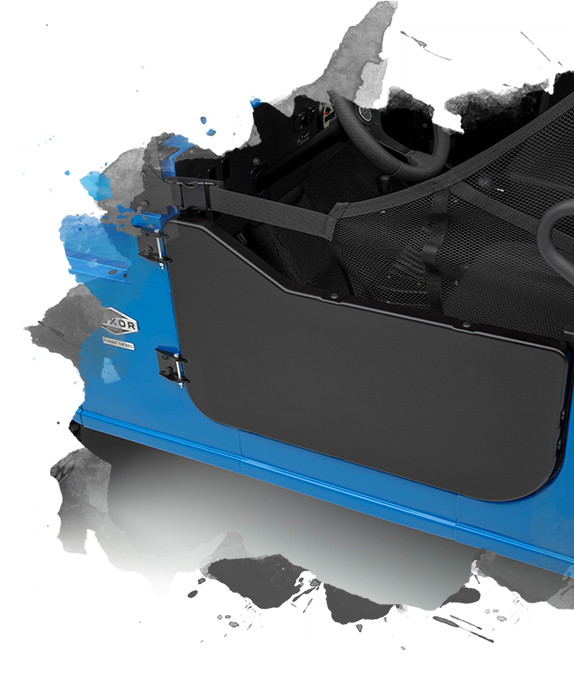

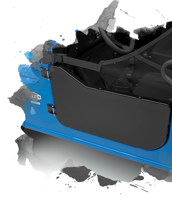

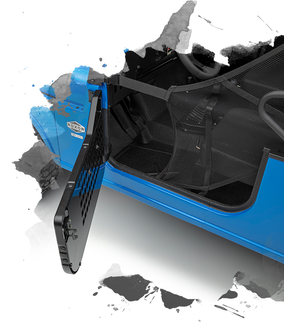

Solid Half Doors
These solid half doors are black powder coated and have a durable steel frame structure. They include an Interior molle panel for mounting storage accessories and an exterior UV protected black ABS panel with textured finish. The doors also have a wide opening for ease of ingress / egress, an easy to use pull latch requiring no vehicle modifications, and hinges designed to easily mount to the holes currently on the ROXOR. The splash guard is quick & easy to install and the exterior panels are easy to attach & replace. Available as accessory or factory install.
Part Number: 0103AUA00291N
MSRP: $699.99 USD

Those do look sweet, but I'm holding off on what comes about for the whole top.
Campyman
467
Bellevue, WA
I’m holding off too. I’d like to have a set of doors right away but 700 is too much. I can get half doors for the CJ7 for around 350. I'd say full doors would be worth 700.

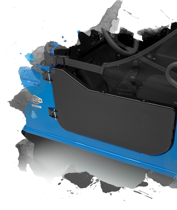

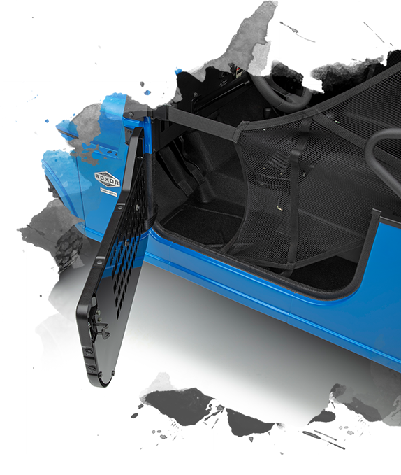

Solid Half Doors
MSRP: $699.99 USD

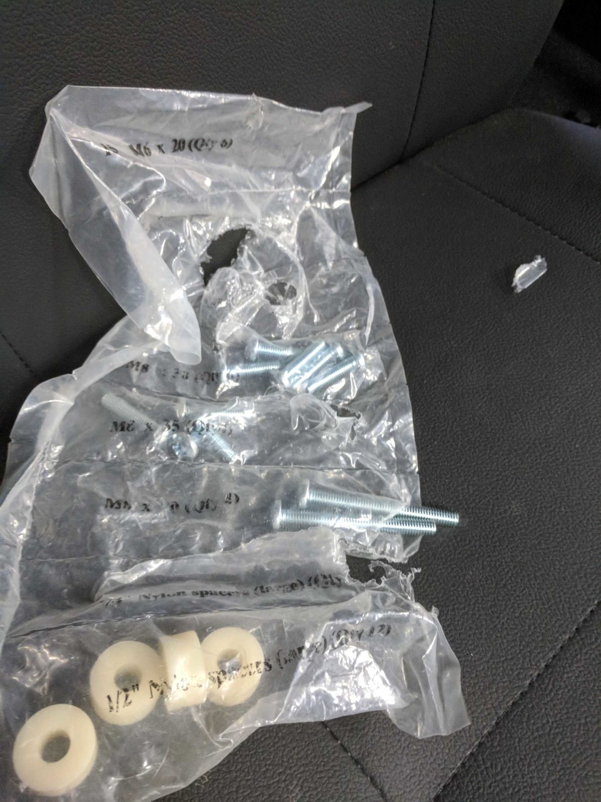

So once home I un boxed both doors and as it seems to be VERY COMMON with Mahindra OEM accessories, NO hardware or instructions. The instructions are not on line yet. No big deal but still! Hardware would be nice as well. So I get a few tools out and go to remove the OEM screws. WTF? These are some plastic plug pins with a hex slot to shove them in with. ERRRRRRR! So I get a small all and poke at them and remove the center portion and then pop them all out. Easy enough. Then its off to the assorted hardware box to see what these screws need to be.

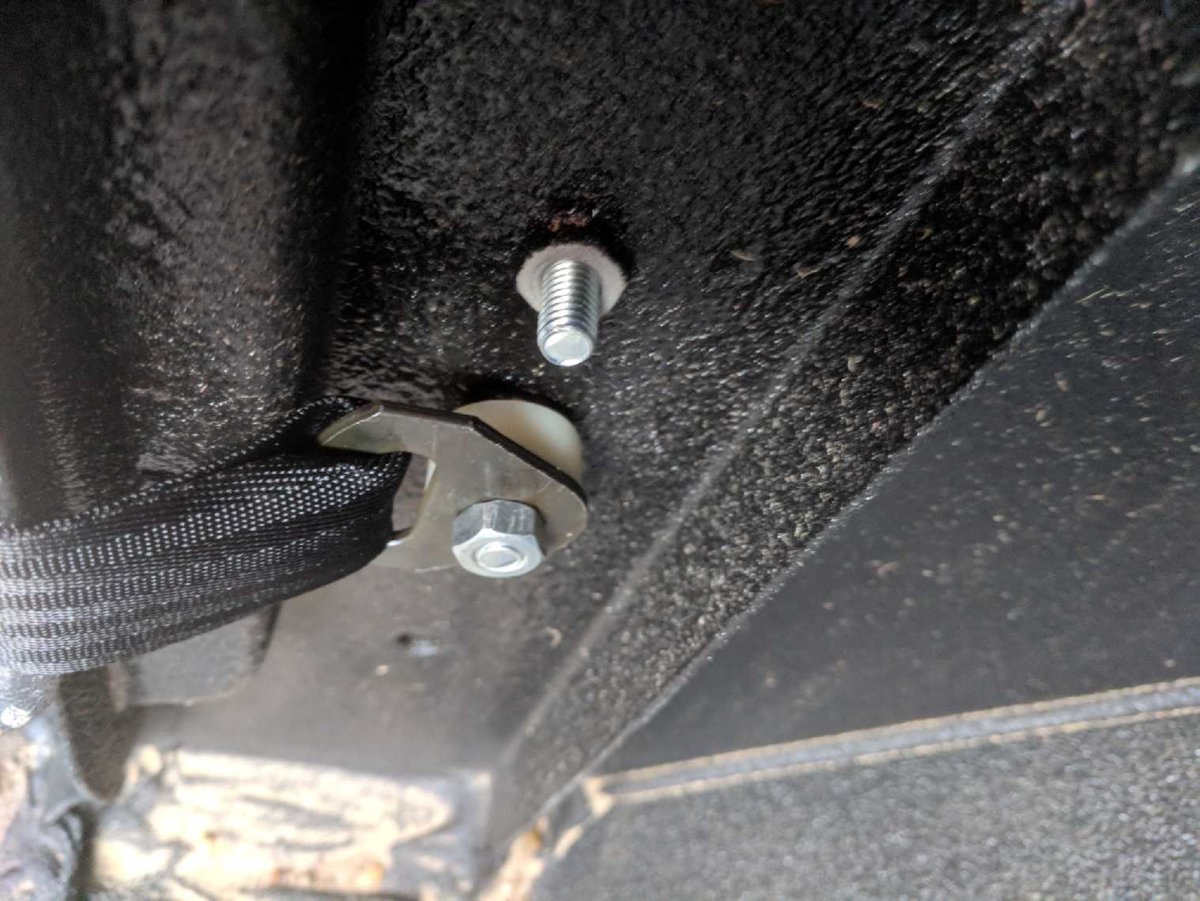

I grab the trusty ole 10 year old, shrink wrapped screw kit from a wall mount for a flat screen I hung up 10 years ago in the bed room and select a 8mm screw and try it in the OEM holes. WAHLAH! They fit. So I grab what I can that look long enough. I need 8 for the job. As it would happen, there are 6 of one length and 2 of another length but hey, it don't matter for this application. I round up some washers and go to mounting the doors.

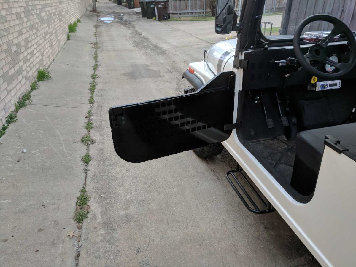

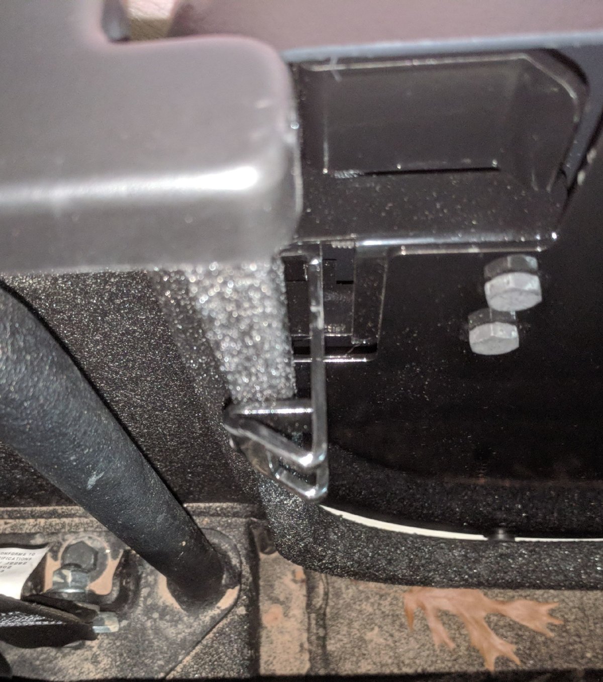

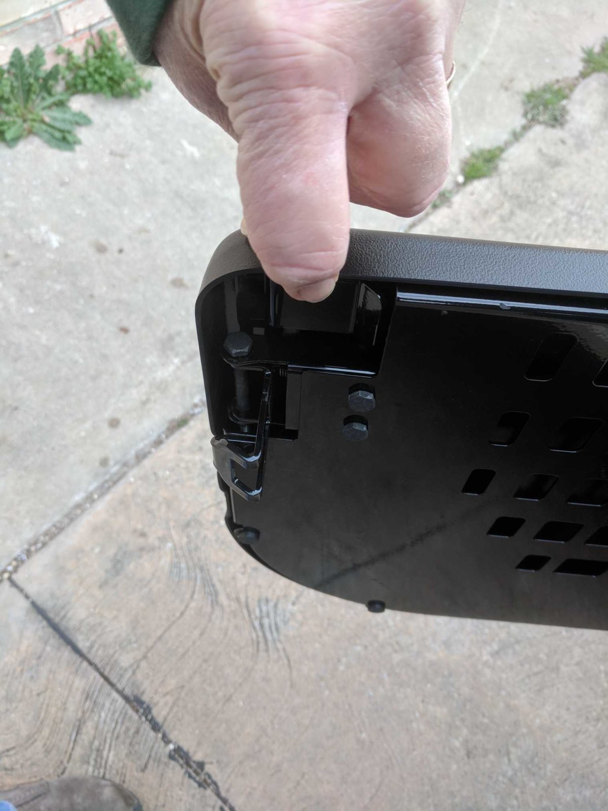

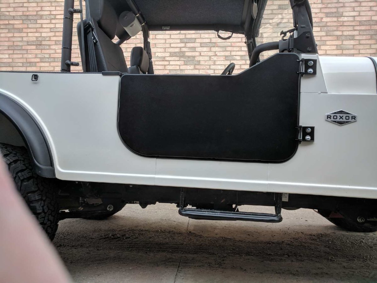

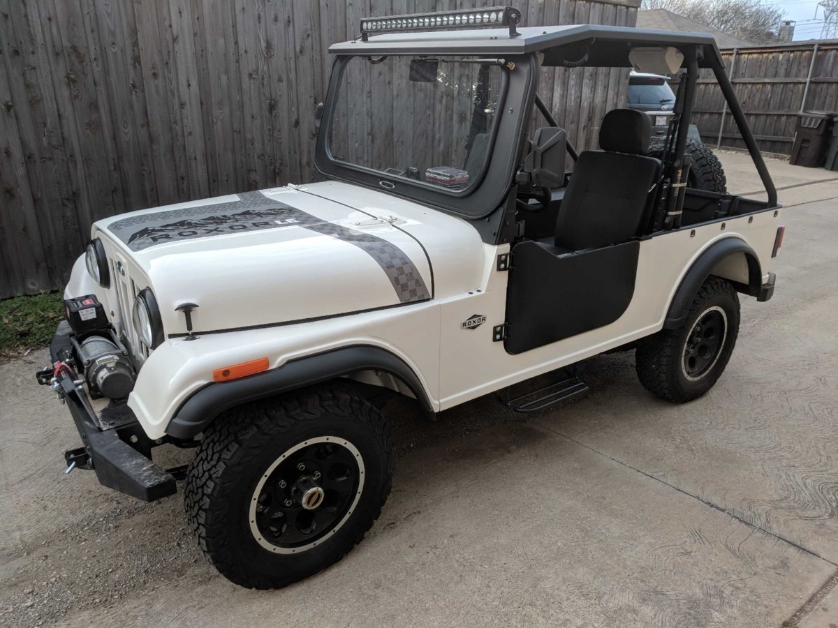

Very easy, just fold out the hinges and pop the door in the hole, CLUNK. It latched itself in just like its always been in that hole! COOL! So I screw the right door in first and can see right off that the retainer strap to limit the door from swinging 180 degrees and smacking the front fender lines up with the lower screw protruding in the foot well area. COOL! So I remove the lower screw and replaced it with a longer screw so I could use yet another part from for mentioned screw kit, a nylon bushing to space the strap buckle out from the recess its going to be in and this lets it clear the buckle from binding. I then slip the buckle over the protruding screw against the bushing and secure it with a nut. BADABING! Works like it was engineered in Michigan! LOL!

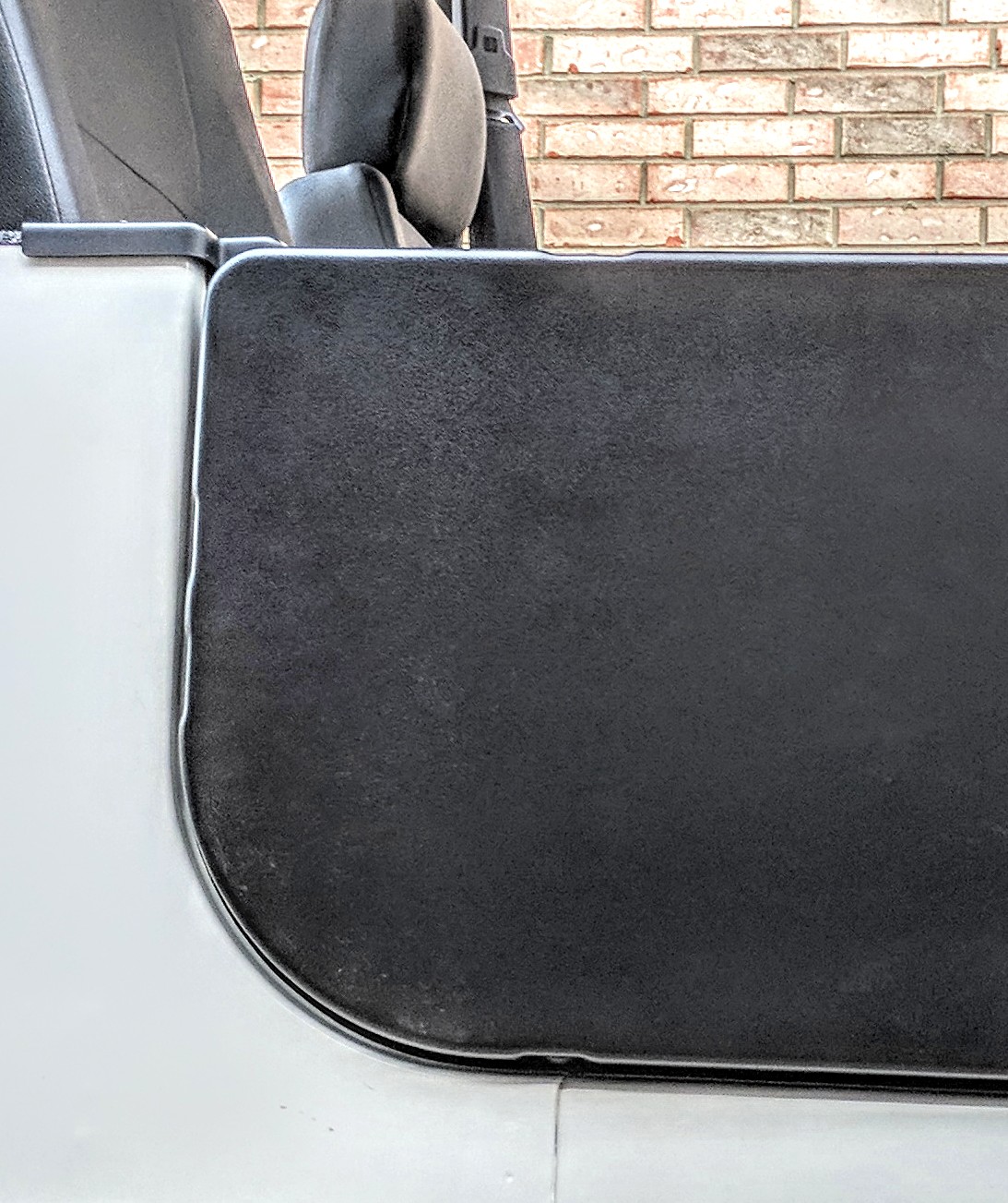

SO I loosen all the screws and preload the door forward and pull up on the aft end and tighten the screws. I step back and fling the door closed, PLUNK! Perfect fit. Has about a 1/8 inch gap all the way around and the little rubber snuffers on the inside of the door frame seat tight against the door body recess! MAN! ITS NICE! So now that I know what I am doing, I install the drivers door in about 3 minutes. BADABING!
The door catch fits nice and engages completely around the rolled door recess edge and the door release can be easily operated with a reach back to your side and poke it with your thumb, click, opens right up. Step out and slap the door shut, THUNK, latch engages 100% and shuts nice. There is a 1/8 inch gap between the body and the door all the way around, held there by the rubber bump stops on doors inner edge, also about a 1/8 gap all the way around the doors edge in the recess of the door opening so it should not rattle. Great fit!
Only 1 small issue is the bottom rear edge protrudes a tad more than the rest of the door out past body due to the rubber snuffers on the inside. No big deal to me, its a off road vehicle not a show vehicle. LOL. Well not completely true. HAhaaaaaa.
So other than black hinges against a white body, they look great and fit great. Here's a row of pics including my fast dwindling tv mount hardware stash. LOL! I will remove the doors to apply some clear protective tape on the back side of the hinge plate where it contacts the painted surface to keep down any wear of the paint. I will paint the hardware black, maybe, and I will most likely replace the bolts that are hinge pins with a quick release clevis pin down the road. All in all, I AM FAT, BLINDE, STUPID, OLD, CHEAP but I am also HAPPY! HAhaaaaaa.

Got a call from the dealer today. Steve the parts guy said, he got my OEM door mounting hardware. Lol. Only took a few weeks. Came with 8 black oxide hex bolts and 2 lock nuts to attach stay strap to protruding bolt from lowest bolt. Lol. Guess I had fingered it out. Maybe I should apply for a job at roxor? Lol.

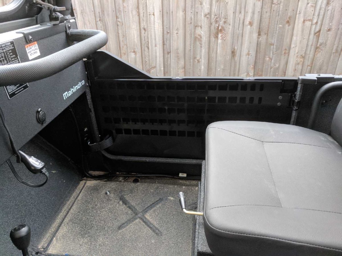

Looks great. Are they molle holes on the inside of the door?
I don't know WTF those are? HAhaaaa. They have a metal inner shell with square holes every 2 or so inches apart on the center 3/4 of the inner door. I think I read they are so you can hang bags or attach pouches? Molle being military garb? All I know is the fit and latching is great. No need to do anything but bolt them on, adjust to your liking before synching them down. Latch is built in and secures the door without any adjustment needed. Slam home, bonk, latched.
