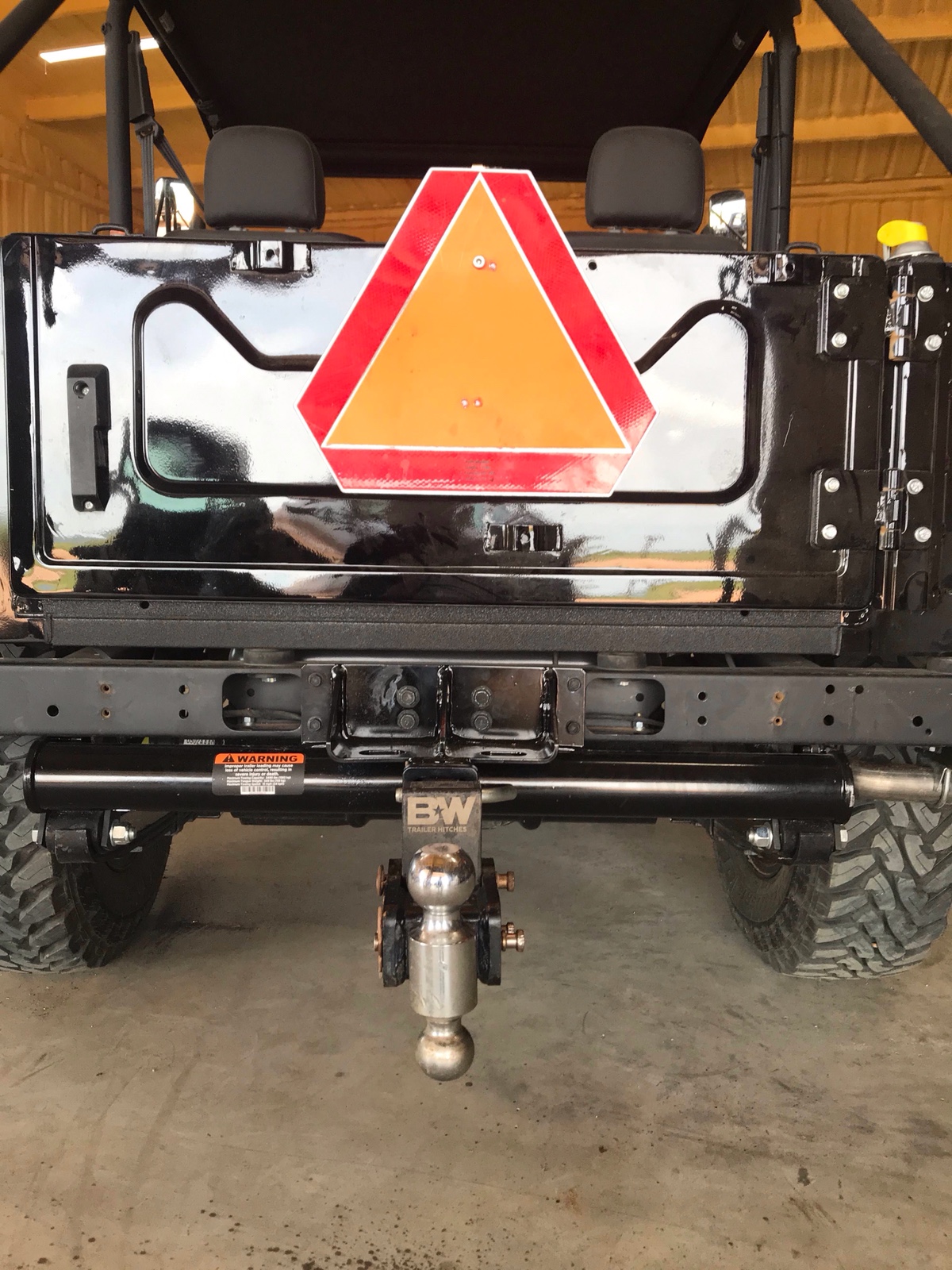

Factory hitch is only pintle and ball, how do you pull farm wagons with farm hitch?
I want to be able to put a 2" receiver hitch. Im leaning toward the full OTR back bumper with 2" receiver hitch.
Wayout
Jul 24, 2019
35
Brady, TX, USA
Mahindra makes a 2” receiver. It’s hell for strong I have it on mine.
You can take the ball off and use it as regular hitch. 2" receiver is nice though.
