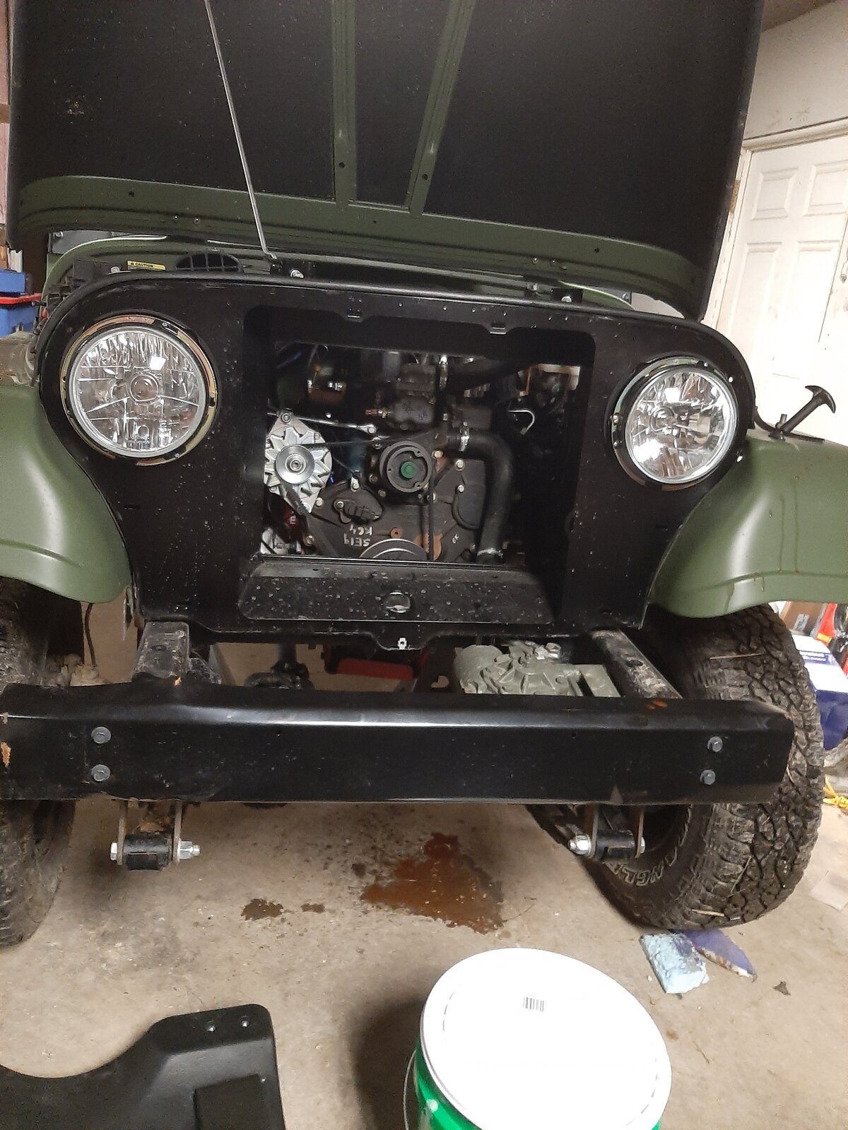

Electric fan install require radiator to be removed to mount?

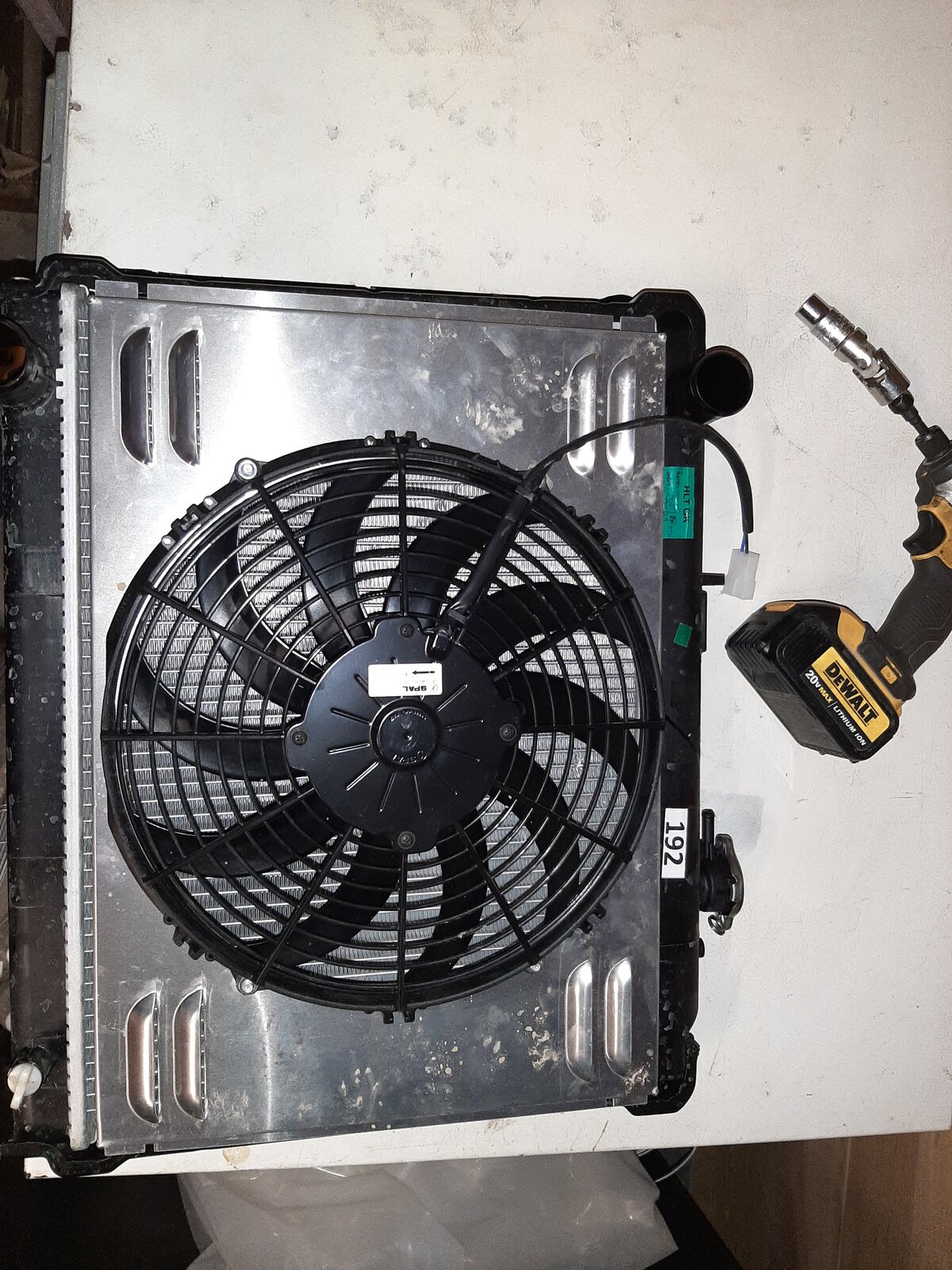

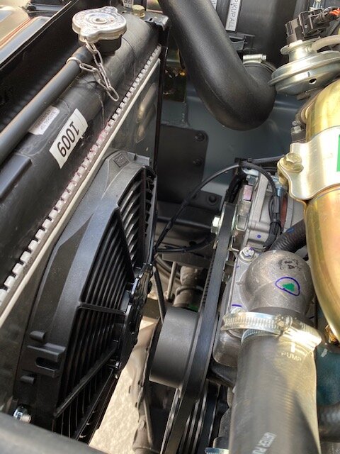

View attachment 8238View attachment 8239View attachment 8240
They've been doing it this way for a few years without issue, so I think this is going to be a great solution. Maybe (doubt) I'll find a way to install without pulling the rad. Possibly a pneumatic drill would provide enough clearance? (Super doubt)
Obviously there is enough material on the outside of the rad that you can drill into without spilling any water. This is good information to have. It also looks like they used the two notches on either side of the fan shroud (4 total) for screw placement, so lining it up should be no trouble at all.

Those pictures come from Wade at diesel freak. I'll probably get it done this weekend since it's pretty cold and nothing else to do. Then I just have suspension mods left and I'll be done doing performance upgrades.

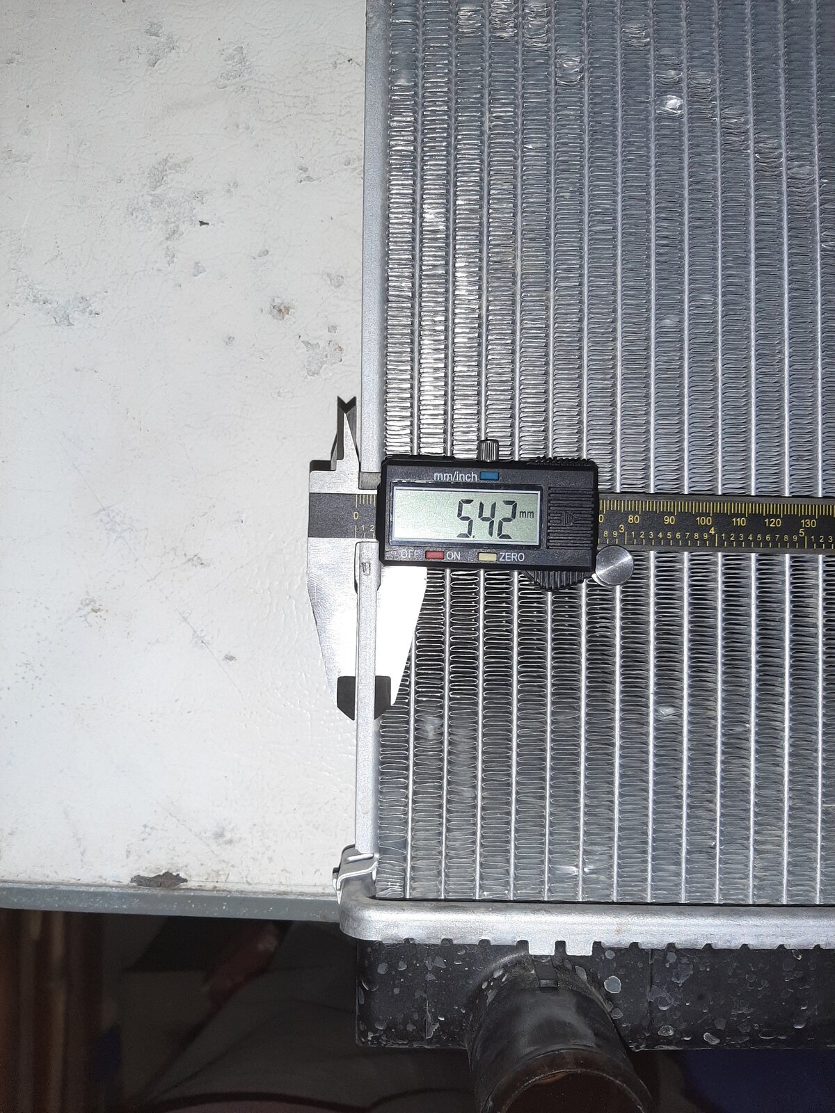

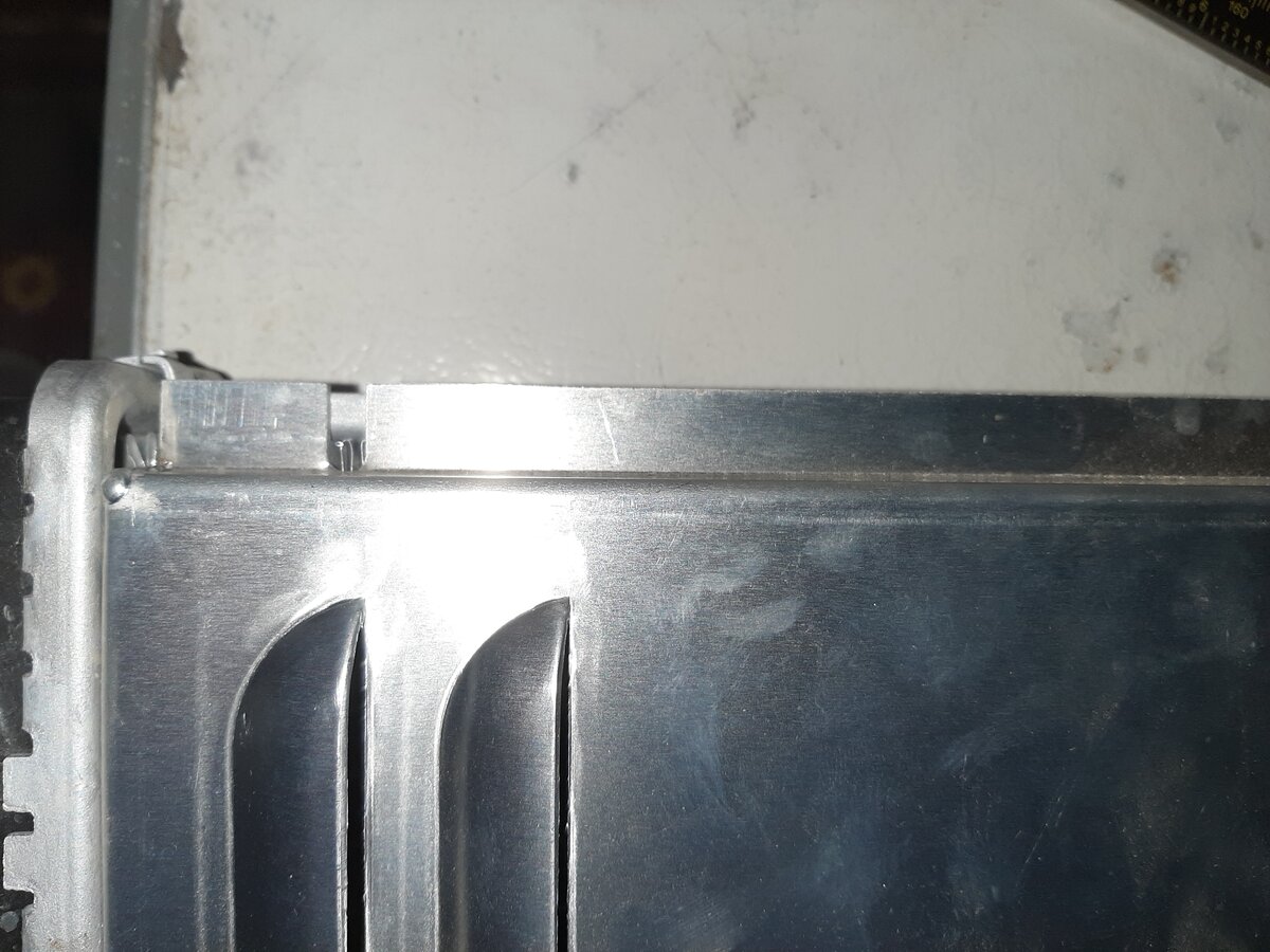

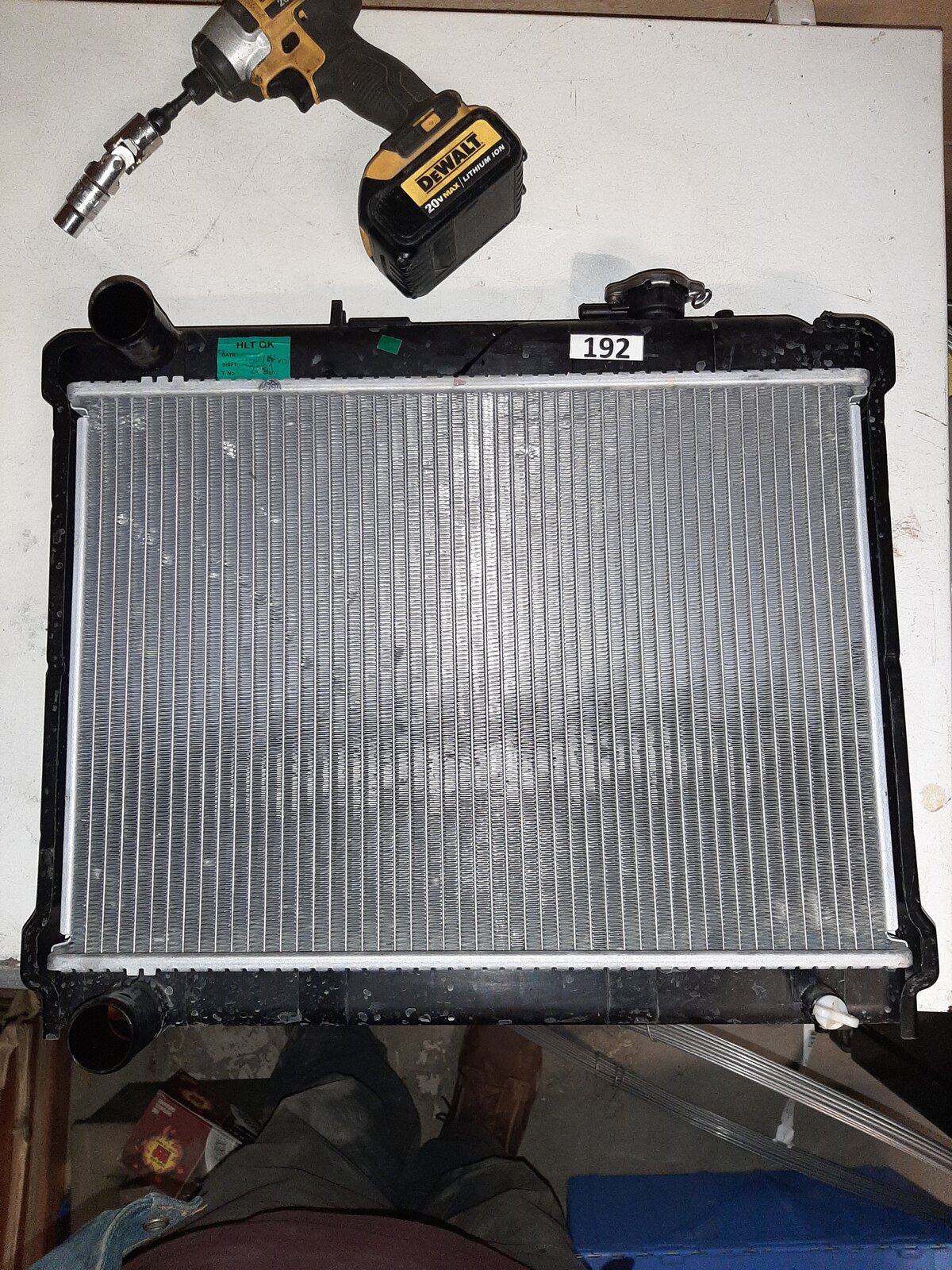

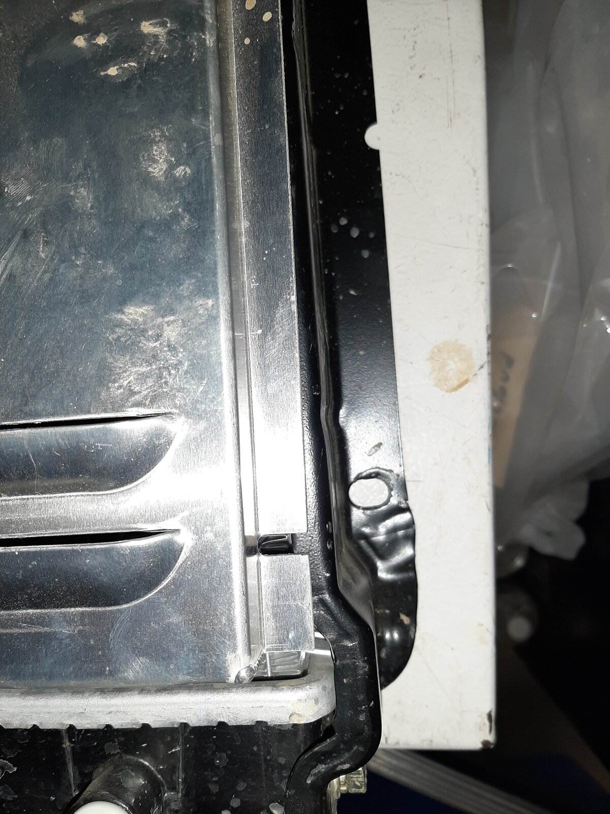

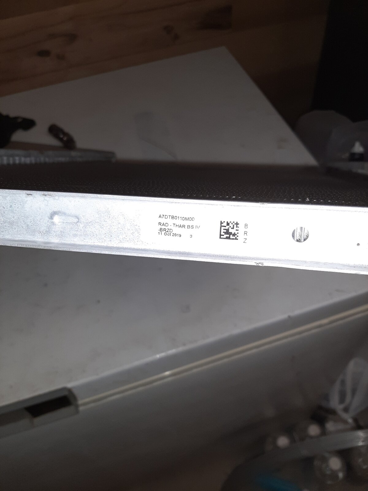

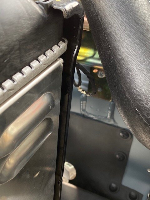

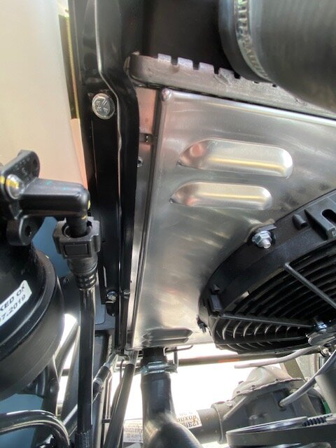

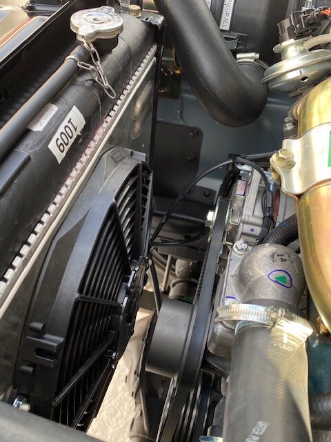

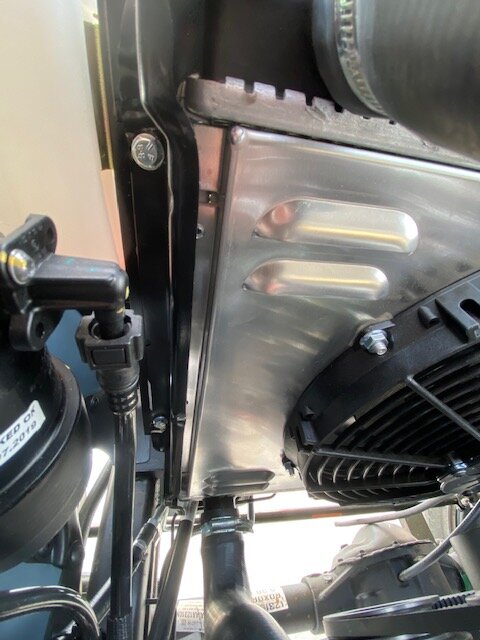

So I took my radiator out. Determined that in order to install this thing you have to remove the brackets from the radiator.
You are left with a 5mm flange to work with. So that means I need some 1.5mm self tapping screws that can hold a radiator fan and shroud in place while rocking and rolling on the trail... I don't think so.
Sure wish this thing came with some instructions or hardware. Like even just the pictures I took, I asked DF for pictures and they just said, "we used self tapping screws"
So I guess I'm the first to tell anyone how to do this.
Drain radiator
Remove hoses
Disconnect radiator cap from reservoir chain.
Remove four bolts with nylock nuts and flat washers holding the rad bracket in place.
Rotate rad counter clockwise
Pull rad from top
Fully drain rad
Remove bracket from rad
Figure the rest out for yourself, I guess.

I guess I could have it tig welded to the flange.
My problem with using tiny screws is that while it may work for the vast majority of users. It will not work for me. I'm the guy that breaks everything, so I have to over-engineer everything. I bought a diesel willys with 5.38s so that I could go beat the hell out of it. I just don't think there's enough meat in that flange to bother attempting it as is. I may see my local machine shop about it and see what they think.

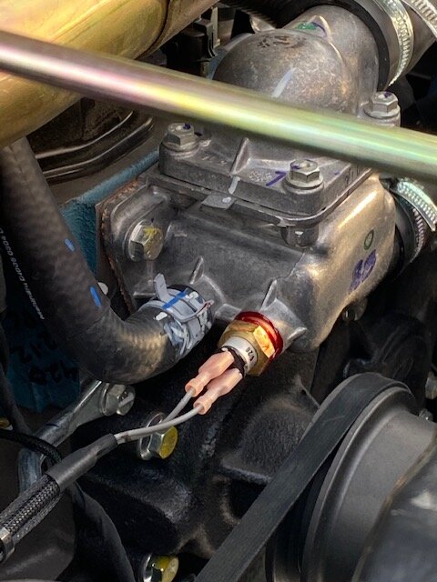

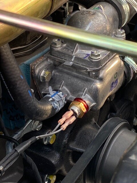

How did you wire up the thermoswitch (sending unit)? The one in the kit that is way too big has one prong. The diesel freaks unit has two. Do you pigtail it together?
