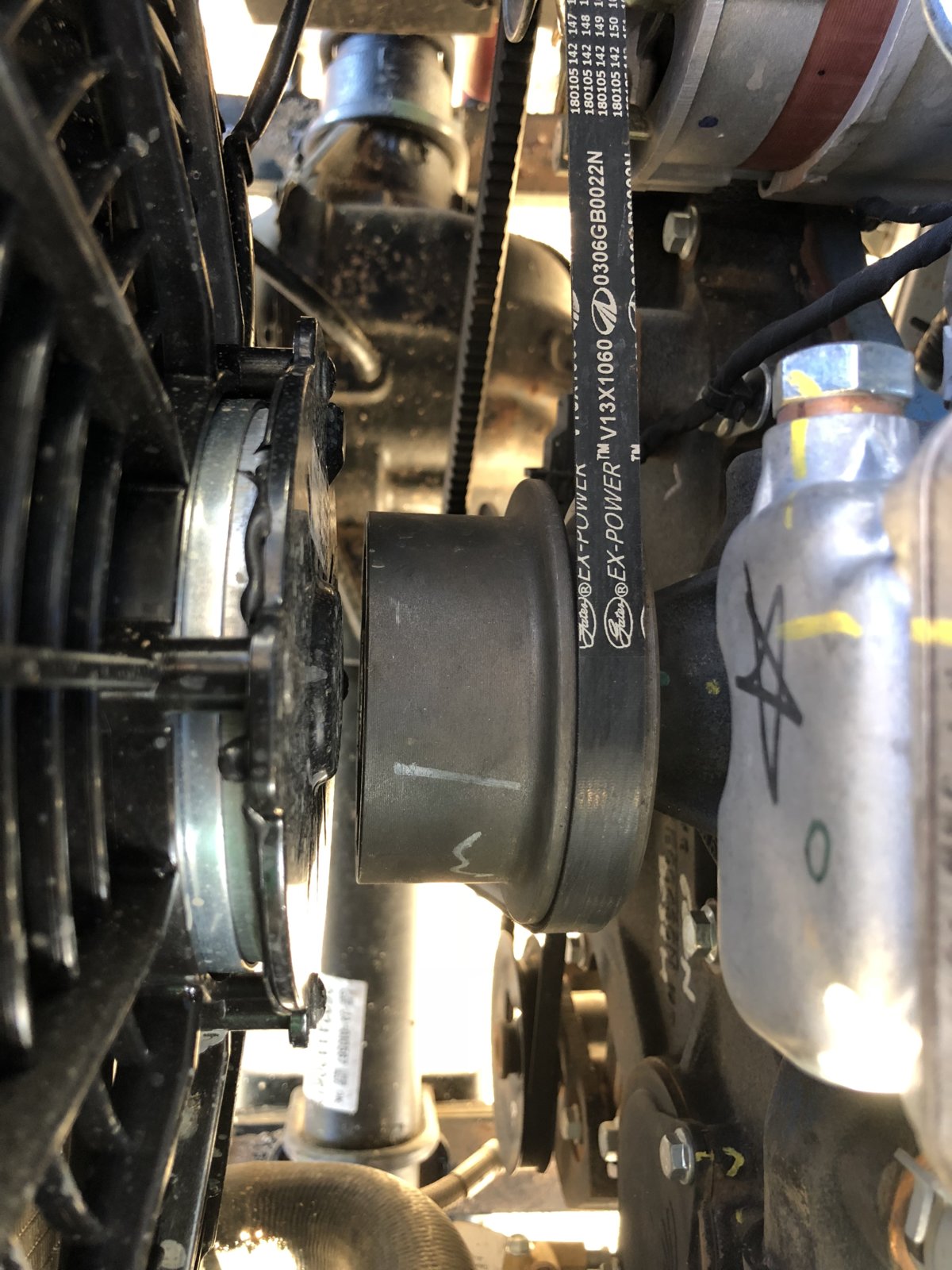

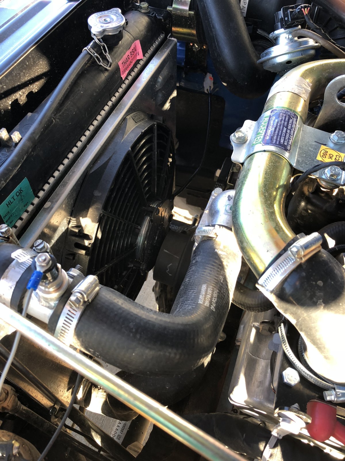

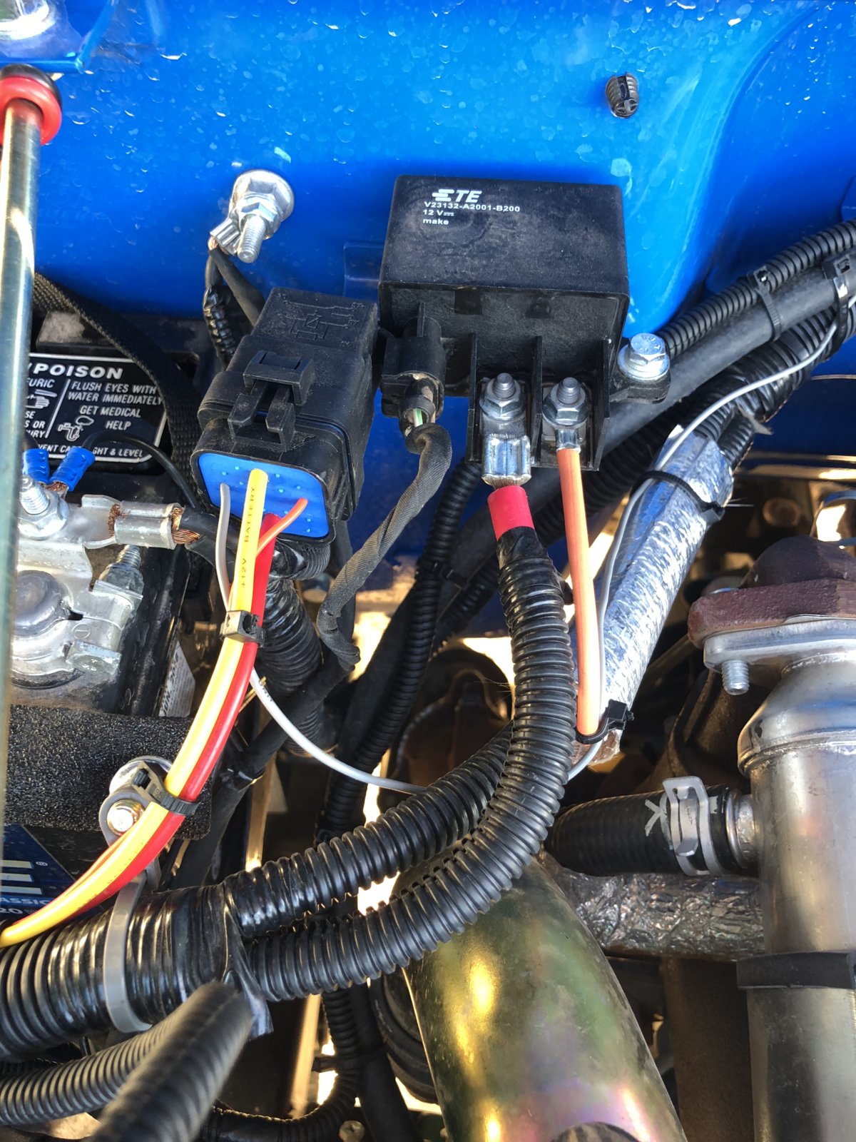

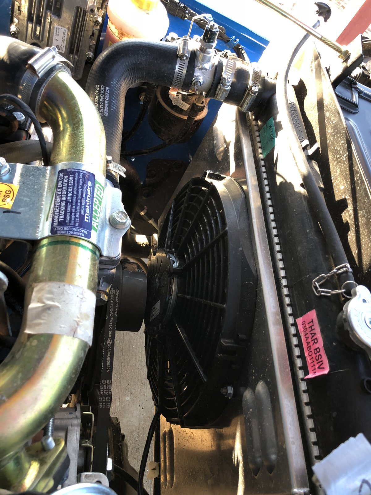

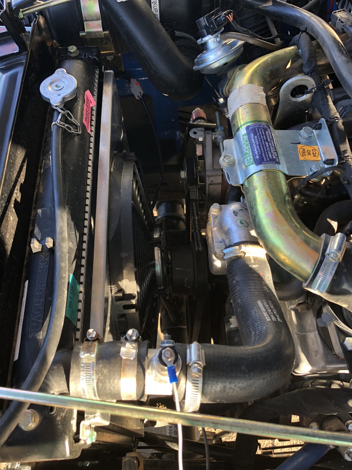

ALUMI-TECH RADIATORS (USA MADE) - Universal Parts Inc. | High Performance Automotive Cooling | Humboldt, IA. These guys have made an electric cooling fan with a shroud for our little jeep. I had to pull out the radiator to get it mounted but it was not super difficult as I know just enough to be dangerous when it comes to tools. It really works great as the stock fan turns all the time without a clutch and uses horse power not to mention the noise. I can putt along now checking out the scenery and just hear the little diesel purr. I was a little worried at first because it took forever to come on but this little engine is so efficient it just took a while. I even bought the laser temperature tool from Harbor freight as I don’t have my water temperature gage installed yet but it was fine.

How did you attach it to the radiator? And how did you install the coolant temp probe?
Shortbus
152
Phoenix, AZ, USA
1247
The shroud attaches to the radiator with sheet metal screws so you have to pull the radiator out not really a big deal. The temperature probe is installed in line on the top radiator hose so you have to cut the hose in half to install the probe it’s on one of my pictures. It’s been a while since I put it on and it works great.

shouldn't be hard to change the temp settings if one was so inclined, sensor or thermistor swap... could always piggyback a switch, to turn it on regardless should the need arise, ie, sensor fail, etc.. Lord i want one of those little critters(ROXOR) ... if only dealer here was decent. Even got the pattern almost done to make M151 grill for her ..Now to fire up the water jet @ school....... anyone see where Mahindra is making the engine for Fords new toy?
