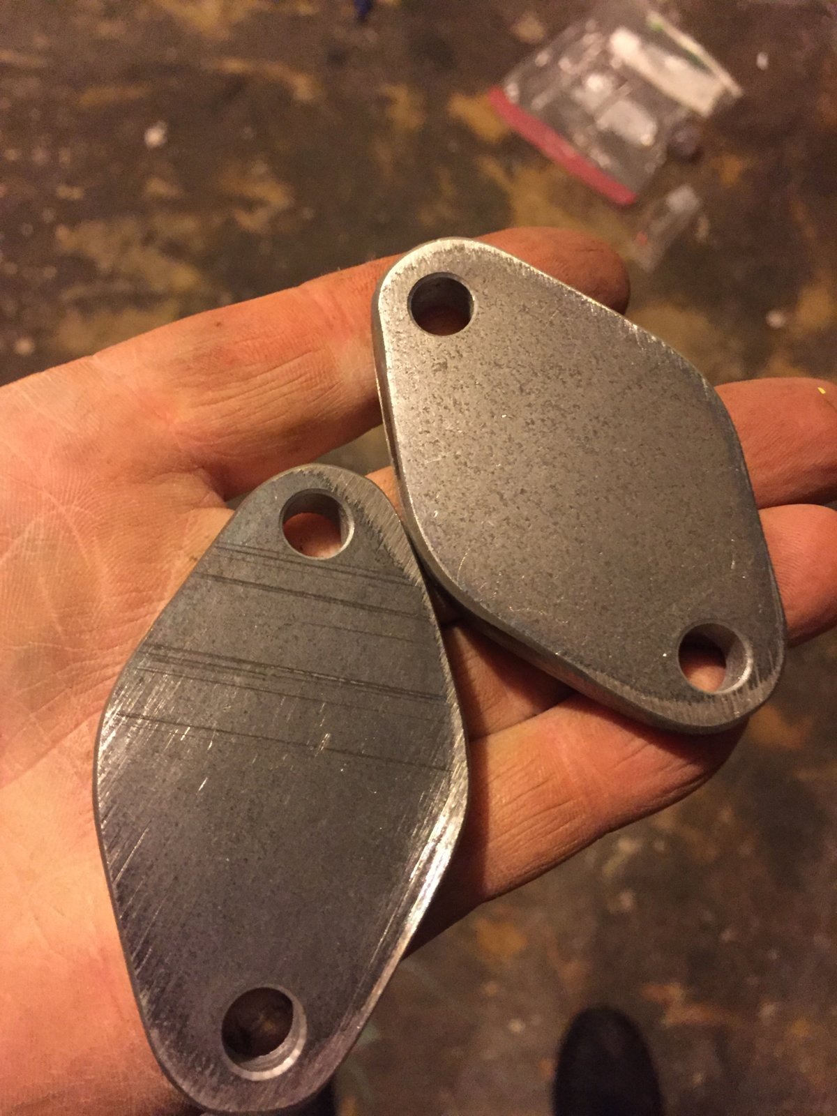

I bought the eBay ones for $28. Haven’t arrived yet, will let you know how install goes. I have a EGR delete tune by the way. These plates were all I needed.

I got the plates this evening. The seller shipped them out right away which was nice. The plates are made from 3/8 rolled steel, not 1/4
I can tell they’re being made by some guy in his shop. But they look well machined. I’ll let you know how they go on.

BTW I offered the seller 26 bucks and he accepted that. It's a perfectly far price do I don't suggest low balling him.

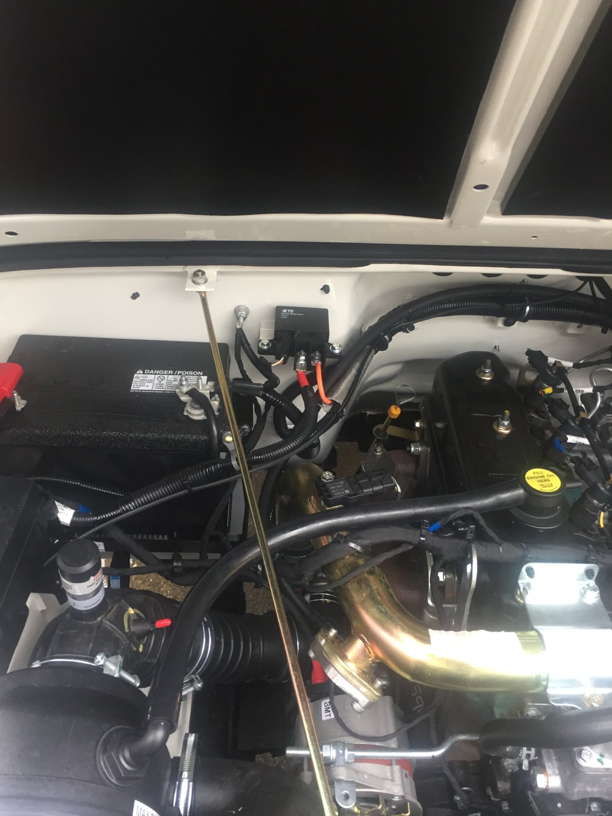

I finished installing my plates this weekend. The procedure took less than an hour. The plates worked perfect and I have no concerns. I bought some caps for the vacuum holes on the air filter hose and the back of the alternator. I also used a 5/8 coupler and spliced the 2 heater hoses that originally connected to the egr cooler. That splice will come in handy later when I install a cab heater. All together I'm into the egr delete project just $30.00
