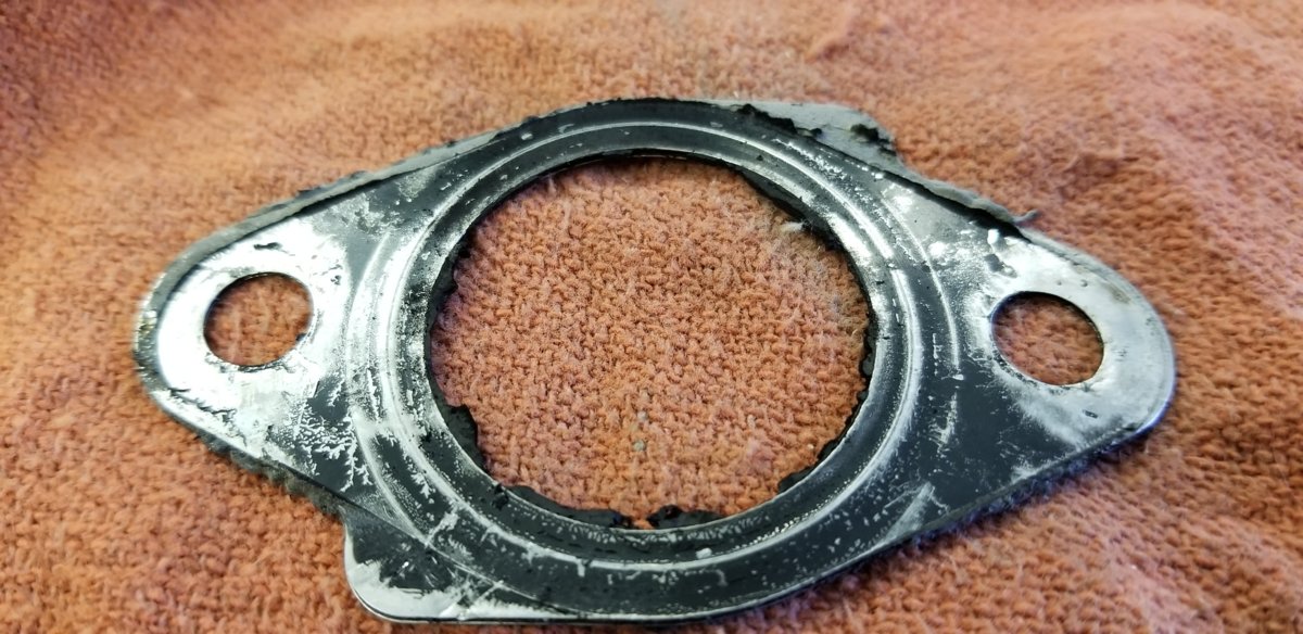

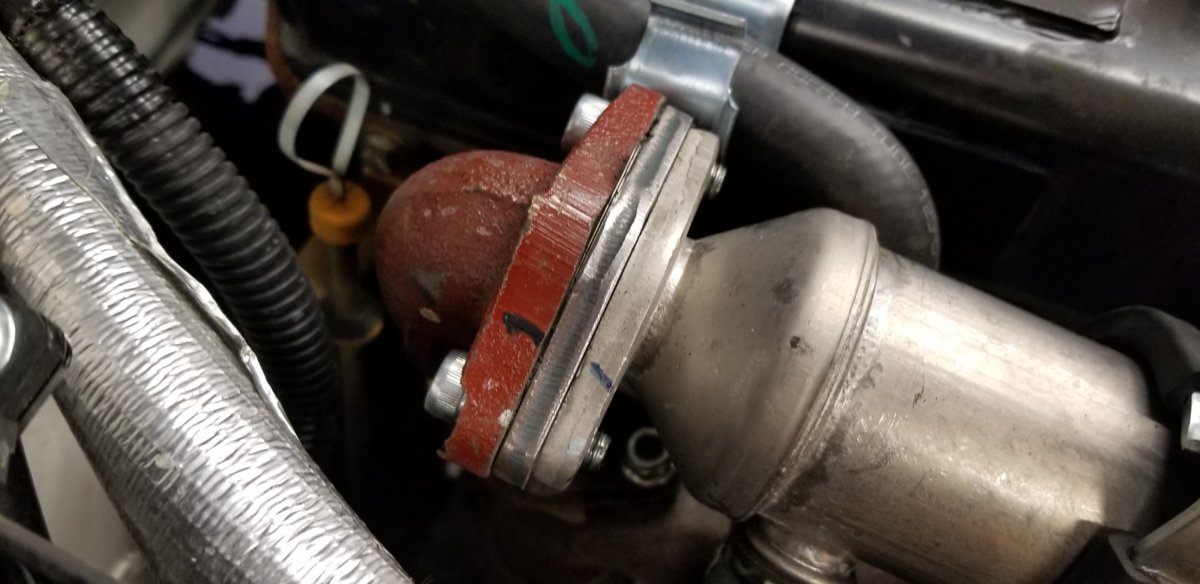

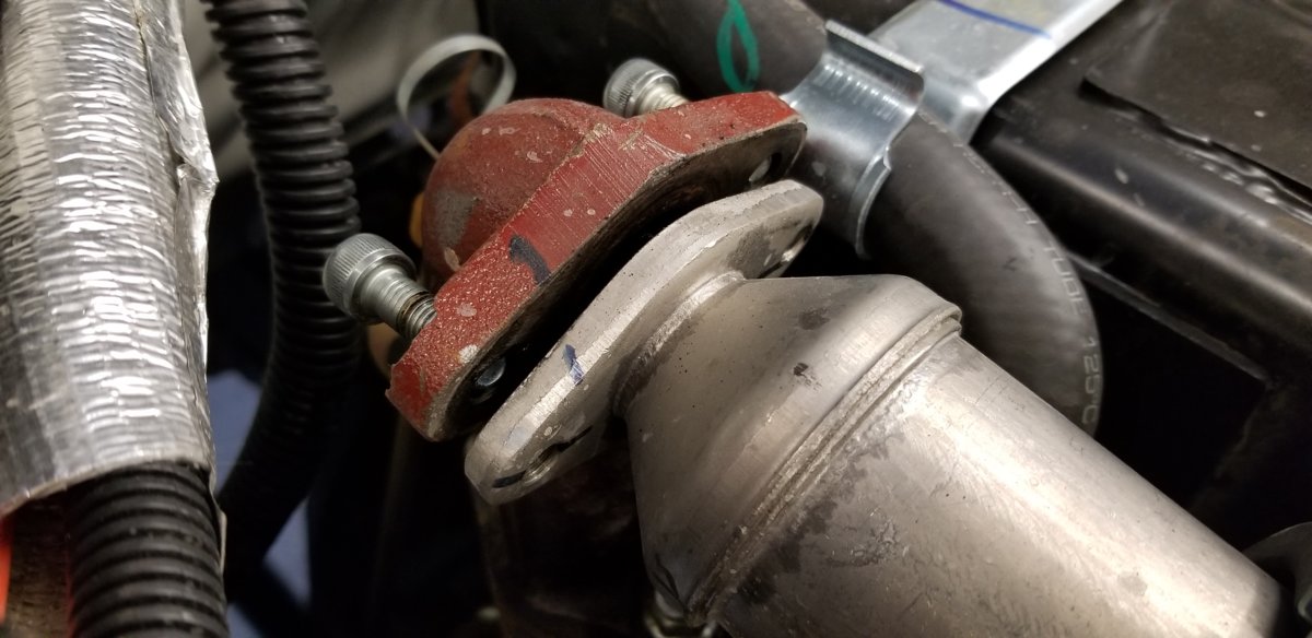

I finished the egr block off but had a check engine light. I still have the stock ecu. Removed the sensor from the top of the valve as suggested, and plugged it back in. Still had the light. Clearing the 405 code didn't help. Took a 1" pvc glue on cap, cut it approximately in half, and taped it tight to the sensor thereby depressing the plunger. This will also prevent anything from getting in the sensor. Plugged the sensor back in but still had the check engine light. Cleared the 405 code and no more check engine light. Been a couple of days now and still no light. Appears like this worked!
