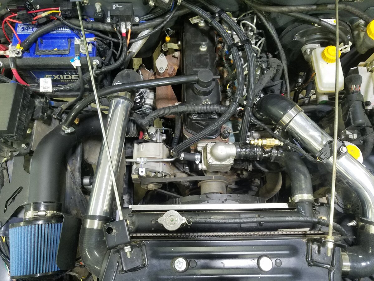

Where exactly did you install the pyro for the Edge monitor? Could you post a picture, please?I am still using edge along with a complete set of gauges, the only thing I cant read on the edge is oil pressure,, speed rpm ect egt intake temp boost and others work fine

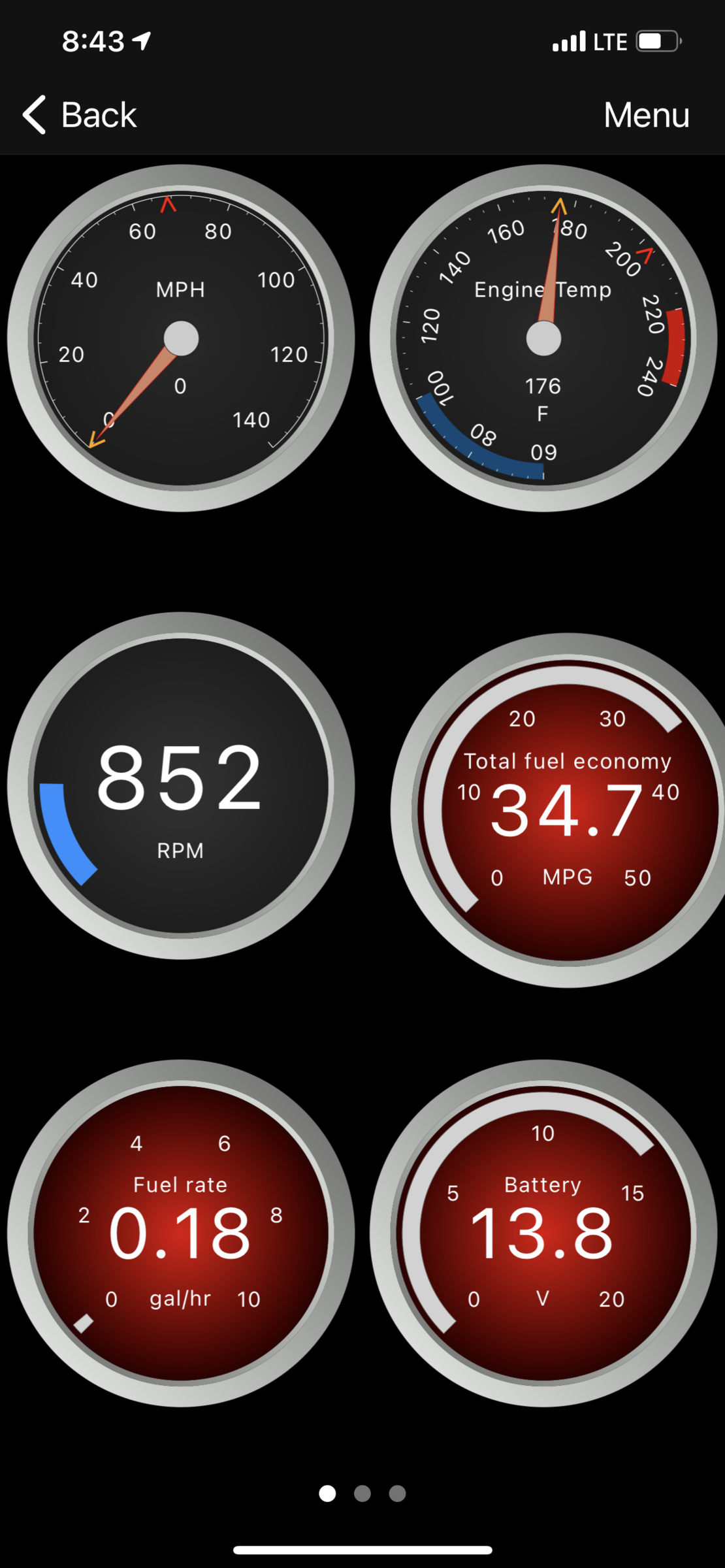

Awesome! I moved some gauges around. I love it!I followed PineCreek and bought the VeePeak Bluetooth plug-in and Dirt Legal OBD II adapter.

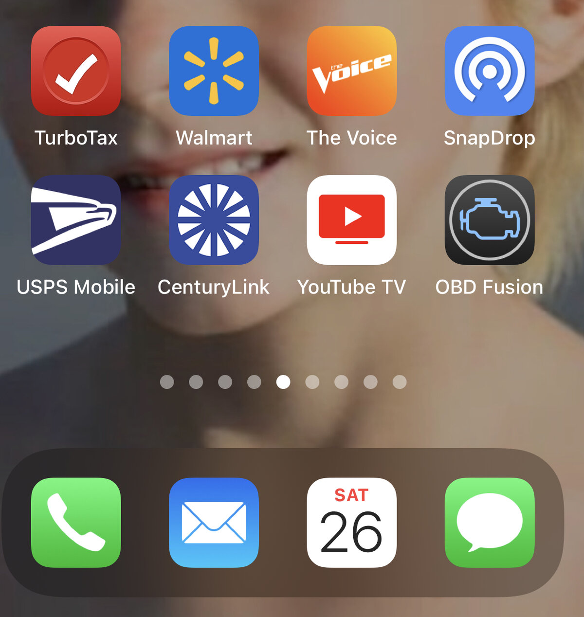

I am using one of the aps VeePeak recommends (called "CarScanner", a free version).
Tried it finally today. Works.

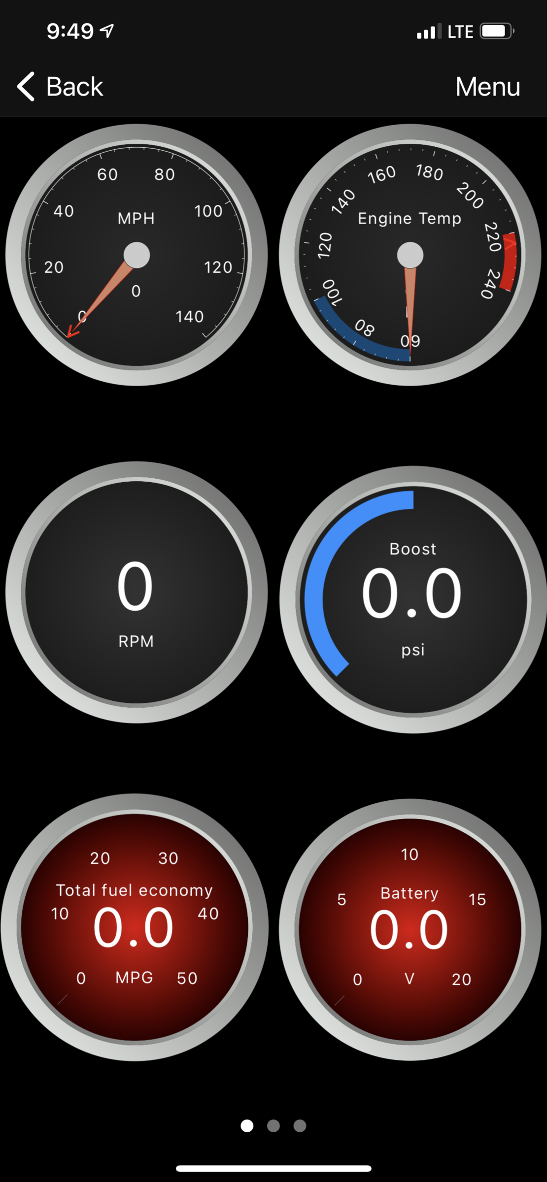

On my (Android) phone, I can read: RPM, speed, distance travelled, coolant temp, fuel consumption (current, average, rtc), battery voltage.
There is a menu for more sensor readings. I am sure not all of them are on the Roxor's OBD II CAN bus. I will play around and update later.
