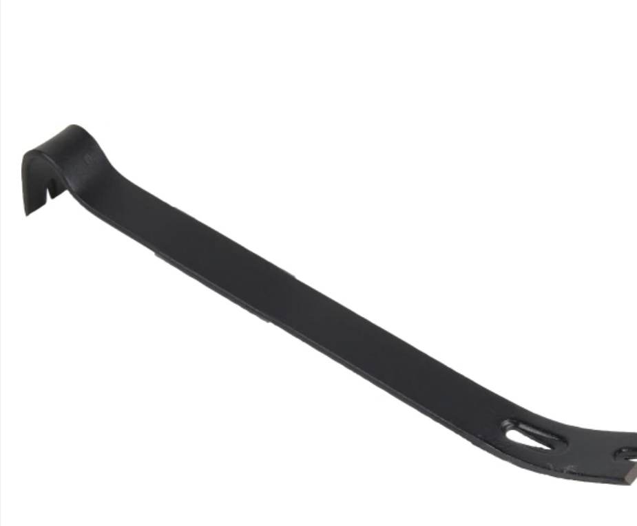

Those are nasty to get off ! I ended up using a pry bar like this to work it all the way around bit by bit until it came loose. I ended up not reusing them because I put a set of Mile Marker locking hubs on.

I used one of those pry bars and even took out the bolts to get a better bite.. but it just bends the lip. Finally I squirted a bit of penetrating spray around the area so will see what happens . I have some Warn hubs I bought to use right when I got the Roxor but have yet to put the on. Every time that I've gotten stuck this year, I could feel myself sinking and had no time to lock those kind of hubs. Is it true that you can't grease the locking hubs because too much grease in them is a bad thing ? Thanks for the reply.
