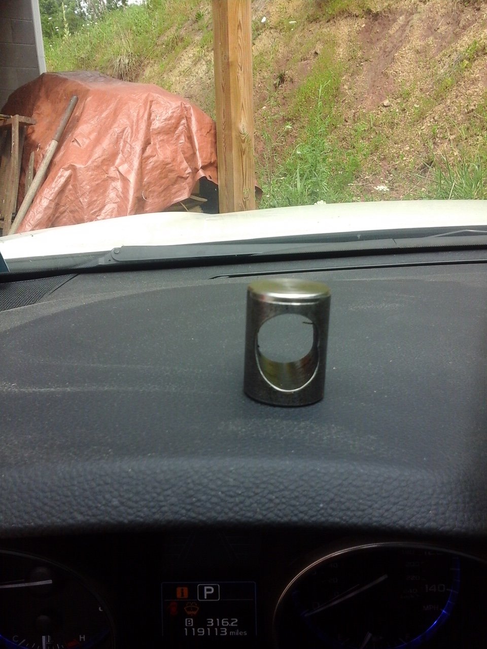

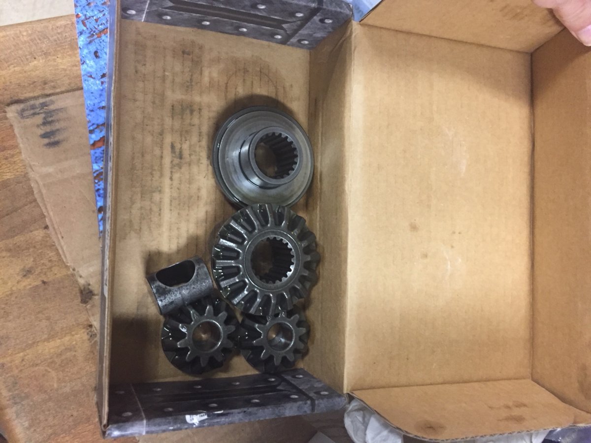

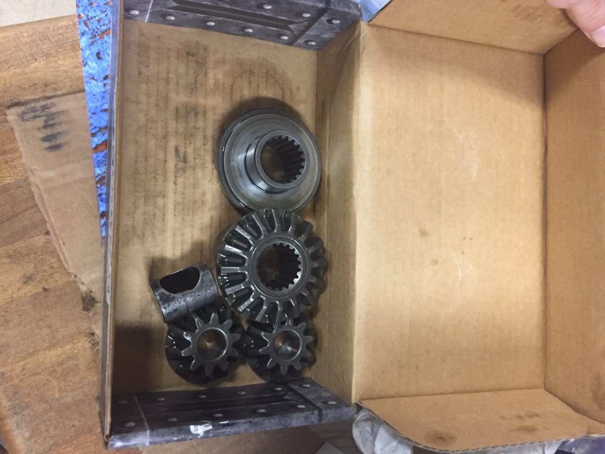

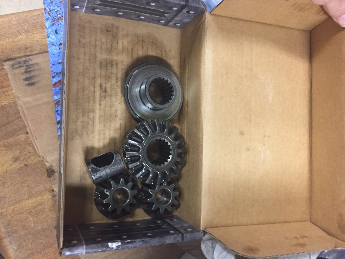

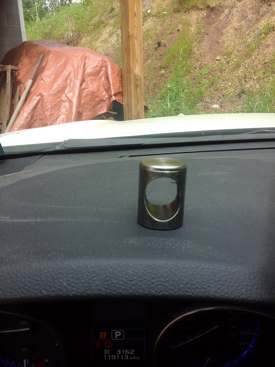

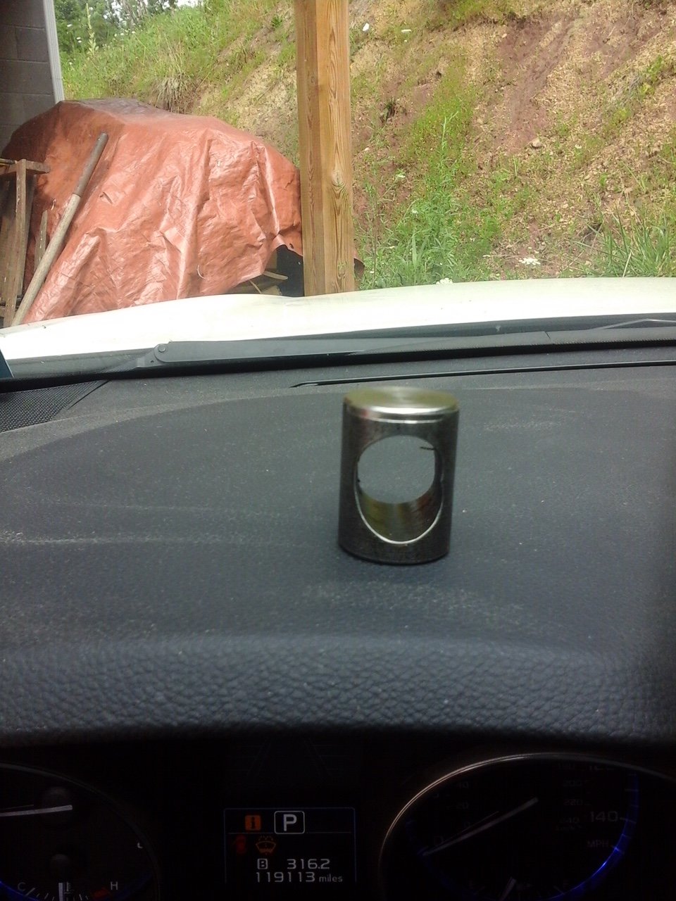

is the spacer a new part that comes with the locker? or more likely something Ill find when I take the spider gears out?
The spacer comes out with the factory spider gears. Apparently it is a rarely used part. Most mechanics will not think it should go back in as the Spartan instructions say "remove all parts from inside factory carrier."
Peder53
Dec 6, 2018
39
Spring Valley, WI, USA
2187
Thanks for this info, my set showed up today, ordered from Amazon
