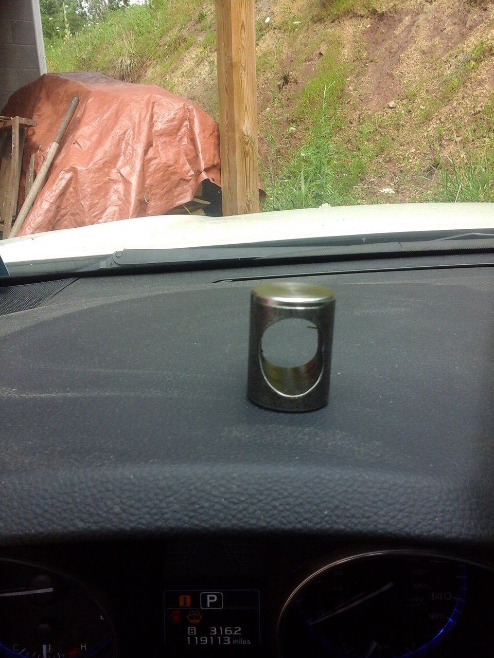

Which is correct for the Roxor,19 spline?
Yes that is it.
Make sure whoever installs it puts the cylinder shaped "spacer" back in that the cross pin goes thru. This keeps the axle shafts at proper spec.

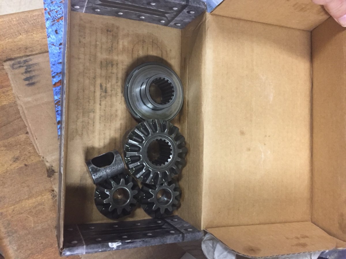

Spartan Locker for Dana 44 differential with 19 spline axles, includes heavy-duty cross pin shaft
by Spartan Locker
Be the first to review this item
| 4 answered questions
Price:$237.80
This is the right one, I just put two of these in. Take note of the pictures above the spacer in the second one has to be installed in the spartan locker. To hold the two Spartan spacers in place, partially install the cross pin but not far enough to block your view as you look through the hole for the axles. than love tap the axle spacer in until the cross pin can go through it.
