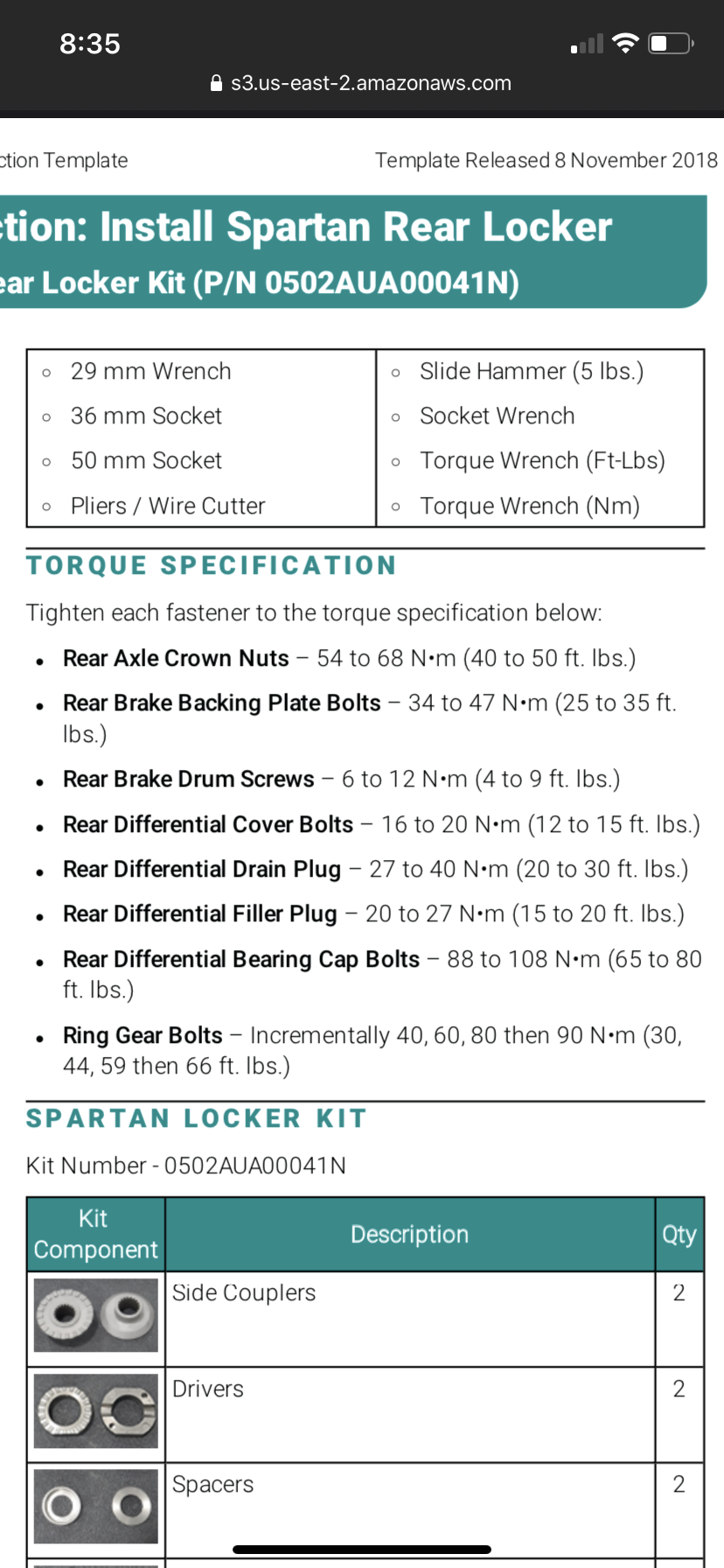

Is there anyone that could tell me what the torque specs are?
B BOGGER Member Joined May 1, 2020 Messages 62 Points 8 Location South florida Roxor Ownership Roxor Owner May 2, 2020 #1 Is there anyone that could tell me what the torque specs are?
75f250 Member Joined Nov 15, 2018 Messages 61 Points 18 Location Slave Lake, AB, Canada Roxor Ownership Roxor Owner Roxor # 2196 May 2, 2020 #2 right off Mahindra’s accessories page
