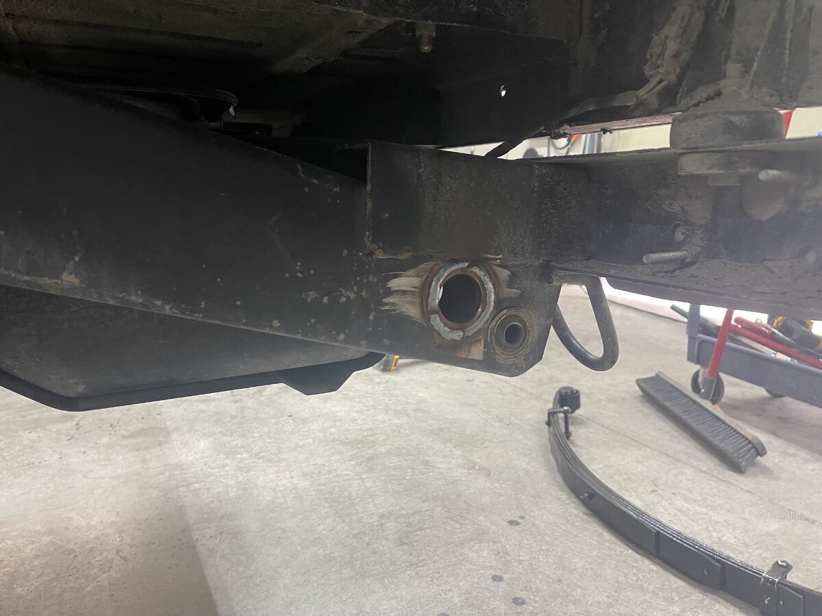

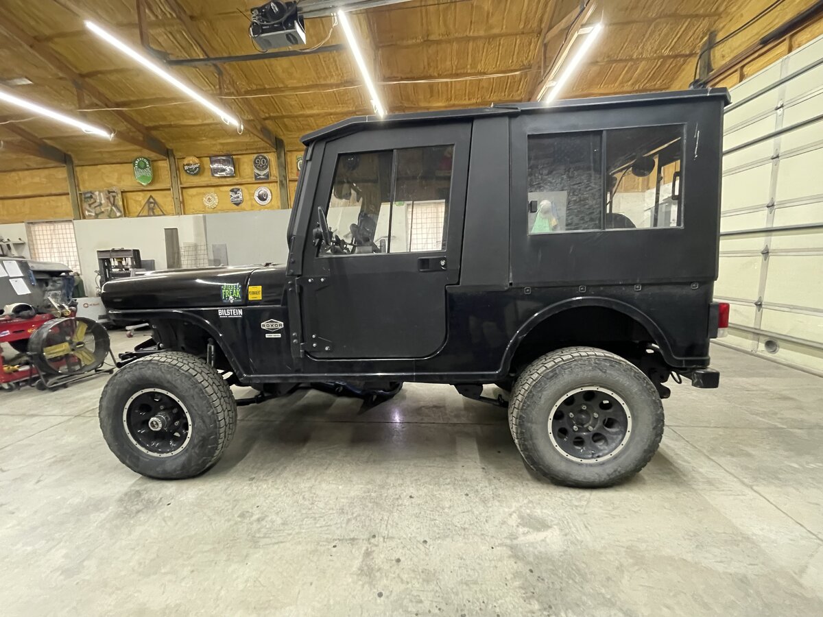

I bought a long travel kit last year and am finally getting around to installing it. I did the front today but have a question on the back. I’m using the RE1430 2.5 springs and I have a full hard cabs cab. Would I benefit from from moving the rear shackle location due to the heavy weight of the full cab? I’ve seen that change mentioned adjust payload in the forum.

Common question! mount the rear bushing sleeve in the frame leaving about a 1/4 of an inch between the old bushing sleeve and the new one. Similar to the picture in the directions.
