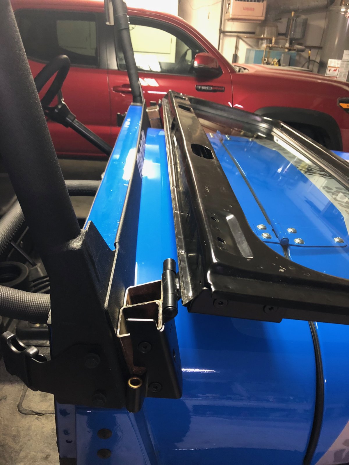

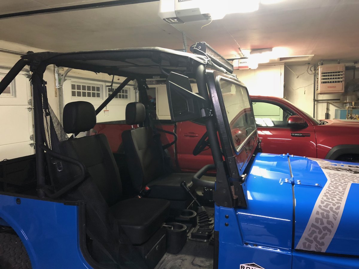

76-86 CJ Windshield - Kept factory roll cage - shimmed out windshield with 2" square tubing - fits perfect.
View attachment 1512View attachment 1513
Great idea! Would you please provide detailed instructions on how you did this?
I can give you detailed instructions on my gauge install. LOL Water Temp, Oil Pressure and Volts.
Each mount consists of two pieces of 2" square tubing cut to match the shape of the bracket and are welded together. The side holes go through just the one wall of tubing and the front holes are drilled all the way through both sides of tubing. I used the factory bolts for attaching the bracket to the Roxor and used the windshield screws with nuts for attaching the bracket to the tubing. However I may change to using a longer bolt and run it all the way through the bracket/tubing to the Roxor in the future.
To help with air movement I have since attached the cowl seal to the bottom of the window frame and it seals against the Mahindra Cowl eliminating any gap in the bottom.
How does the interior windsheild brackets mount? Do you have them mounted through the Mahindra Cowl? Also can you post a few more pics please lol i want to order up the parts.
