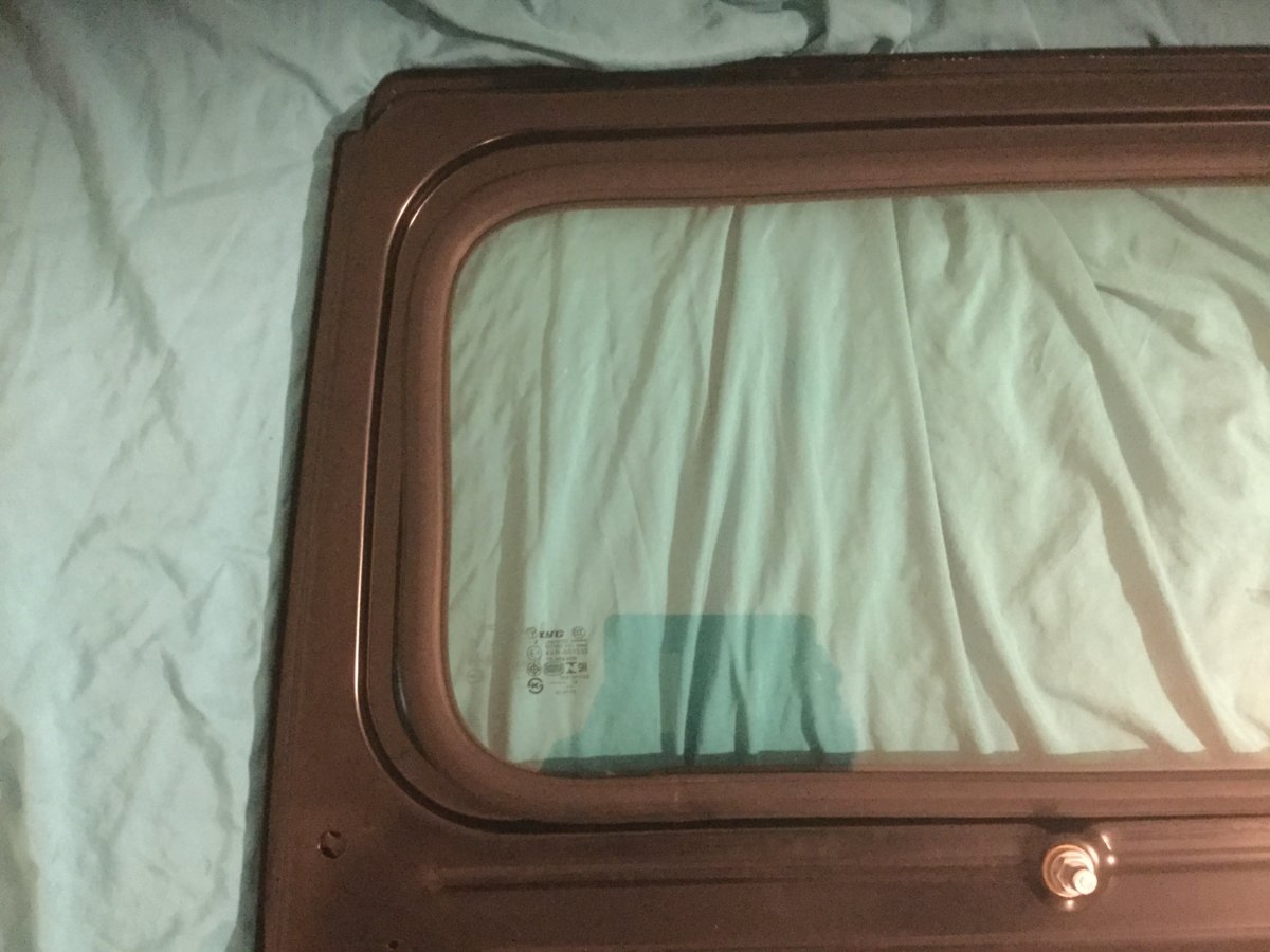

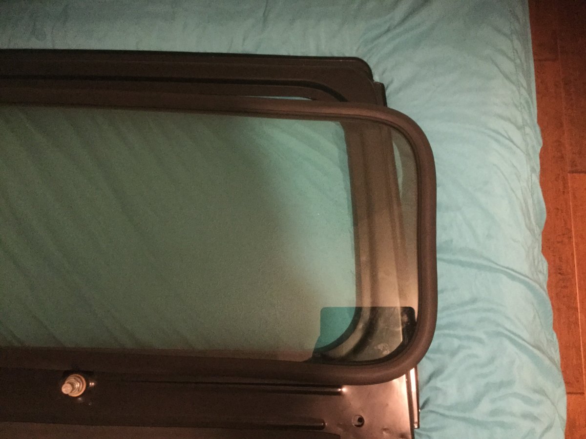

I bought CJ-7 winshield and Glass but the glass in narrrower and longer. I purchased the glass a month ago and finally opened it today. I dont think I can return it. How do I specify the glass I need without ordering this one again? when you buy the glass they usually dont talk about width and length. Anyone had the same issue?

Wow, that's like 4 inches off. Double check your order. Also double check the inventory number of the glass from the packaging. One of those is likely incorrect. At least if they sent you one you didn't order then you could get the one you did order. It looks like a Wrangler windshield.

I think its a CJ-6. But apparently I can return it and ordered one with the measurements of 16x54 inches which seems just about right.

I returned the glass today. I think they sent me a CJ6 glass, the glass I need needs to be 16x54 inches, which I ordered today. Thank you so much for your research and input, I didnt know that this could get so complicated.
