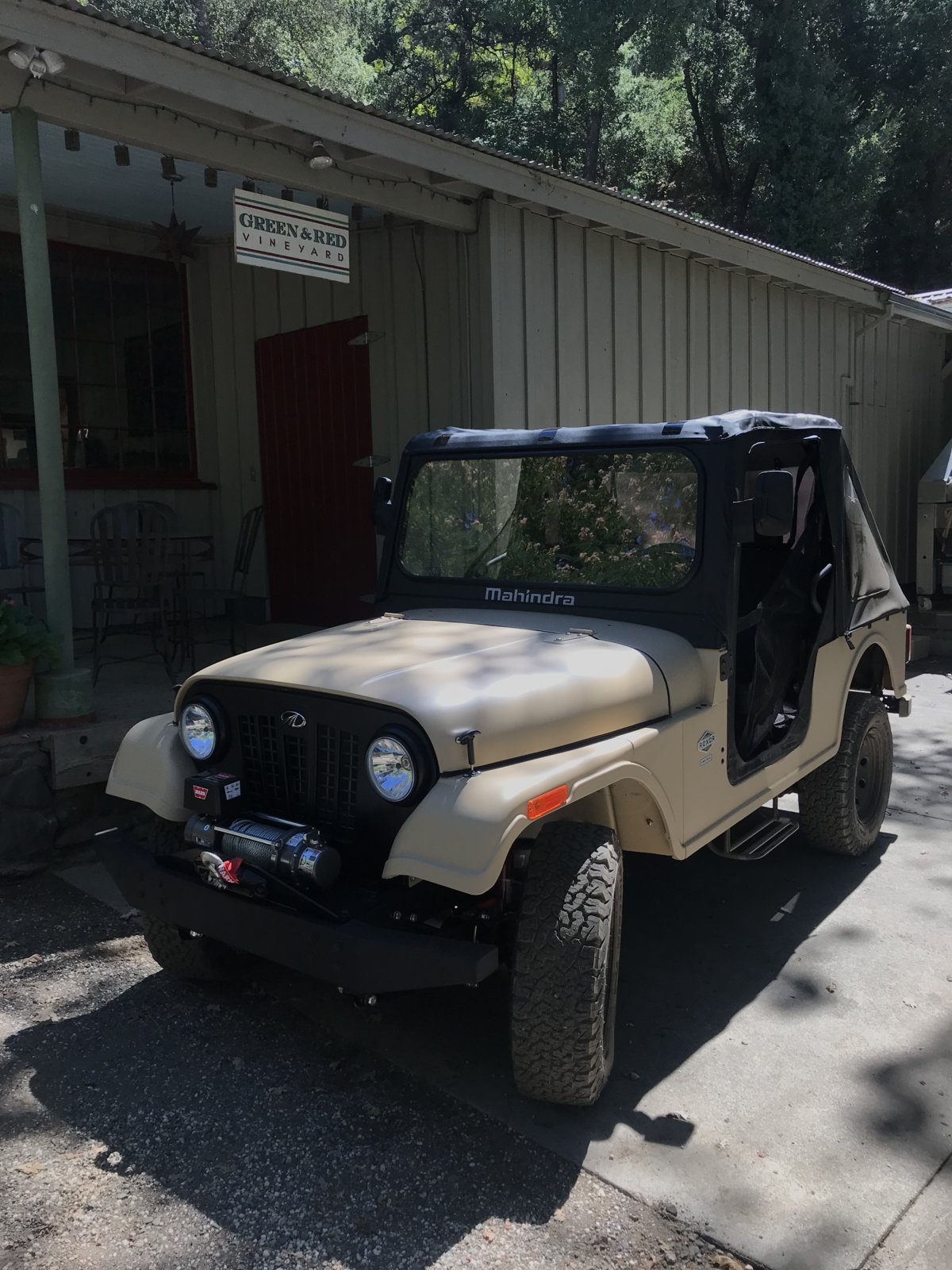

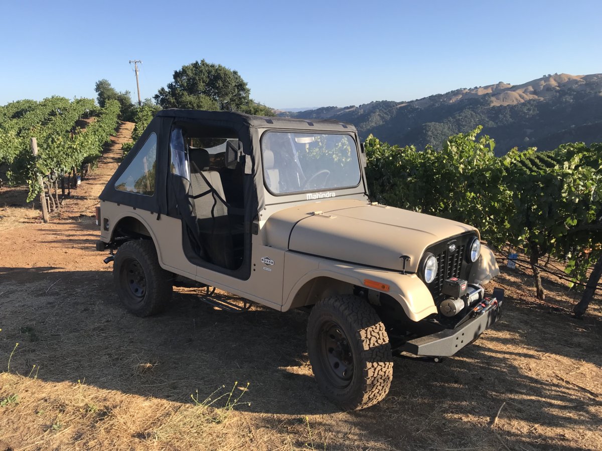

Phew, I thought it was me! Brand new ROXOR and that transfer case wont budge. We got it into 4L, but then cannot get it back the other way. I was just about to post a new thread. I will try this, meanwhile a few pictures of our new Vineyard worker in Napa Valley...
