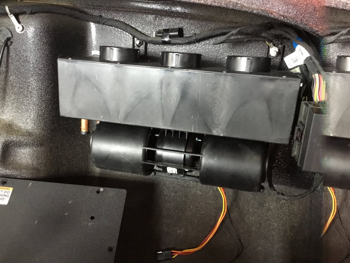

The Jegs heater gives a lot more value than any other from whit I see. First it has 2 full size motors , 2 speed fan operation. Second it remains under the dash and is hardly visible ., no floor space needed. Third by using the directional duct vents you can have better heat distribution. Fourth , more for less 200.00 gets 32000 btu, half the price of the other units.

That only has one motor. The motor is in the middle and the 2 on the outside are the squirrel cage fans.

sorry , bad choice of words. In a lesser way the Jegs heater has 3 speeds ( that’s stop,low , and high ) also 300 CFM and 40,000 btu which is overkill for that little diesel. The cfm works well with the ducted 3 outlets, and the duel cage fans.

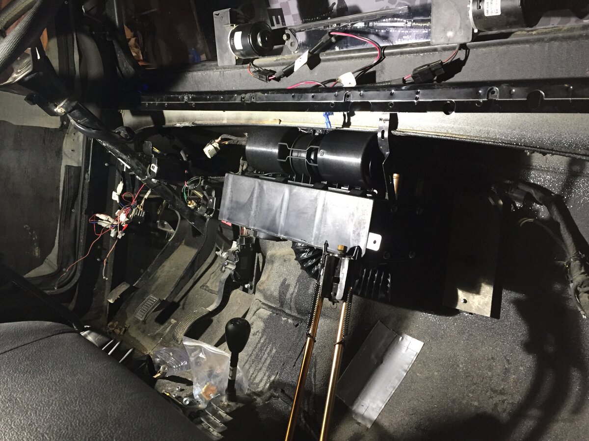

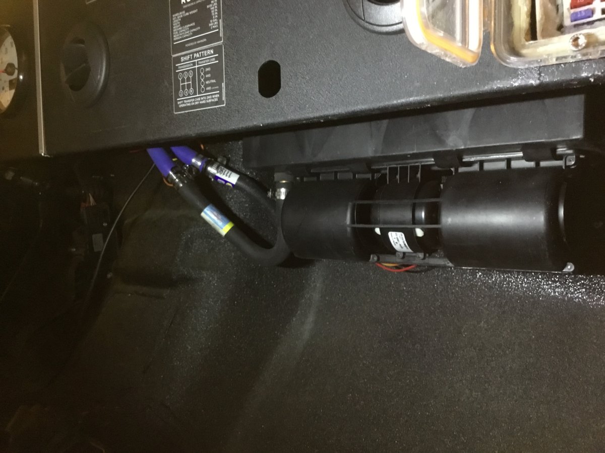

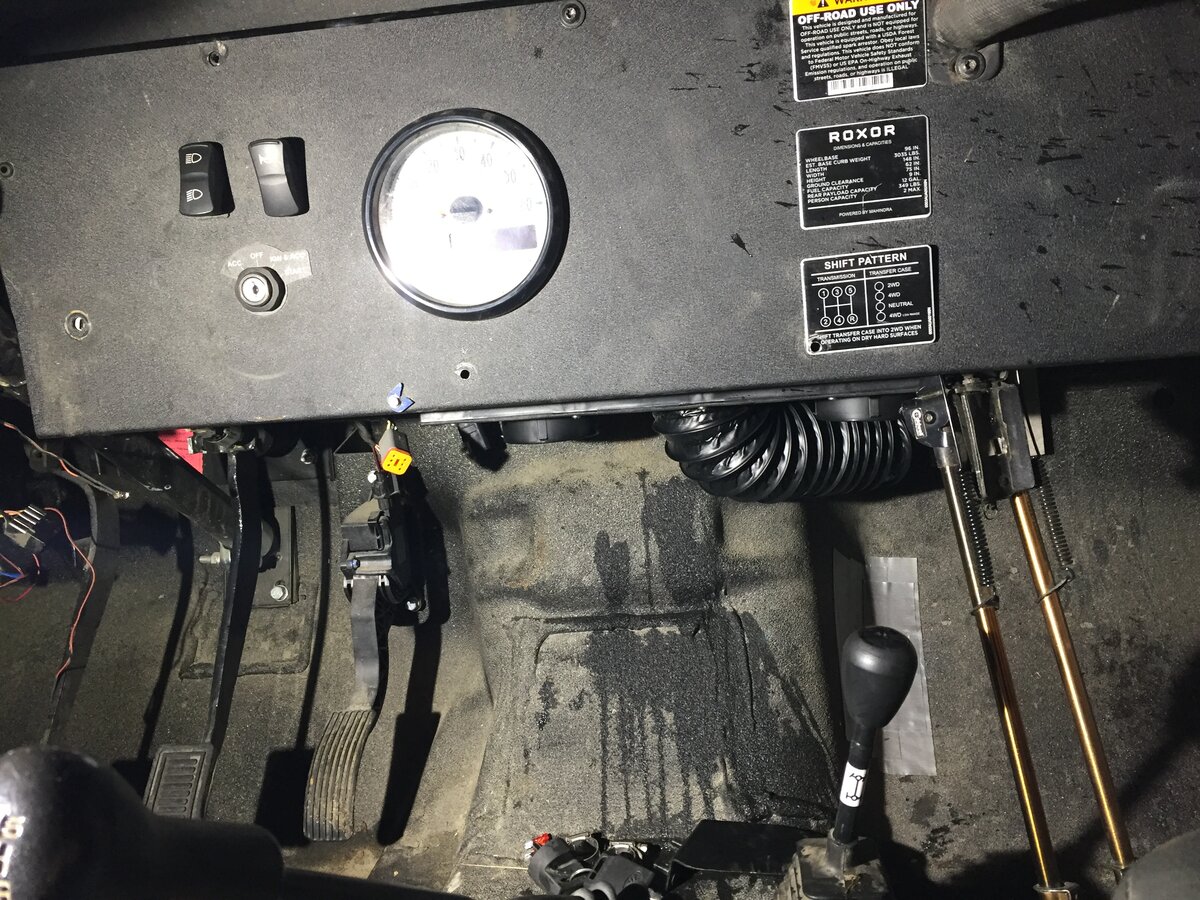

Trying a slightly different way of mounting the jegs 300CFM marine heater. I cannot wait to get rid of my single speed loud ass fan. I’ll have to come in with heater hoses in a new spot
