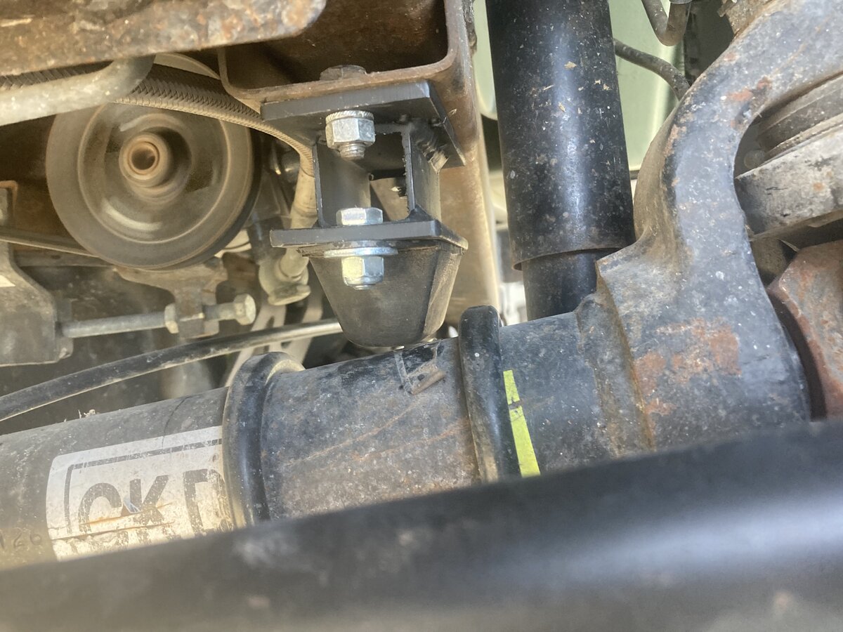

Lower your bump stops instead.

Thought of that but I did have a brief discussion with Max and and I will try the add a leaf as I can do all four corners for about $125. In our discussion we talked about the OEM springs being softer than spring with lift. The Roxor is heavier than a YJ so springs are probably compressing to a greater degree than springs with lift. This may explain why the lift height with the long travel kit was lower than the Climax front and rear shackle lift also purchased from Max.
