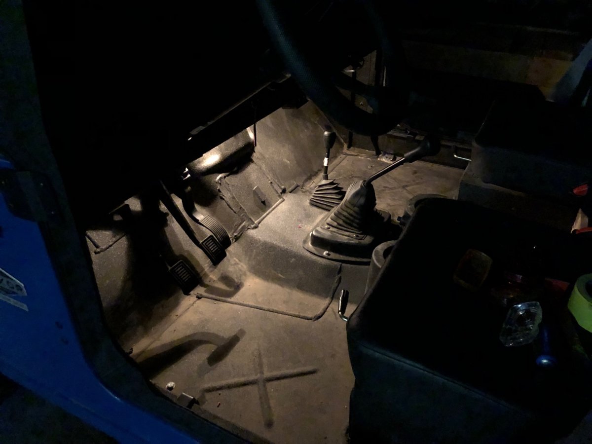

Auxiliary fuse box.
Woodsman74881
Sep 25, 2018
313
Wellston, OK, USA
000992
Can’t remember. I’ll look tomorrow. I’ve found everything on mine to primarily be 8,10,12mm thread size. I went to tractor supply and bought an assortment of bolts, washers and nuts. That has been helpful. They sell them by the pound for reasonable.
UrRoxOff
Oct 24, 2019
4
Murica
M8-1.25 in case anyone else was needing that thread type info
821
Joe Roberts
Oct 22, 2018
26
Ishpeming, Mi
354

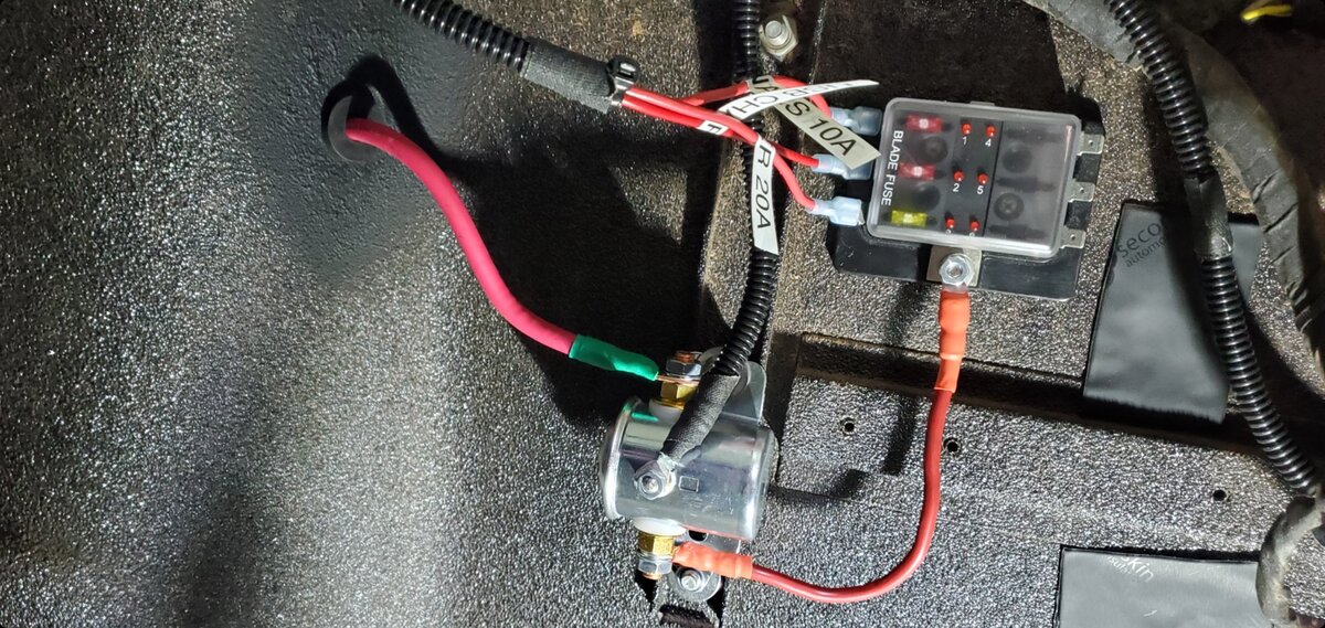

I did the same. 50amp breaker at the battery, keyed power through a continuous duty solenoid to the fuse block.
