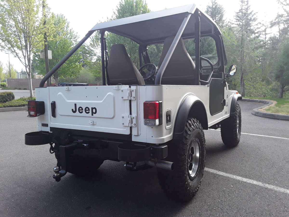

Heres a strongmade hitch alot better spread bolt pattern than OEM. The mount to the frame set up you would need I think for the 3500 lb. Tow rating

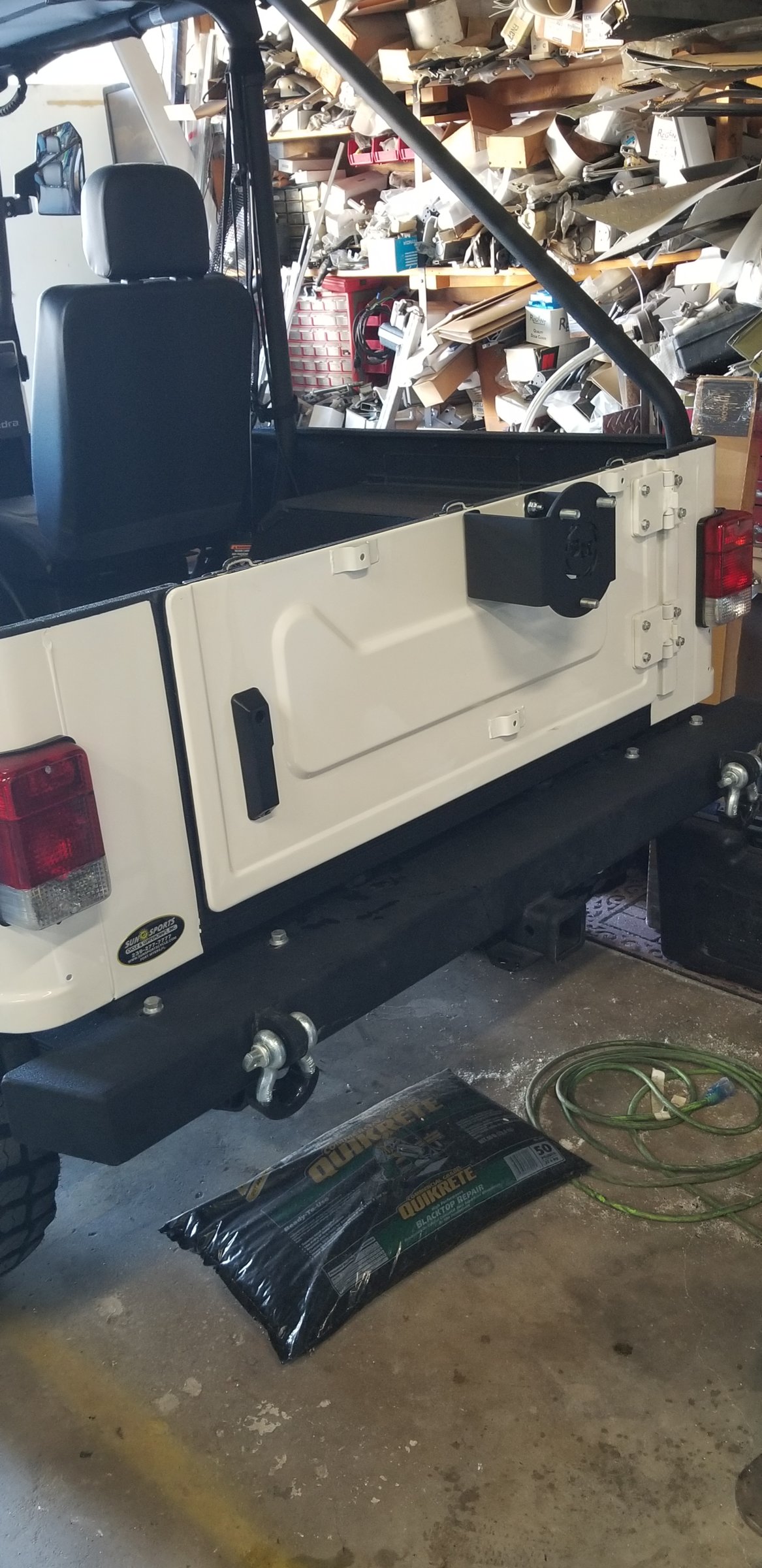

I used a Tidal Rear bumper from Ebay Item ID # 163609008725 it fit right over the stock bumper ( I removed the curved stock ends in case ) took 6 1/2" bolts four you drilled the stock bumper to put angles that hold new bumper & after there are 2 straps that you bend up to stock bumper using floor jack or similar & drill holes for two more 1/2" bolts Cost of bumper $143.99 I'll try to attach picture I put it as a picture in new people forum but I think I put to large of picture20190512_081332.jpg

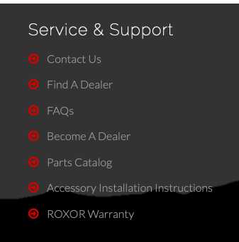

That's not a dealer portal, those instructions are listed on the regular Roxor website under "Service and Support" at the bottom. It has them for most accessories.

Go to roxoroffroad.com and scroll to the bottom, there you still see "service and support", the accessory installation listings are there, it's not a secret, your dealer is just misinformed, that's all. Not all of them are there, some might be in a dealer only portal, I don't know, I don't have access to dealer only stuff. You will also find the full parts catalog there and you can pick your dealer and order parts online and have them shipped to your dealer and pay upon pick up. FYI: Oil filters are only $6.99 in the parts book.

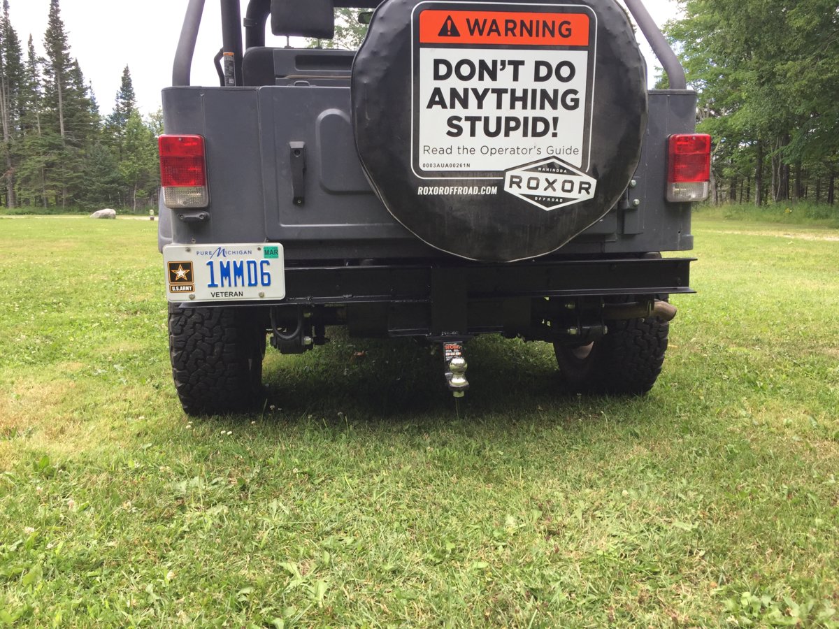

RoxorYooper
Apr 28, 2018
273
UP of Michigan
516
I originally made just the lower piece and bolted it to the center bumper section for the last year. I ended up bending my bumper because I had some pretty big trailer loads and also used the hitch to pull out downed trees. After straightening the bumper I decided to finally fab up a better version from materials I had laying around. All in all this should be much stronger and I welded the original piece to the bottom to give me a much needed lower hitching point.
