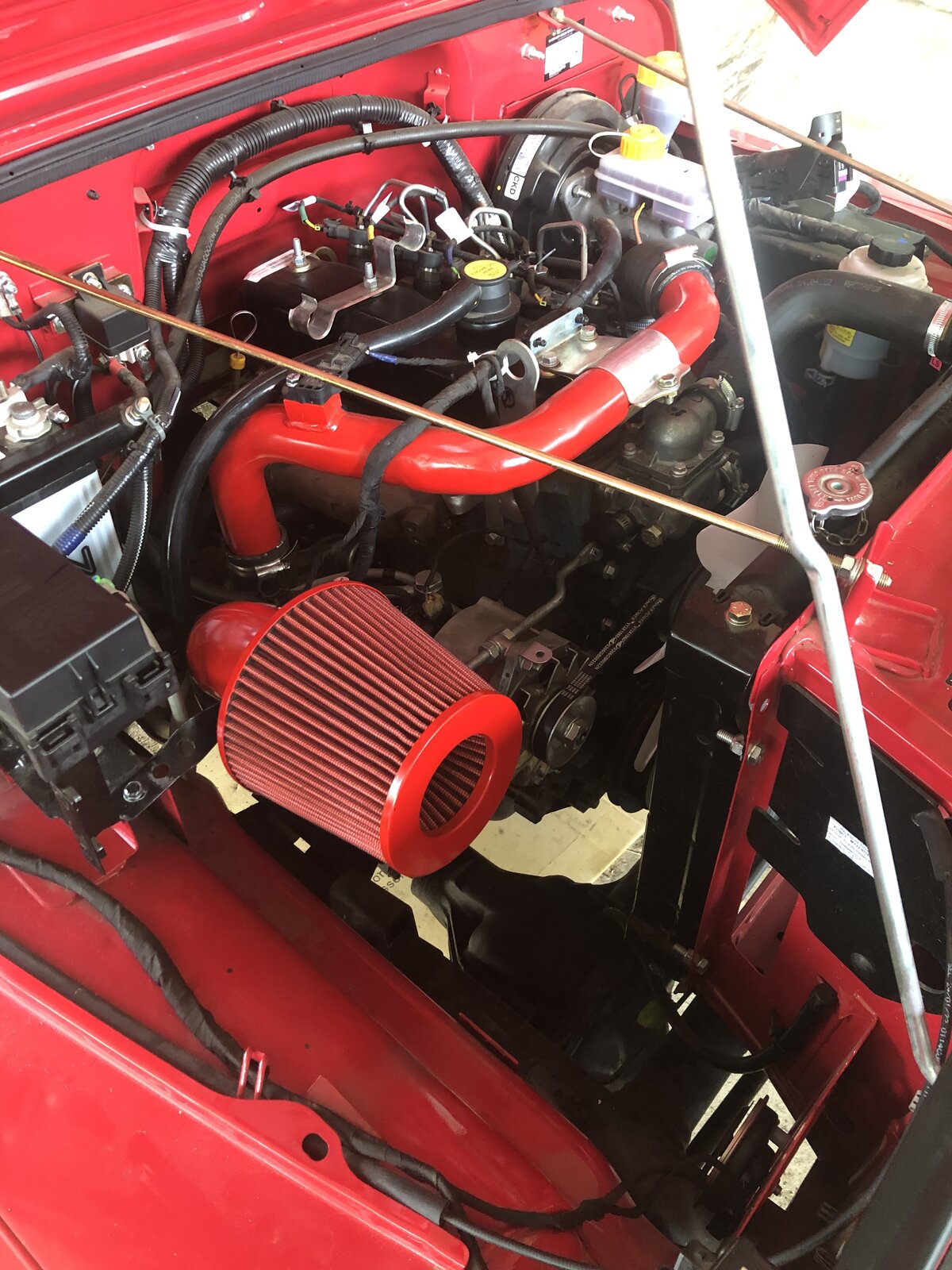

Maybe take a look at my post about a budget friendly cold air intake. You can buy the kit for around 40 bucks on eBay and it fits really well on the Roxor. The filter is cleanable :)

How's it been working? Glad someone was the tester, ill order it soon. I'll discard the filter and run a Amsoil, so if you want an Extra ill ship it to anyone at zero cost just shipping.

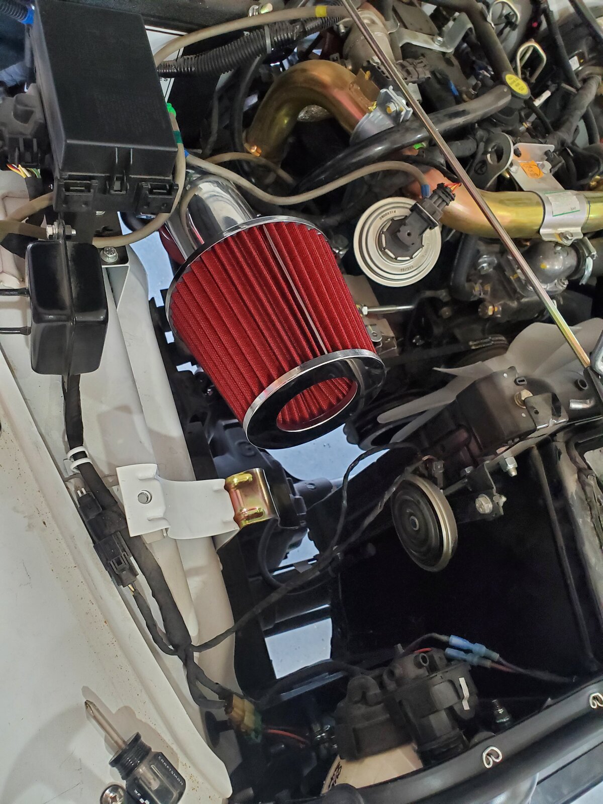

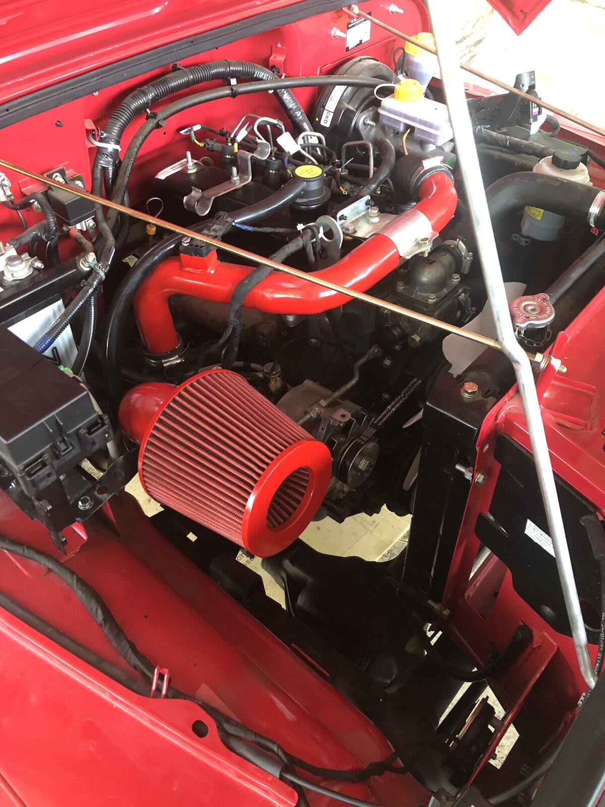

Swapped in a better quality filter. After one dusty road the tube had dist inside it. Know Idea who makes the red one but I don't trust it
822

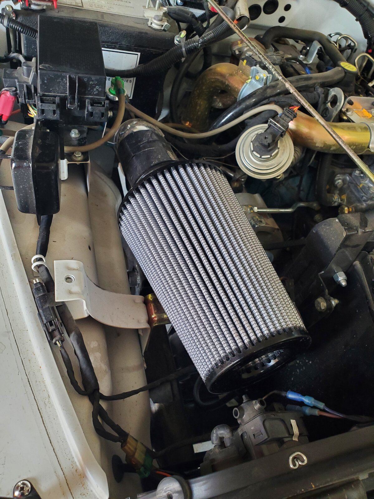

That filter that comes with that kit is horrible. I had it on for a week before the better quality filter showed up. Didn't filter alot. Ran finger inside tube and dirt on finger every swipe. I put a AFE on. It's ove 9" long and far superior to the tiny red thing

I run a amsoil cone with a pre-filter over it. Live in Utah alot of dirt roads. That pre-filter makes it easy to keep clean. 80% why oil is dirty is due to air filter ability to keep dirt out. Oil keeps the engine clean by keeping suspending dirt.

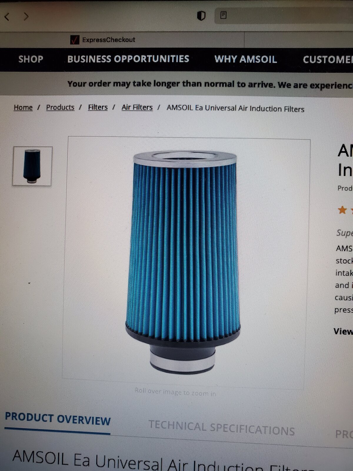

So I bought a tube that for for an 80s blazer, chucked the crappy filter if came with and bought the amsoil filter for it. Then ordered a Pre filter to cover it. I'll get a pic when I get off work.

Search budget friendly Air intake on here. That's the one I bought. Then fit a cone filter to it. No way I would use the noname filter it came with. It let alot of dirt in on the one test drive on a dirt road I took it on.
