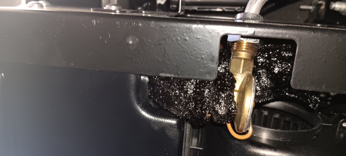

Good Afternoon All! The Part Number for the Vintage Air Expansion Valve is 33076-VUI.
This is the email from Vintage Air:
The expansion valve will be attached to the evap. unit, if you locate the smaller #6 hose running to the evaporator and follow it all the way to the evaporator the #6 hose will terminate to the expansion valve.
I looked at my unit and found the expansion valve buried in insulation material on the right side of the cab unit.
Summit Racing has the Expansion Valves for $47.99 and they are in stock. Summit Racing has a boat load of Vintage Air parts!

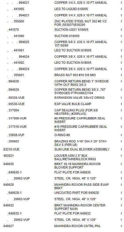

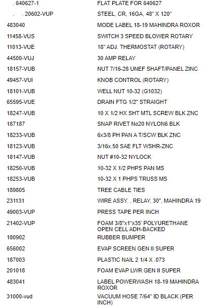

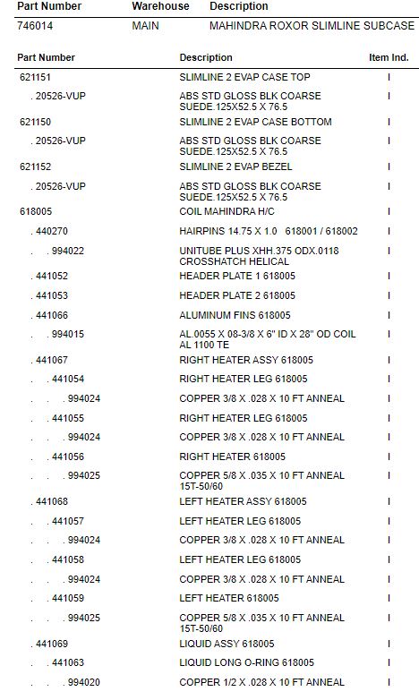

Slimline Subcase Parts List. Any indented part numbers are part of the larger component and you would need to talk to Vintage Air about any of the indented part numbers.
Sorry, these lists were sent to me as jpeg files and I did not convert them.
Interesting that I do not see the 33076-VUI Expansion Valve in the IPB list.

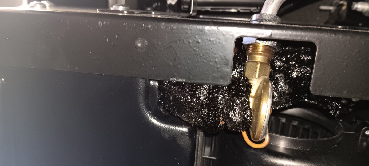

Idk, but if it has an orifice tube it should be in the line in the dryer. If it has an expansion valve, you will see it as a block type of fitting near the firewall. I will look at mine in the morning.
please post a picture of it.
I called Vintage air.
I was told none of the vintage ac units have an orifice tube.
Greg, look up a few blocks. There is a picture of the expansion valve on the Vintage Air Slim Line unit. It is on the right side of the unit as you are sitting in the passenger's seat. That photo is of my expansion valve. You are correct, no orifice tube. Vintage Air uses expansion valves.
