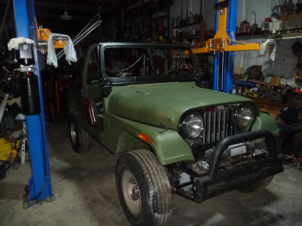

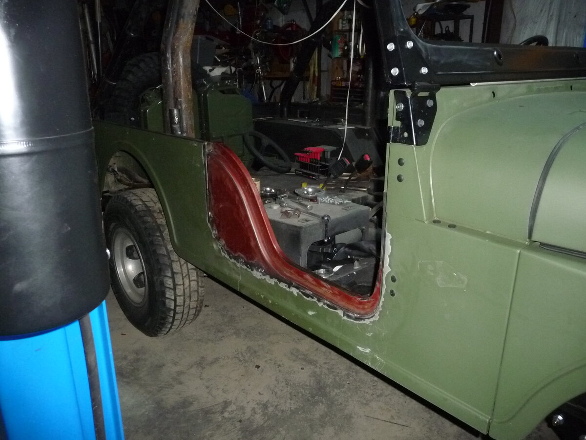

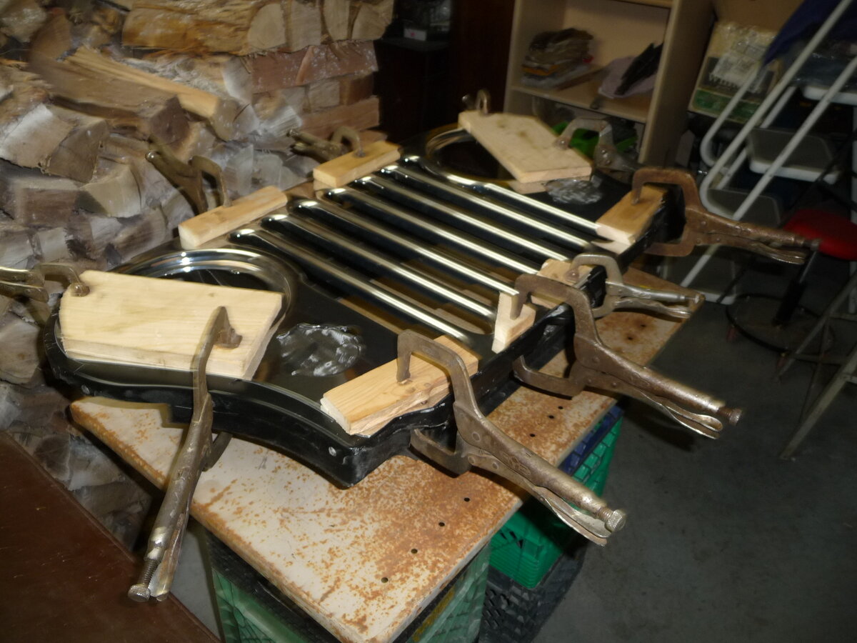

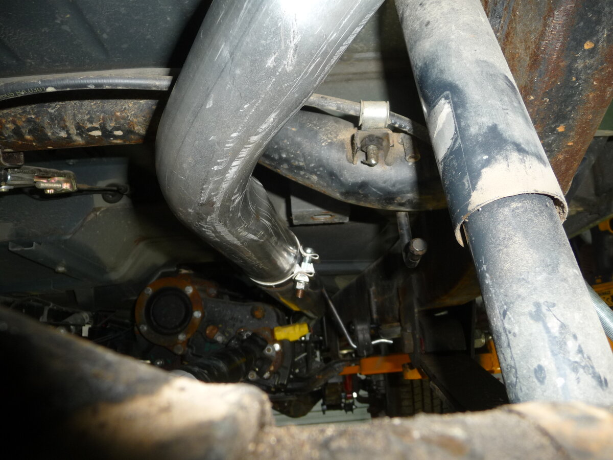

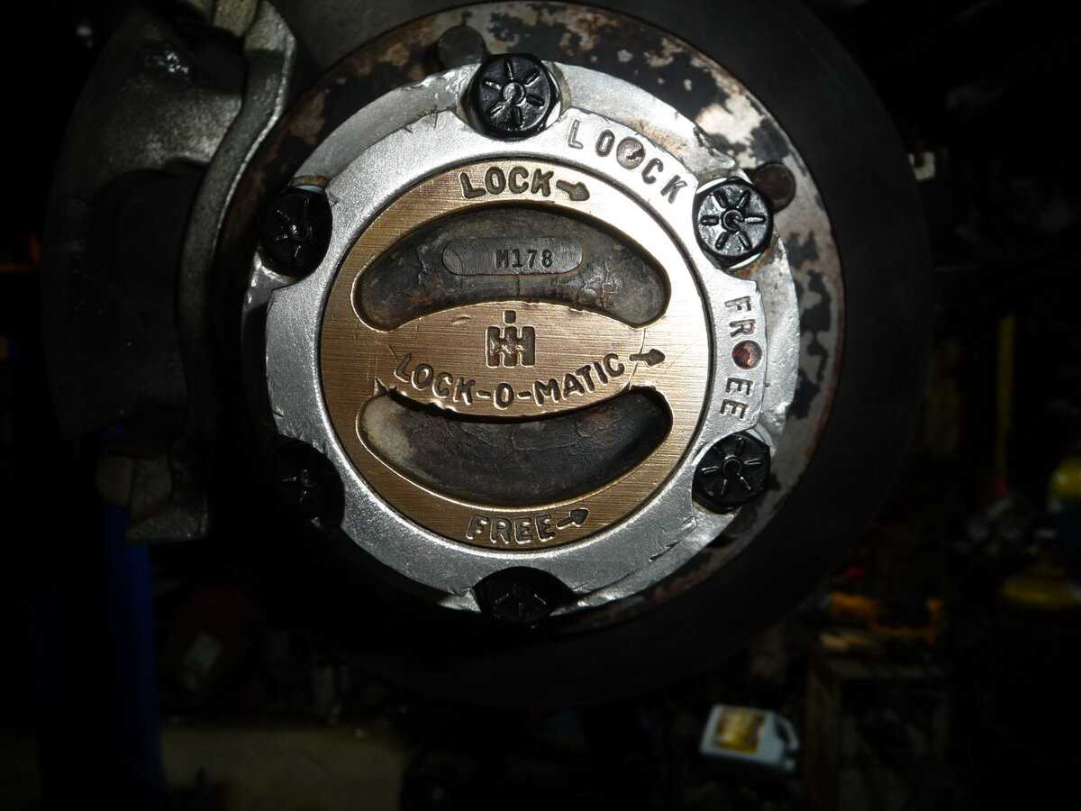

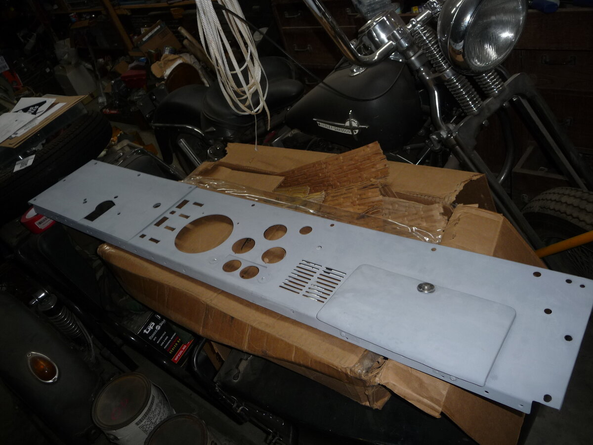

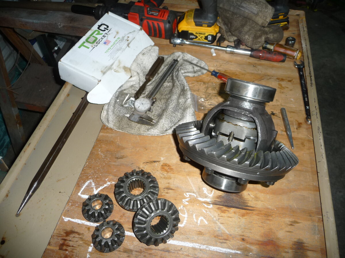

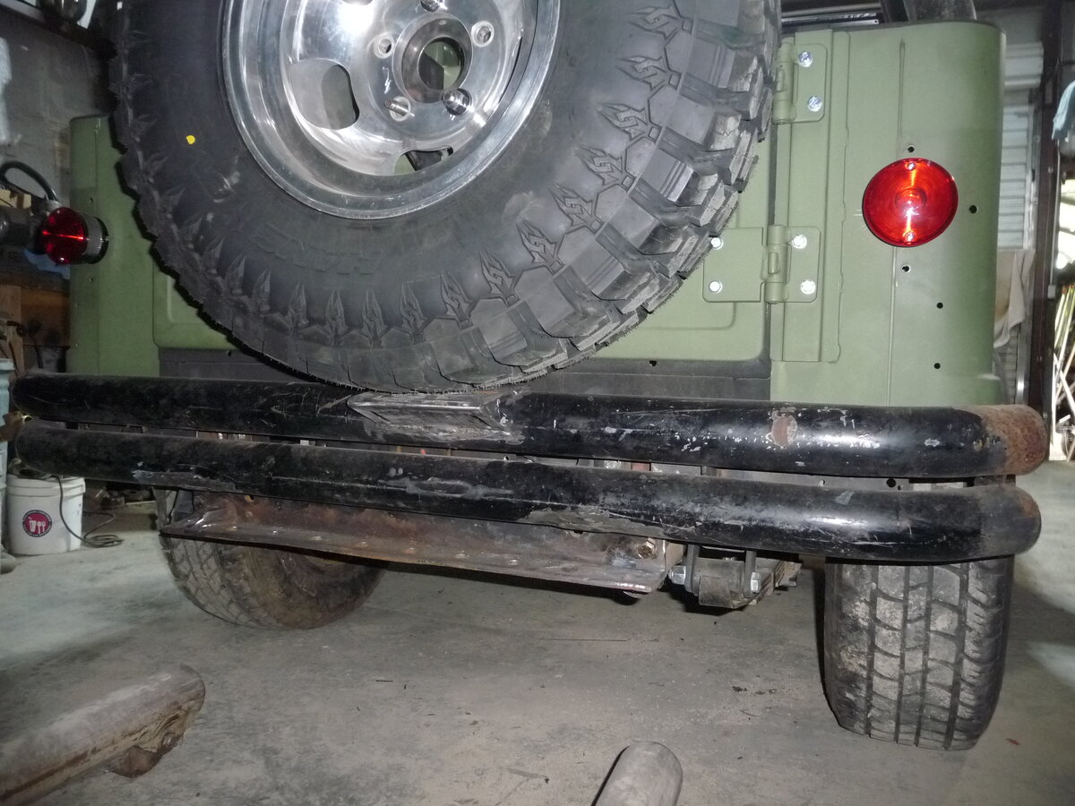

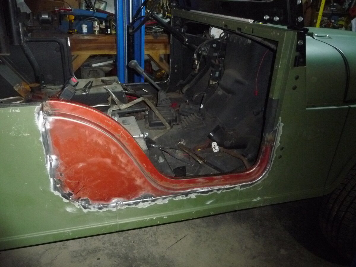

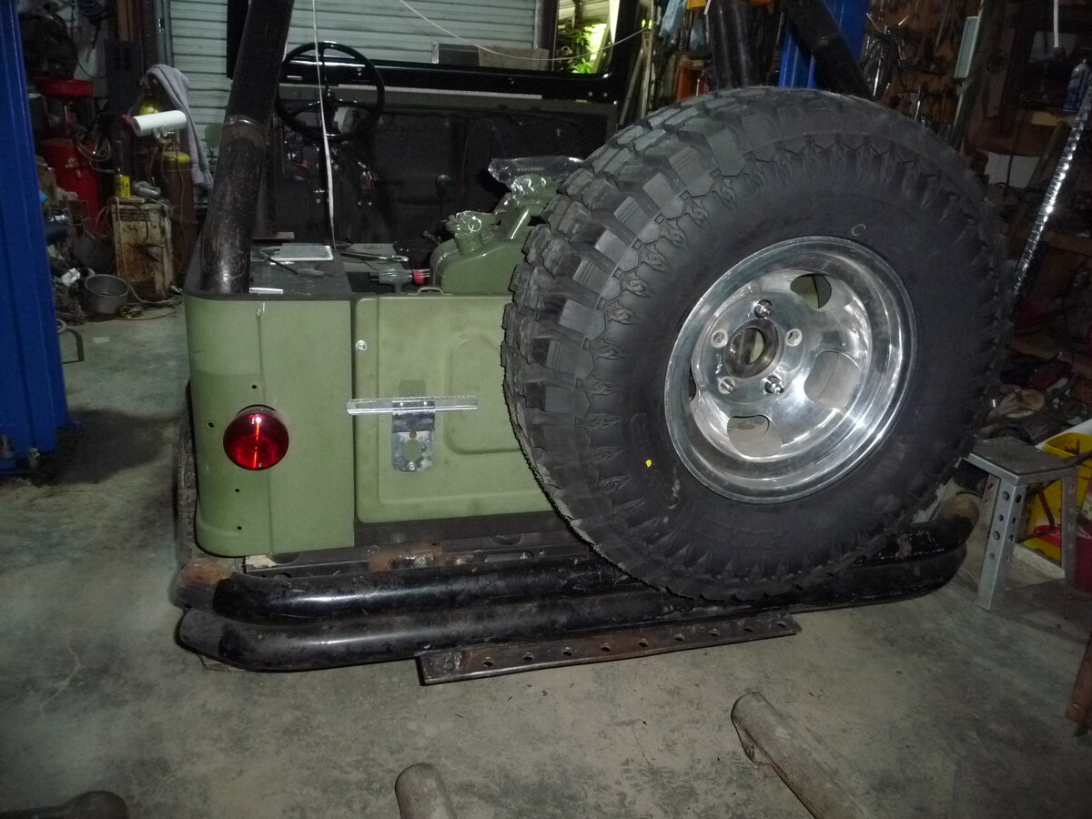

Howdy, I'm new to the Roxor but not to Willys/Jeep, I have several. I traded some Silver and Gold for this 2018 with 1200 miles a few months ago, a nearly new blank slate that had never seen mud! She's a fine machine and built like a tank! But I can't leave anything alone so she's gettin some custom work, I'm adding CJ5 door openings, CJ5 Chrome grill, CJ5 Dashboard, GPS speedo, All mechanical gauges and an hour meter , CJ5 windshield, 3" double pipe bumpers front and rear and rollbar. CJ5 implement bar on the rear, vintage Willys steering wheel, Skid plates for oil pan, clutch cylinder and transfer case and a 9000lb winch. Also she got torq lock lockers front and rear, Lock out hubs on the front, 2.5 exhaust from the turbo back, muffler delete, CAT delete, EGR delete and Diesel freak stage 2 tune, 32x11.50x15 mudder truckers all around on aluminum slotted wheels and 2" front leveling lift. I've bolted the rear door closed and added a bottom support on the bumper so it better supports the spare tire and fuel cans. New heavy equipment seats, they look more like Jeep and are much more comfortable. The CJ dash and windshield bolted on with the roxor mounting holes. It's been a bunch of welding both on the body and frame. The frame welds were normal and welded fine with my MIG. The body however is made of steel but not the same steel as the CJ5 donor. The Roxor steel has a lower melting point so I had to factor that in when welding, not a problem. Paint is still coming both body and undercarriage. The undercarriage will be black and the body will be OD Green Gloss a hard color to find but I found it in .gov aircraft paint. I'm also painting the interior gloss black over the bed liner that's there, it will smooth out the sandpaper feel of the raw bedliner. I'll be driving her soon. I also have a jeep junkyard with several CJ5's Here's some pictures.
