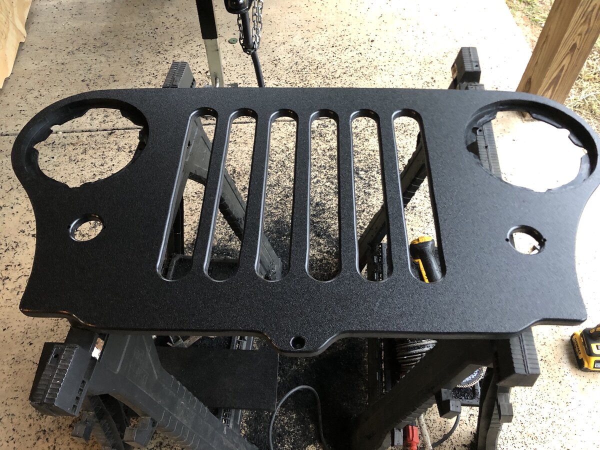

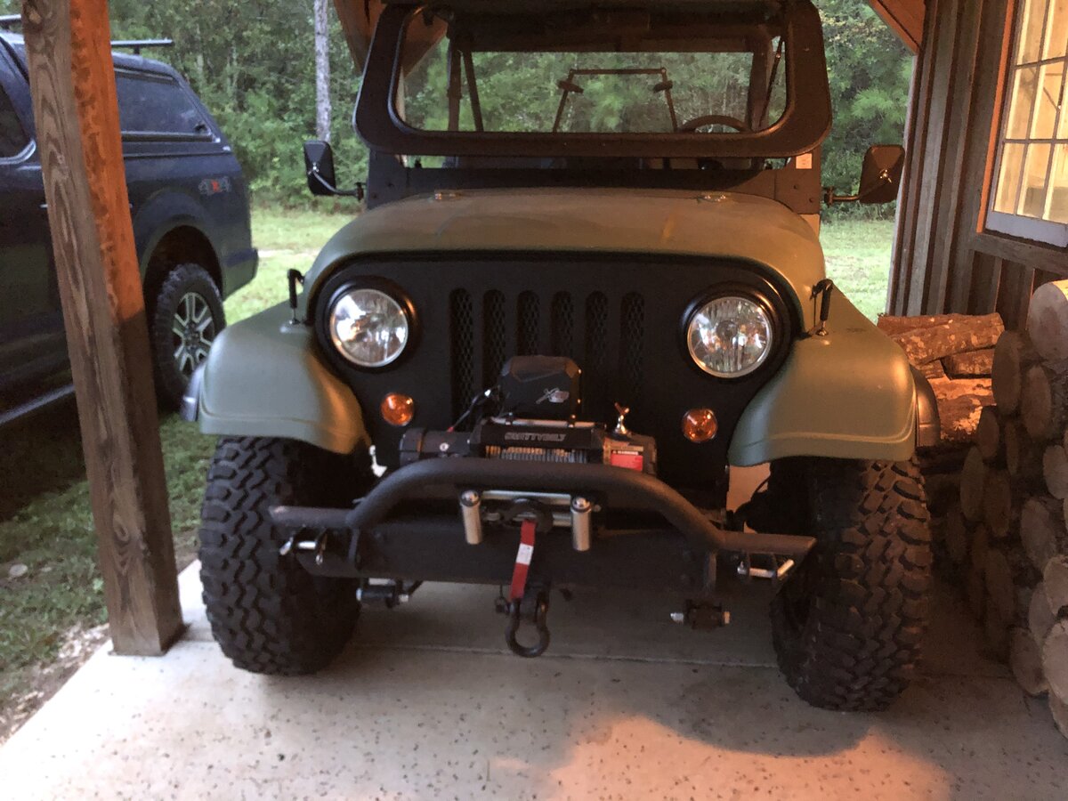

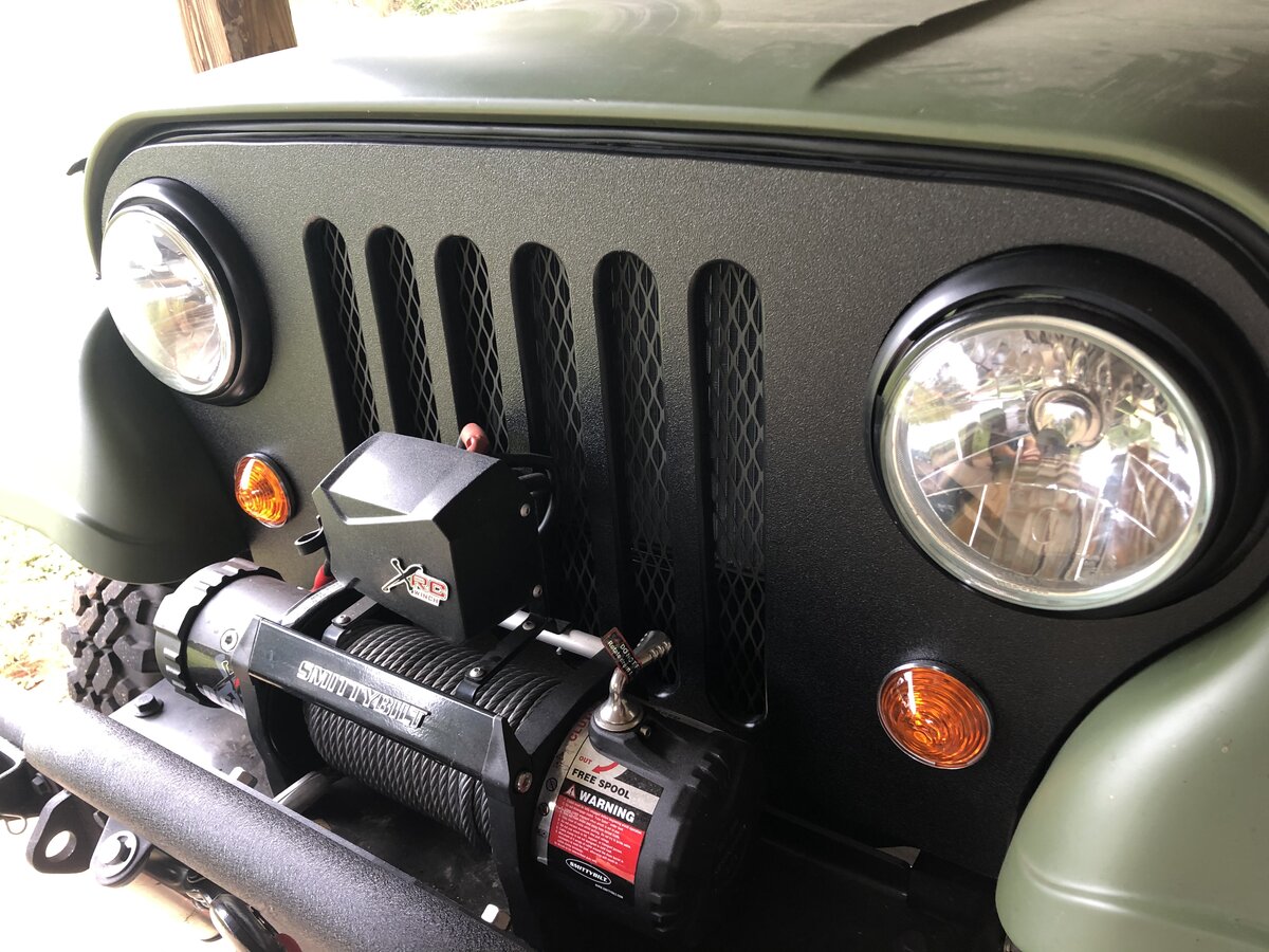

So I had a little time and rainy weather and decided to build my own custom grille out of HDPE (high density poly ethylene). I know there are a lot of options out there for replacement grilles, but I don’t get the same satisfaction buying something as I do building it. Basically all i used was a jigsaw, hole saw and a router.

Very impressEd by the head light detail. How did you do that?
maybe my next project.

Wow that turned out great! I like how you were able to use the router on the edges of the slots to mimic the original grills look! Want to make another one?

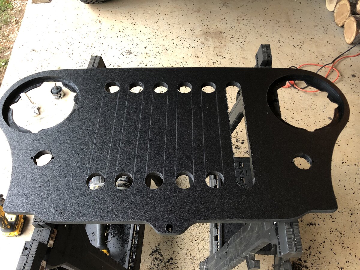

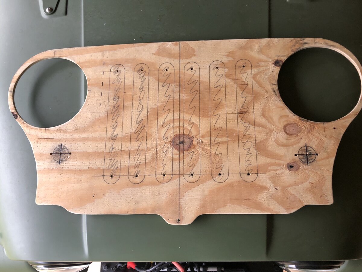

I’ll post a few more pictures later today but I made a plywood template, clamped it to the HDPE and then use a bushing and a straight bit on my router as a guide then adjusted the depth. As far as all the detail around the headlight bolts etc, I just traced around the old grille and cut it out with jig saw before hitting it with the router and bushing to recess it. The only reason I did it that way was so I could use the headlights to fasten the grille. You could just cut it out big enough to go around the headlights, bolt the headlights directly to the metal frame and fasten the grille with screws.

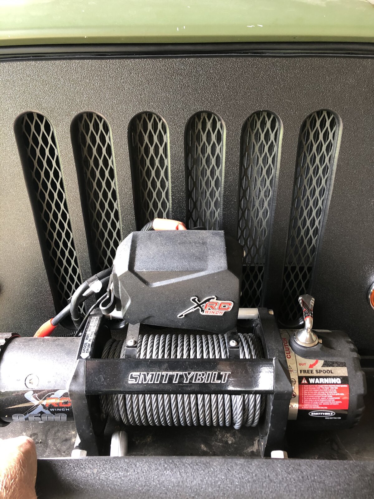

I have to agree that using a thicker material makes for a more authentic look with the rounded slots. The texture on the material looks similar to a rhino lining and never has to be painted.. should be more durable. I put some expanded metal behind the slots on mine to catch some of the bigger bugs.

Looks great, any reason you decided to go with 6 slots?
Thank you sir. 6 was always my number in high school sports and I already have a green 6 pool ball shifter. So I figured I’d stick with the theme and try not to offend any more Jeep folks than I already have.
