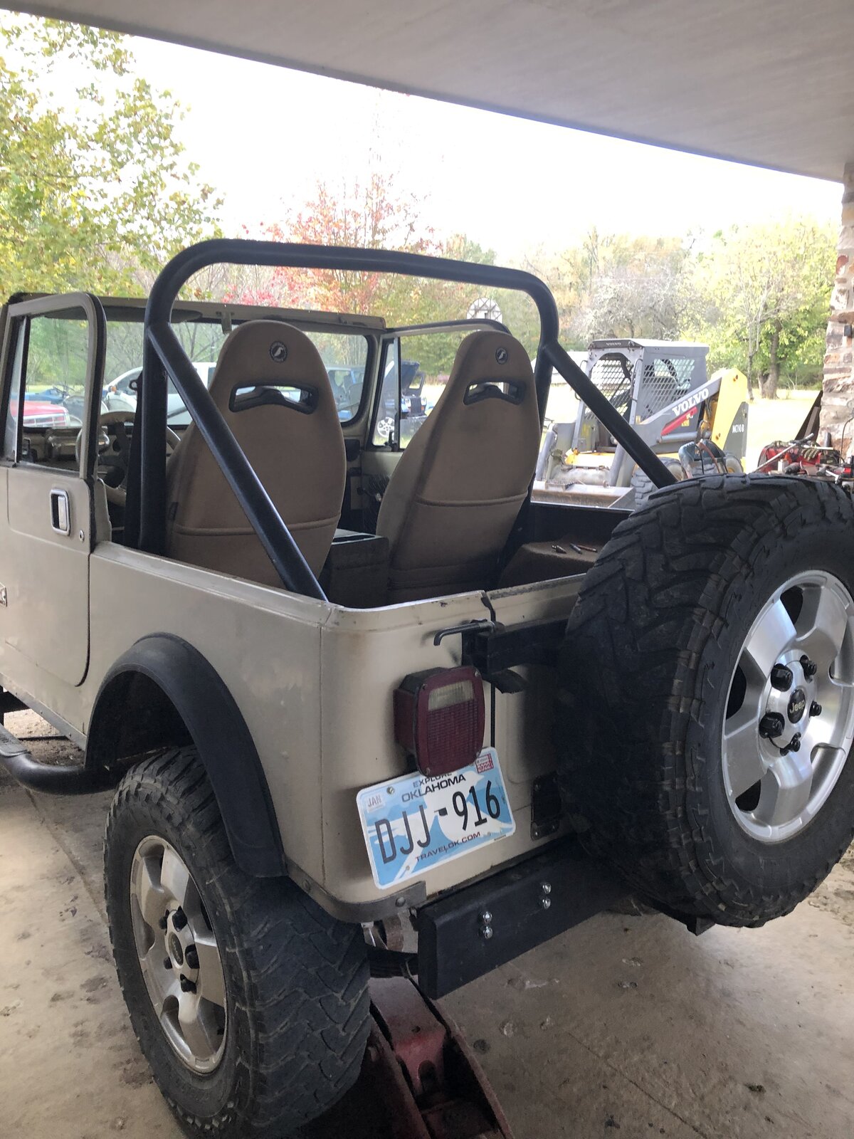

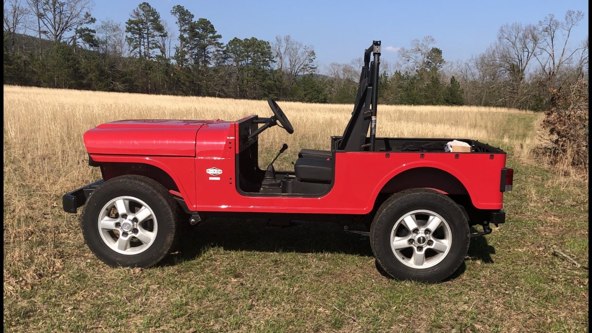

So, newer 5-lug Toyota wheels will work on our Roxors?????
Yes. With spacers that go from 5x5 1/2 to 5x 150. You need the spacers to change lug pattern and the spacer (1 1/2”) takes up some of the back-set the Toyota wheels have. Also dodge Durango wheels are the same. I put Durango wheels on my cj7

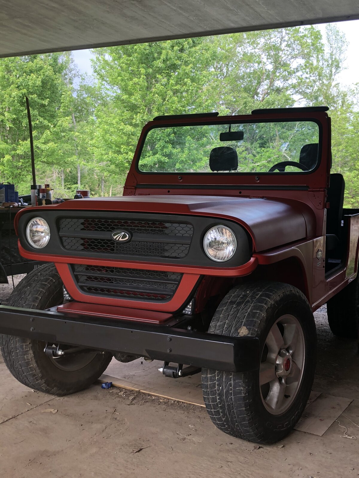

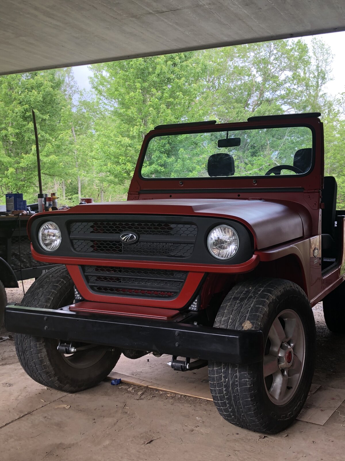

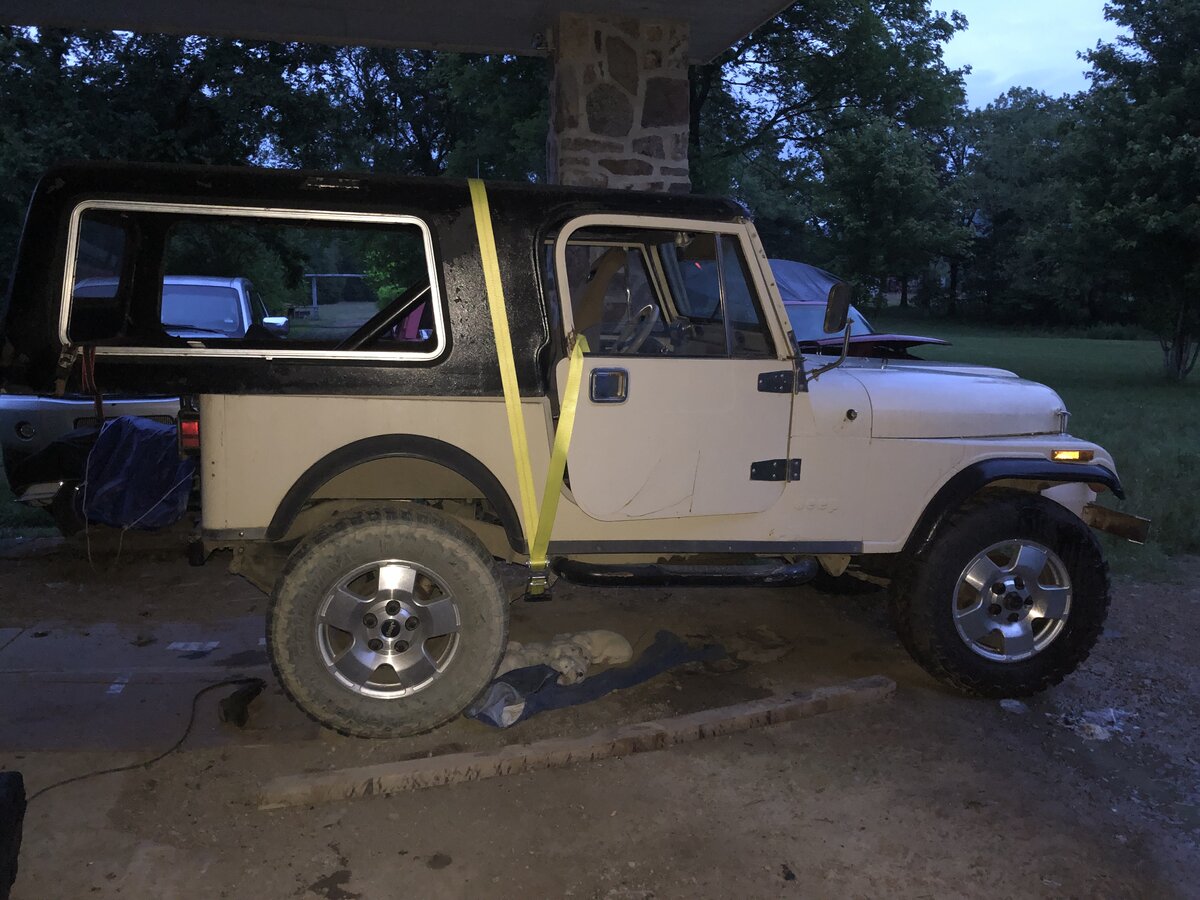

I’ve had that cj8/scrambler top for a while and was going to transform my cj7 to cj8. Then along came roxor and I thought why not do it on brand new roxor… so here we go

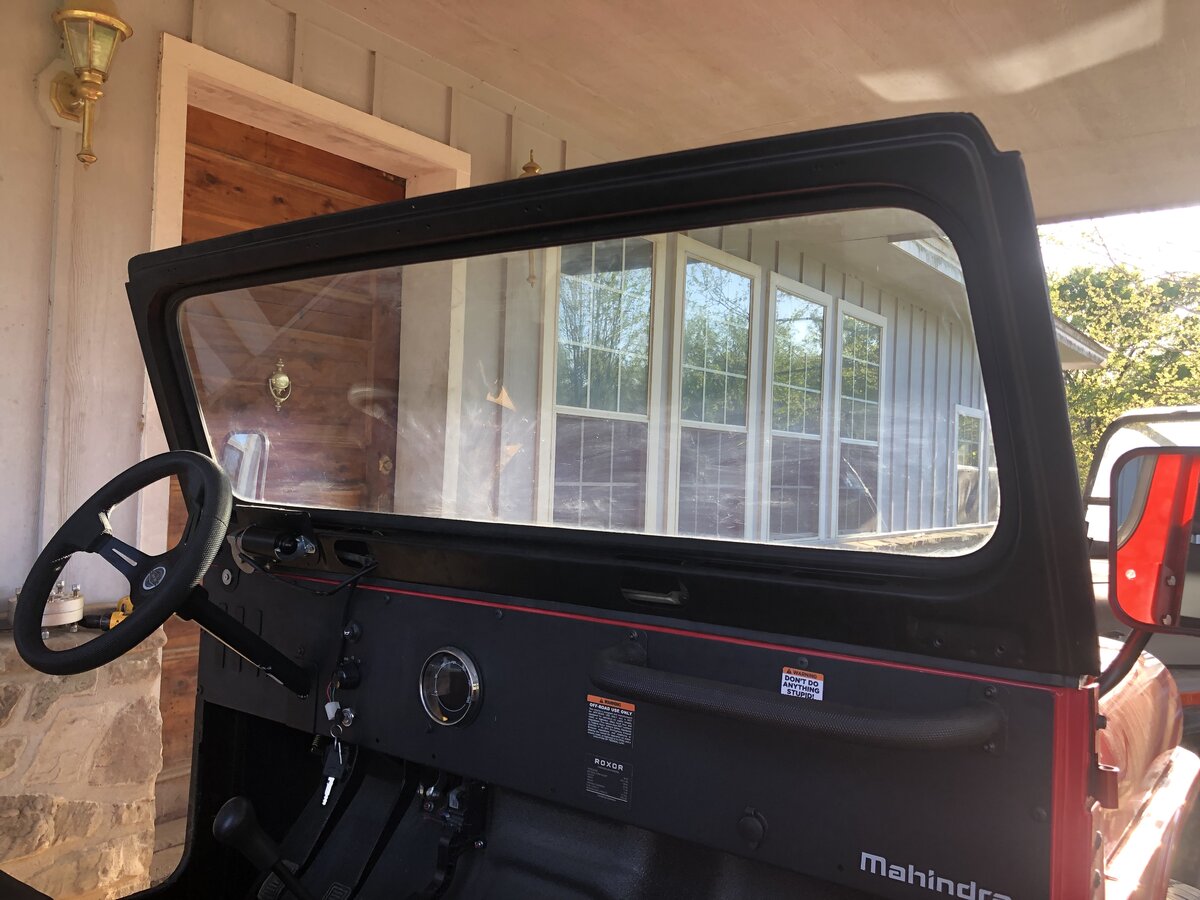

Cj7 windshields not only fit but you get wipers and windshield defrost vents already built in the frame. Plus cj7 doors will mate with the windshield frame all the way to the bottom of the door. That’s where you begin to graft the cj7 door frame profile going across the bottom of the door and up around the back of the door to the flat part the top sets on.
809
I have a cj windshield as well. The CJ mirrors also almost fit perfectly. Will be fabbing doors later. Looks good

I’m fixing to hang the doors. The bottom hinges will have to drill 2 new holes. The roxor hinge holes don’t line up for the cj doors.
809

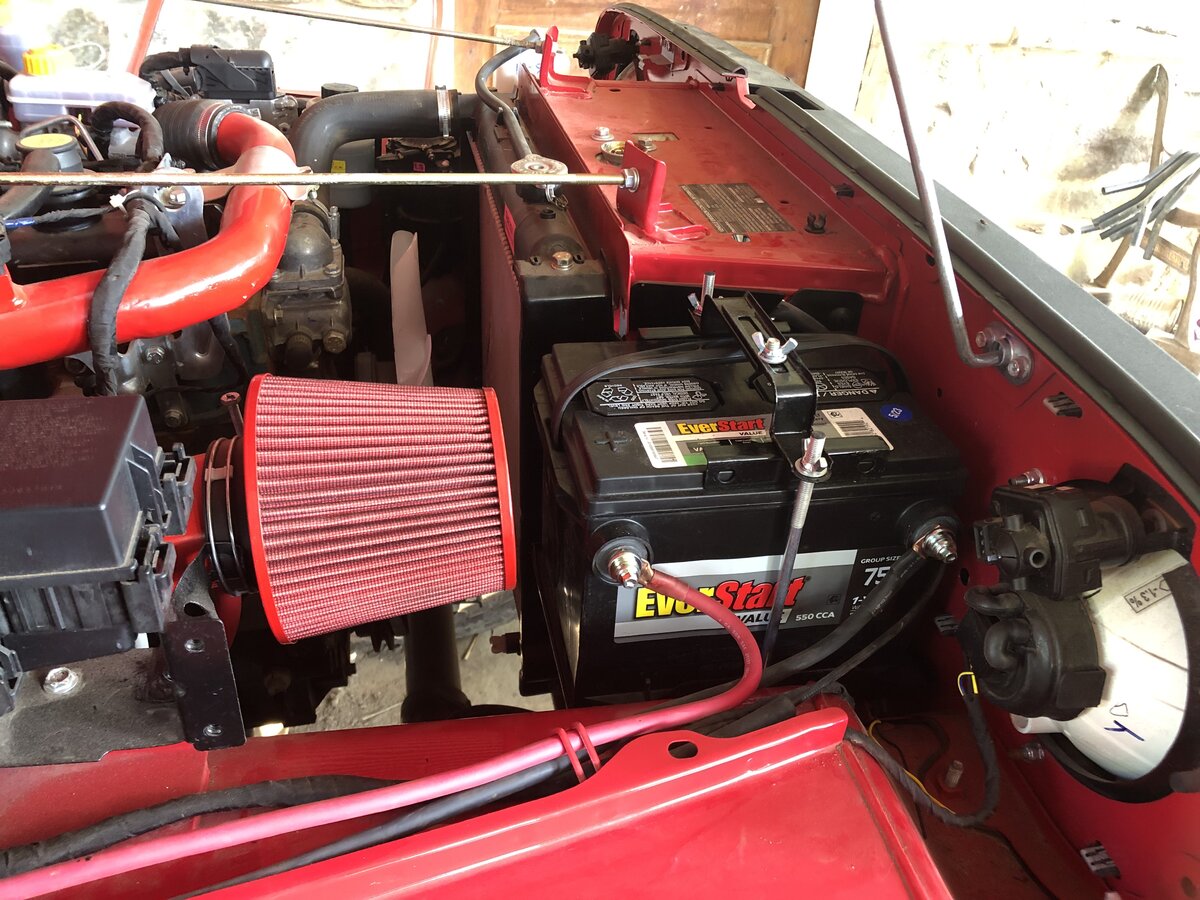

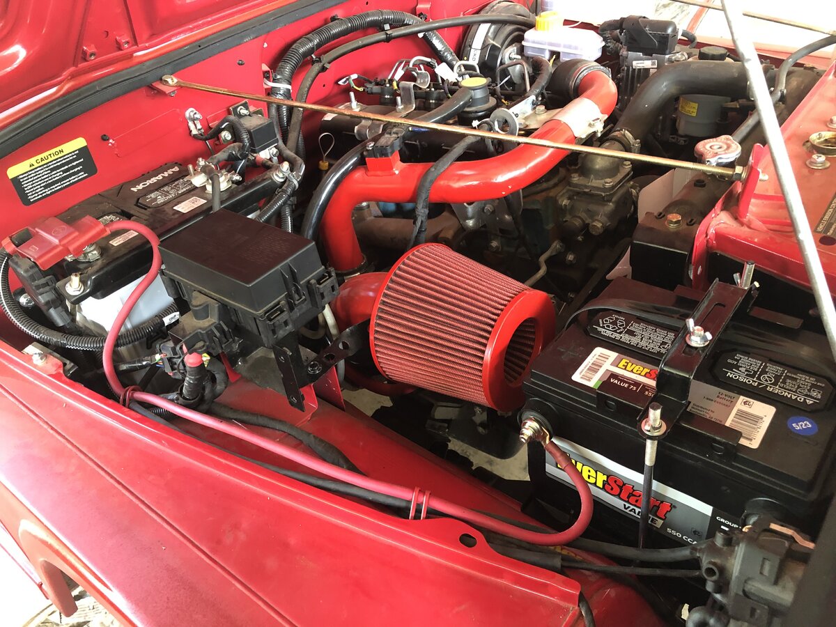

Now get rid of that pipe and get the free flowing intake pipe.
809
That's one way to do it. Did you also get the intake hold down bracket or the DF new intake connection kit? Gut or replace your Cat Converter?
My son got the DF intake connection kit & we put it on his Sunday. Mine is new 2 weeks old, just getting started. I’m going to take all that factory exhaust out and go back with 2 1/2” straight pipes. No muffler

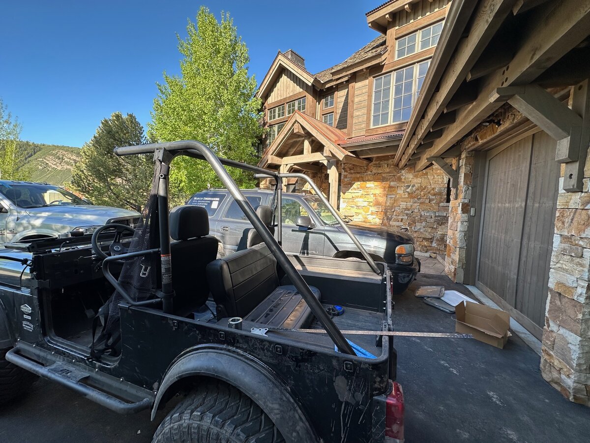

C3185 prefab bars fit almost perfect to the factory hoop if you have a CJ windshield
