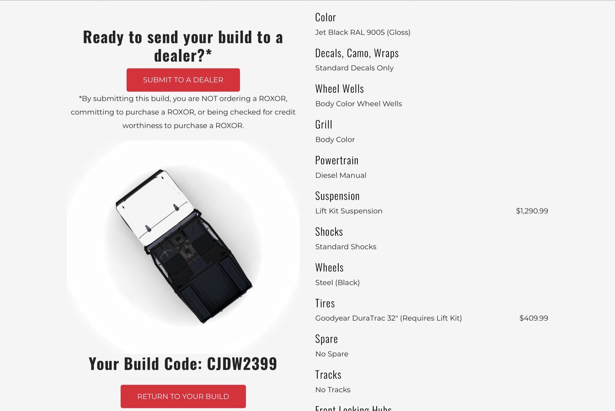

Is this a factory sold option? And is it cheaper than the 2.5 inch leveling kit out there now??
1,287
1600 doesn’t include labor. Tires are extra.
1,287
From the Roxor configurator Priced as factory install. Cheaper than doing after the build But still not cheap.
1,287
Definitely not a good option for doing it afterwards. There really isn't an affordable option on the market unfortunately.
