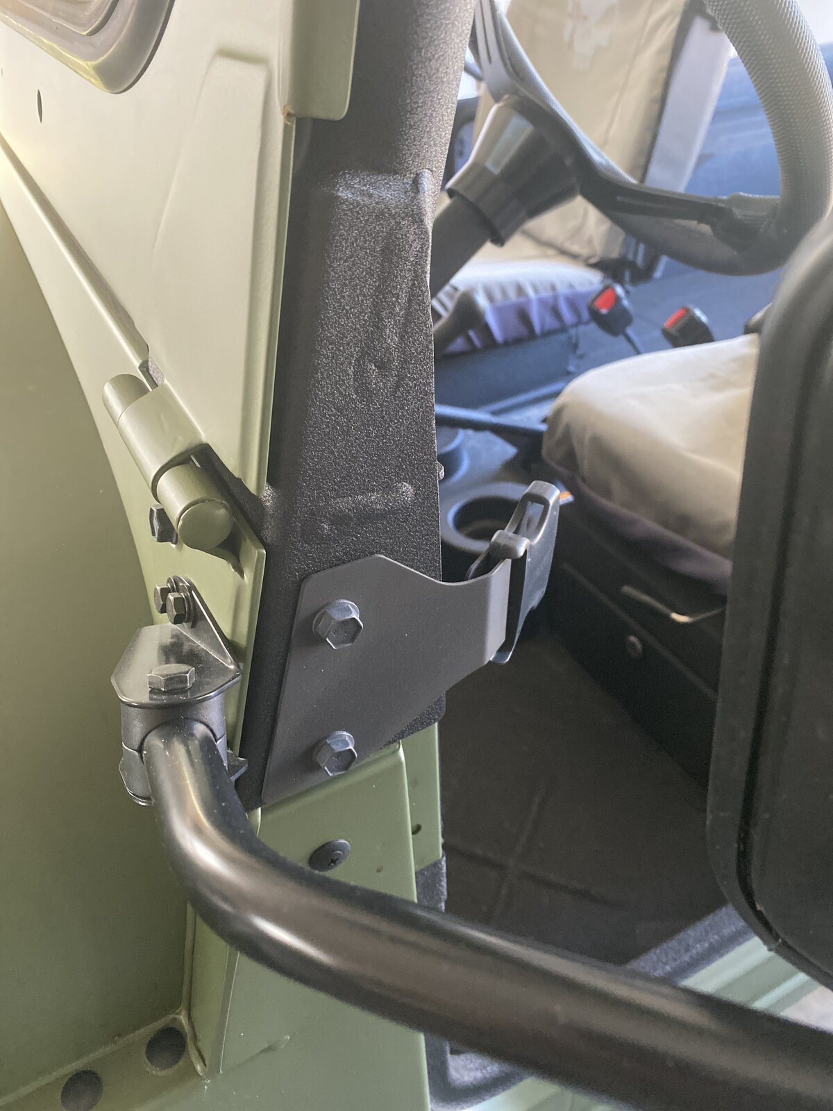

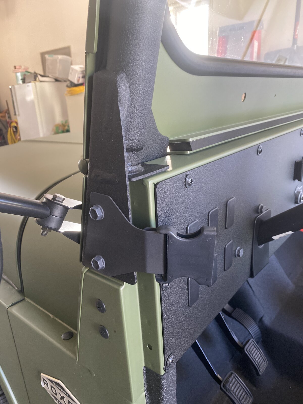

I’m hunting for an antenna mount that would bolt on to the low part of the ROPS, where that fastex buckle is

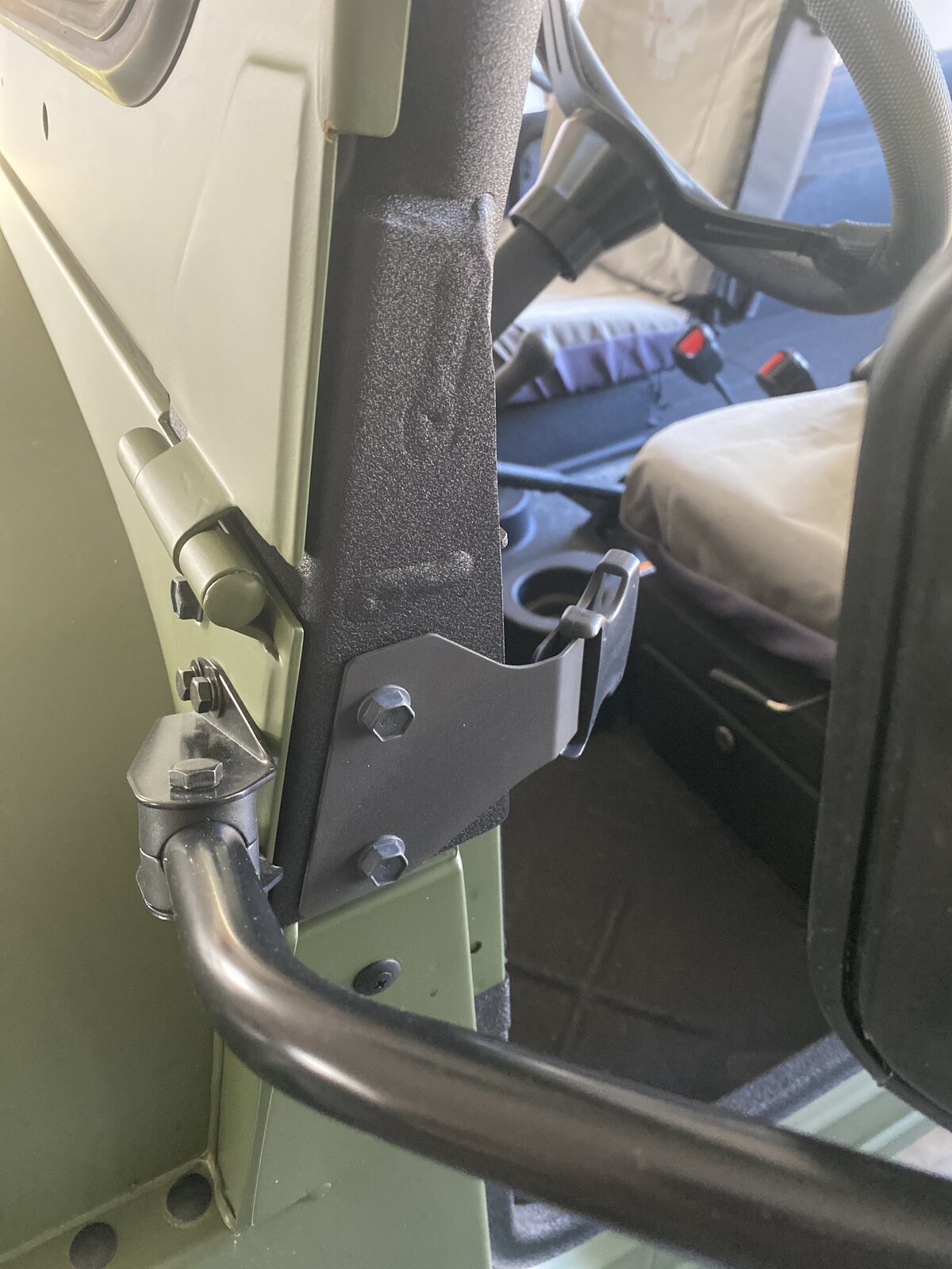

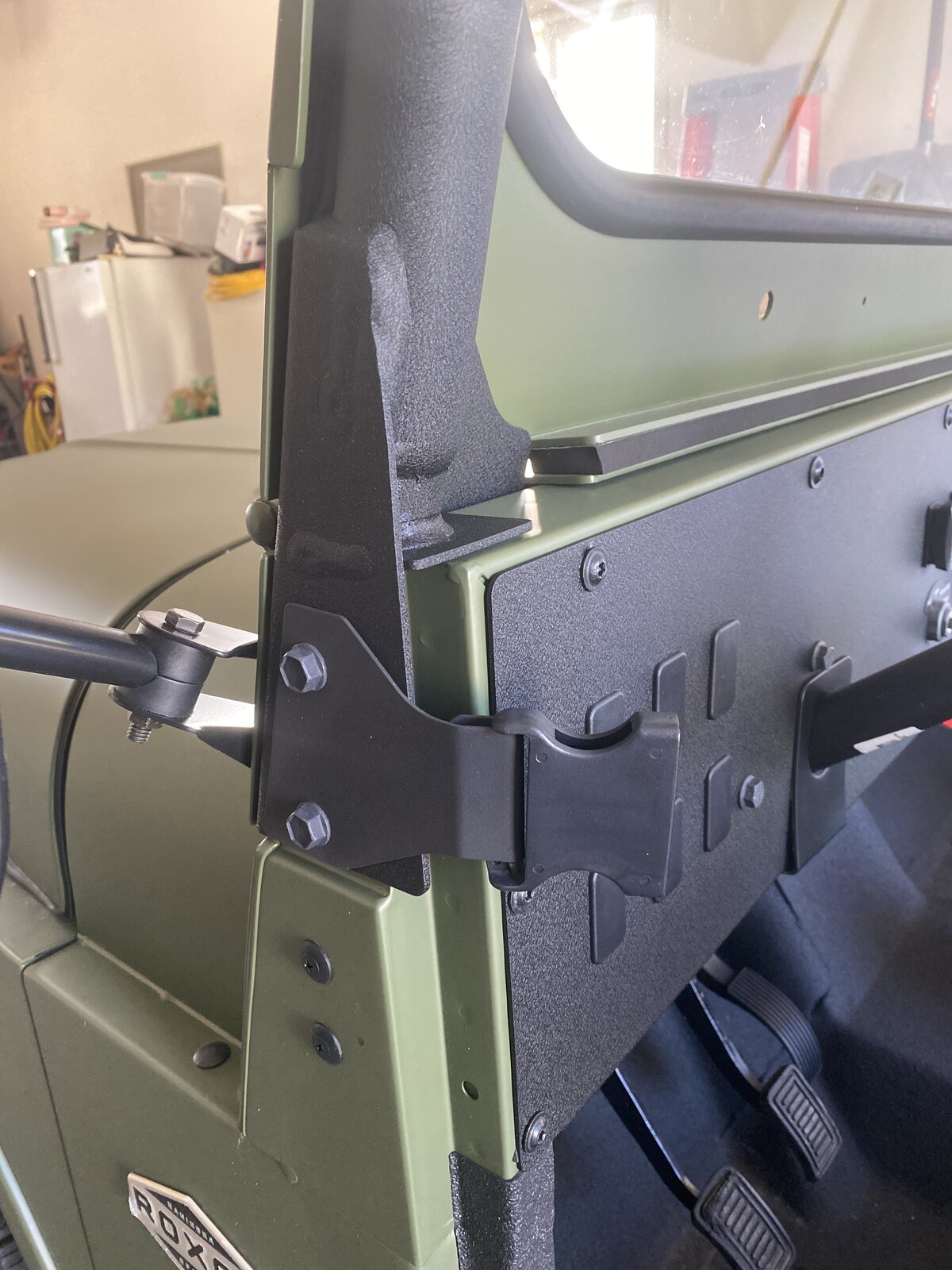

View attachment 6807 View attachment 6808
You might could fabricate a mount with some aluminium angle and put a NMO antenna mount thru that. Not sure how the roll bar would affect the antenna though as it would be right beside it. Not as likely to get knocked off there as opposed to up high on the top roll bar, if your trails are in wooded areas. I live in wooded east texas, an antenna on top of the ROPS wouldn't last long around here. Seems like that area where the buckle bolts are, would be a good location as far as protection is concerned.
