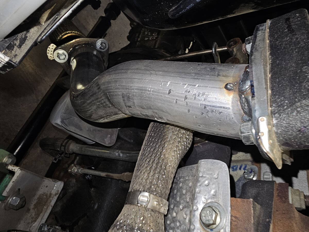

Did a cat delete for 2.7, running thru factory pipe, gives it abit more sound but not loud by any means, cost.....$120. At a muffler shop.

So any practical issues from cat back vs turbo back? Any sensor issues? Is the cat delete noticeably smokier or more smelly? I have to admit, the Rox has noticeably less diesel stank than our Yanmar powered Gator. I’m really just hoping to get rid of some of that cricket chirp, I’m tired of my neighbor saying my diesel sounds cute.
Their are no sensors ( at least on the 2.7) very little if any fumes, no smoke. I think the 2.7 is tuned to be quite clean even without a cat.
