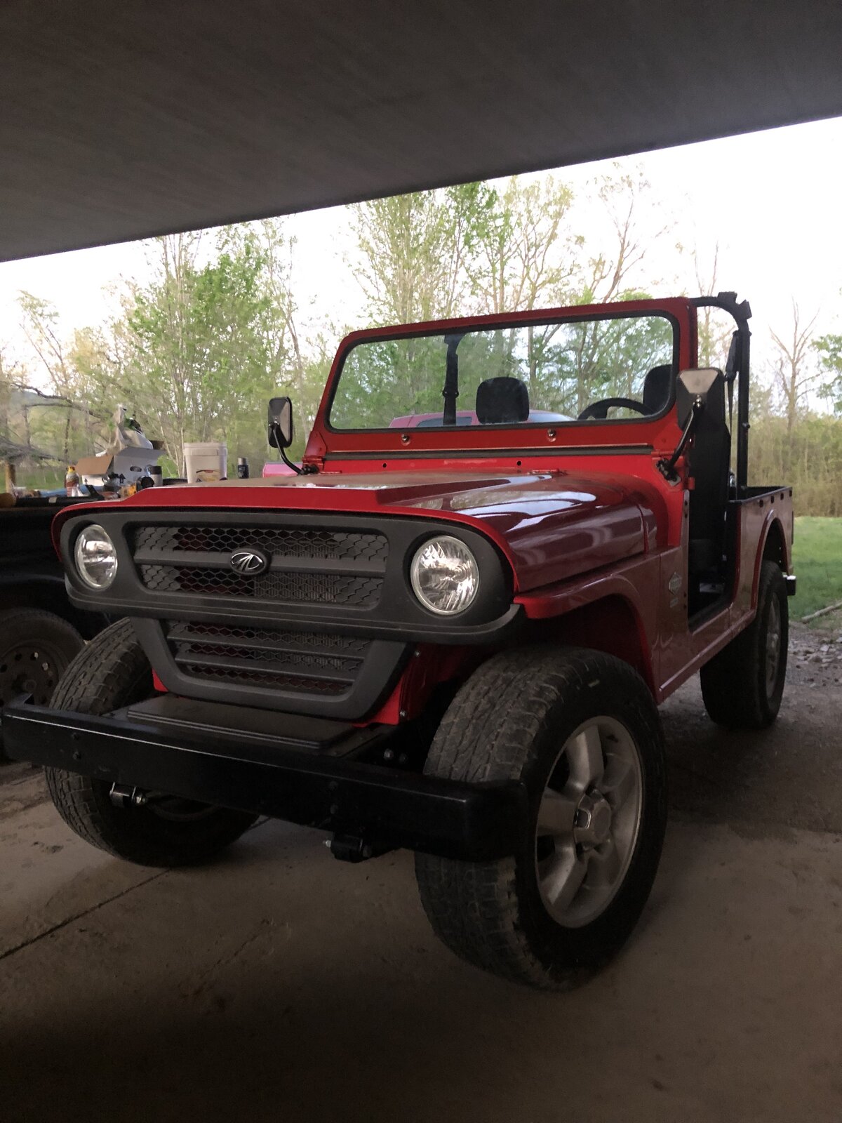

Has anyone found a good source for 17" wheels for our Roxors? The 16's seem a little limiting.

Those are notable options, but I was hoping to find just simple bolt-on options. It seems like the biggest obstacle is finding wheels with large enough center bore to fit over the front hubs. It seems the bolt pattern is 5x5.5 with about a 3.75"-4" backspacing, but the center bore needs to be 108mm? or larger. I haven't found easily accessible wheels that fit the bill.

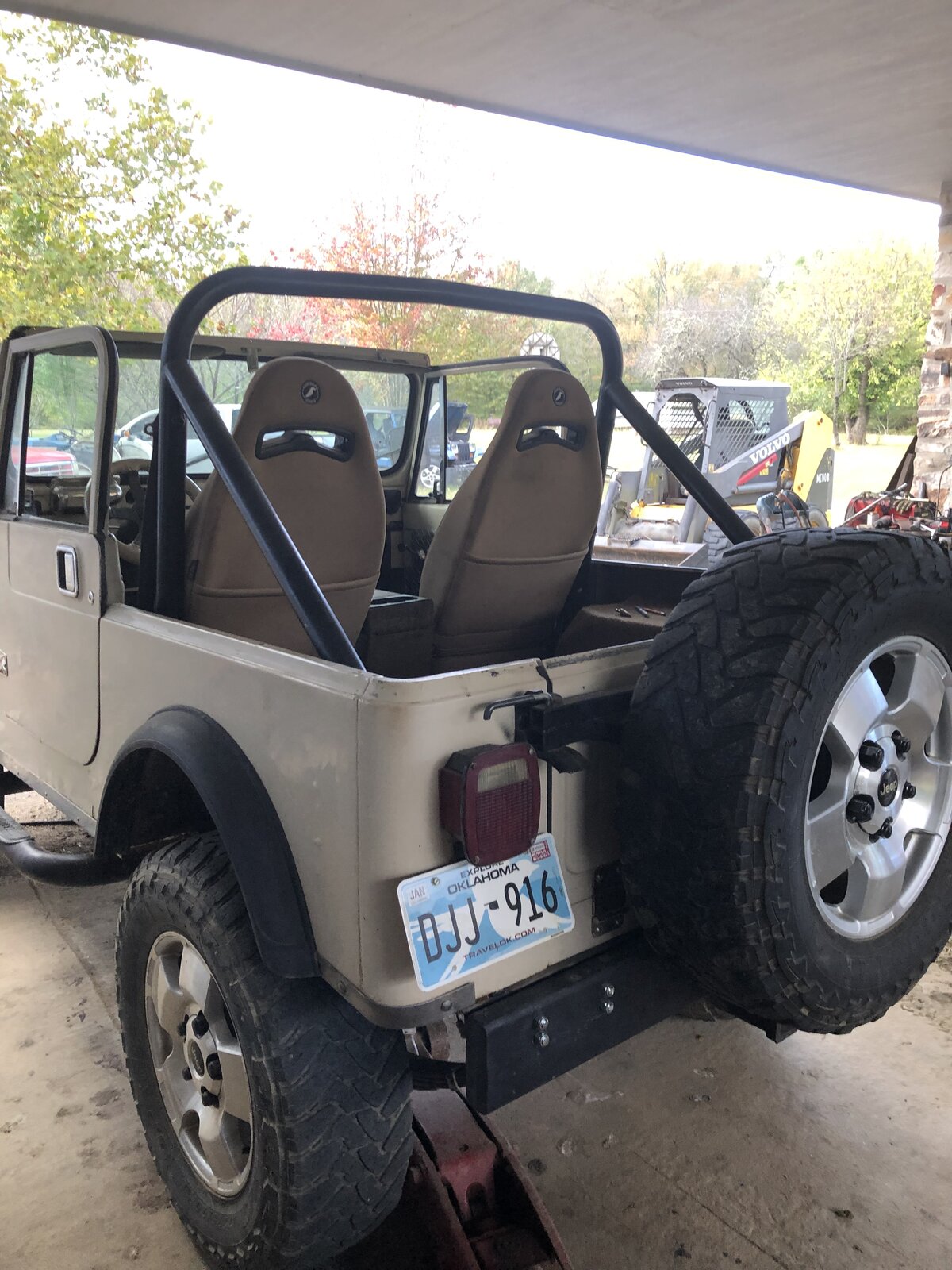

The reason why I went bigger is because the center hole is big enough for hubs. 5x150 is a bigger pattern than 5x5.5(5x139.7). You can’t go the other way. The adapters allow use of these larger modern factory wheels for a fraction of cost of 5x5.5 aftermarket wheels in 17,18,20”.

I see what you're saying. I was just hoping there might be some used factory 17's that would work without adapters. Looks like I'll be doing the same thing you did. Thanks.
