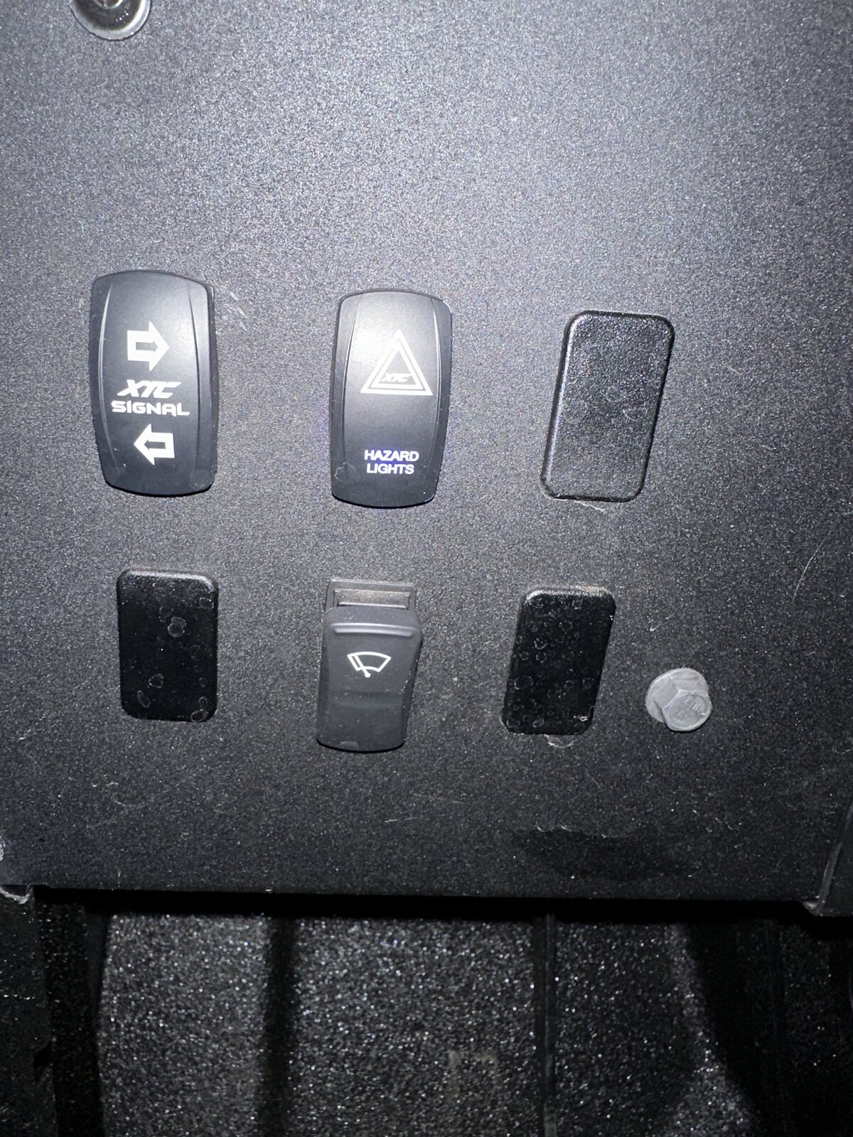

I have a Single Drivers Side Windshield Wiper that I have not hooked up on my 2024 HD Base Model.
I have looked at a 2024 All Weather, and the Wiper Switch is the Bottom Center Switch Location. On the Base it looks to have the Wiring Plug for the Wipers attached to the back of the Blank Cover. Has anyone installed a Wiper Rocker Switch in this location, and utilized the factory Plug and Wiring?

I looked over an All Weather. The Switch looked to be a simple Off/On Switch.
Does anyone have a new All Weather to verify that the Wipers are One Speed?
Anyone wired the wipers using the factory Wiring on a 2023/2024 machine?

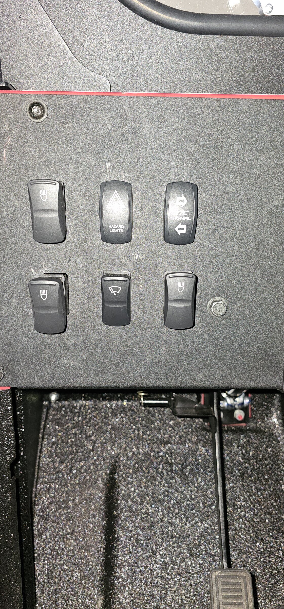

That harness you are talking about had the plug for the washer pump zip tied to it on mine. Mine was also labeled 3 speed heater fan. The two other wired blanks control the power for the sound bar and light bar harness. I just had to extend the harness from the factory plug under the right side of the dash.
I installed the extra switches from Sherman Tractor. Two of them will control the light bar and a dome light. I used the 12v accessory power for my sound bar. That one harness under the right side of the dash has 12v hot, 12v key on, 12v from each of the two wired blanks. Just need to add the switch.

This is where you should find the harness for the light bar/ sound bar. 6 wires, one hot, one ignition power, one 12v from the light bar switch and one from the sound bar switch. I used the 12v ignition power for my sound bar. I will use that switch for my dome light and the other for my light bar, (Still on the to do list). I have not looked for the wiper wash pump wiring under the hood yet, ( also on the to do list).
