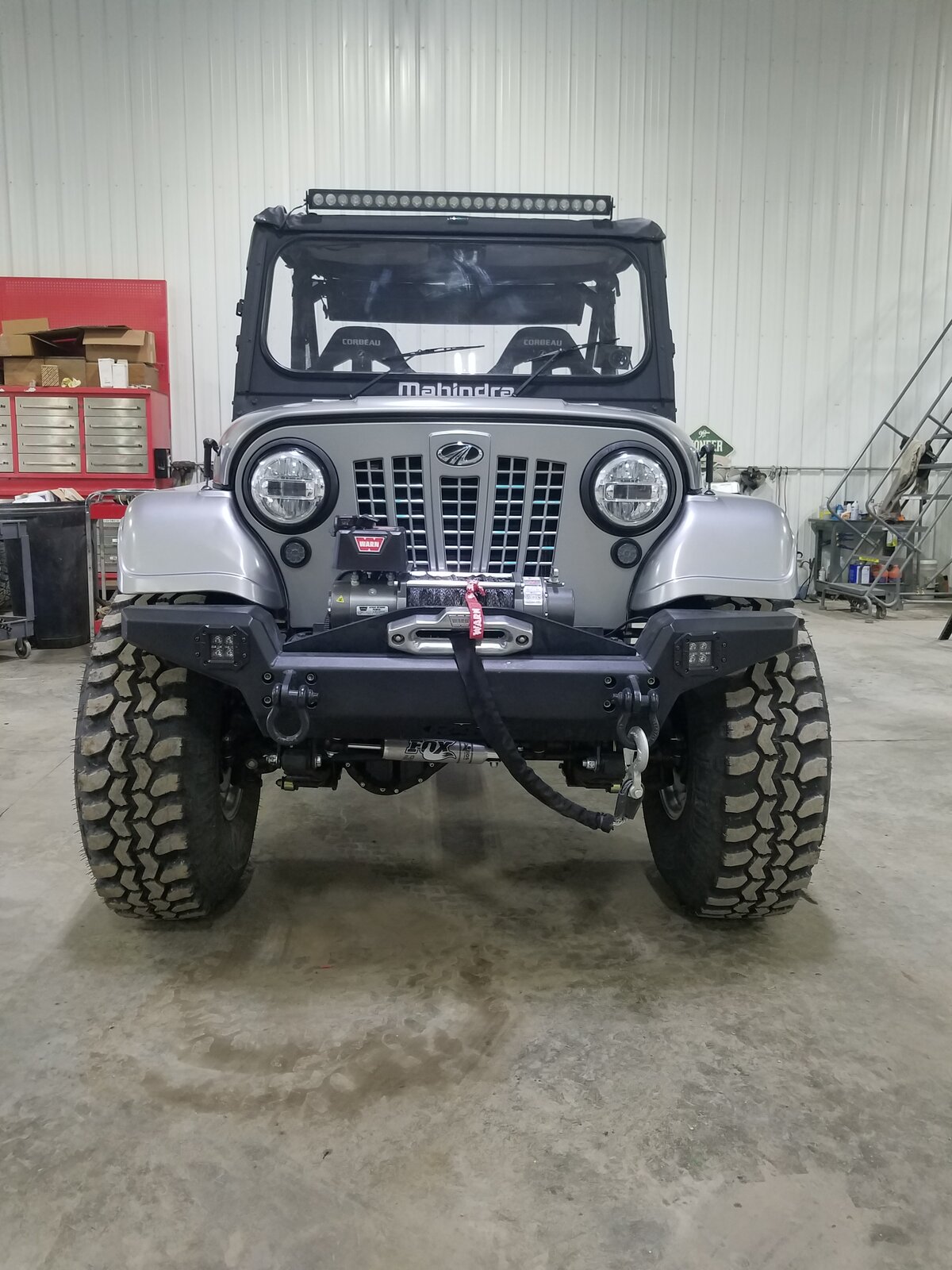

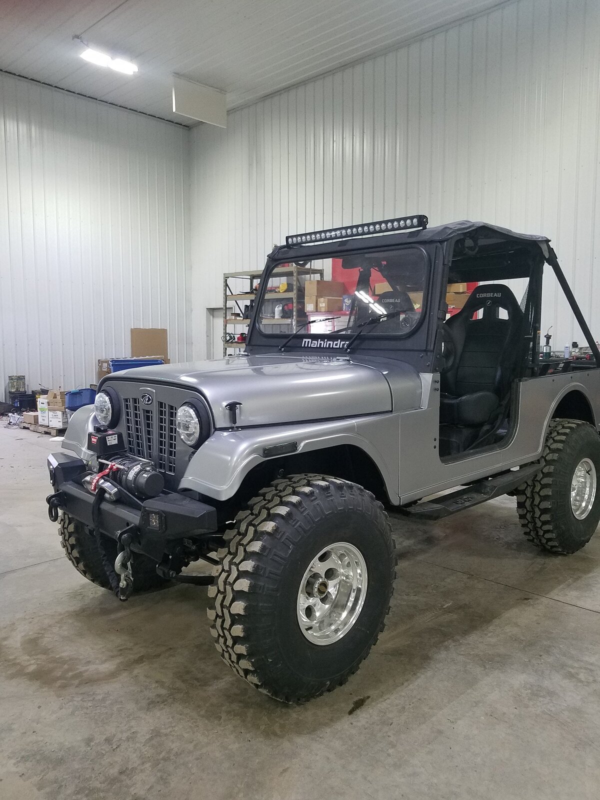

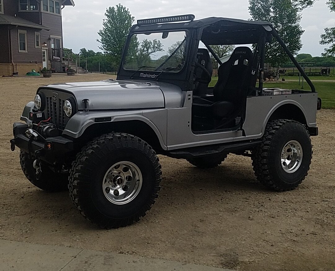

do you remember what shocks you used with the 5" lift? I ordered the lift springs to get the 5" lift now I need to get shocks for when the springs get here.
Thanks , Hogzz
i used bilstein shocks that came with lift kit (3 inch) and added shackles to gain the other 2, with the 36 inch tires , the ride is much better than stock , I also installed a dropped pitman arm and Fox dampener The shocks are available from Roxor or some of the aftermarket vendors
i'm almost done , waiting on my wheels, can you help me find the drop pitman arm and dampner ?
like the grand kids rides also.
sorry been awhile, have to farm now and then, I used a drop pitman arm for a cj5, have to do a little die grinding to remove index splines. The dampner is also for a cj 5 Rancho for pitman, Shock surplus for dampener . they also sell the Bilsteins for 320 to 360 depending on lift. Cj5 again for model Hope this helps
thanks for the reply, the cj5 is what i was looking for. waiting on the wheels to be made ,for real Had to make them!!, Roxor going to match my truck .
thanks for your time, no farming down here in the sand dunes in Panama city Fl. Lol
